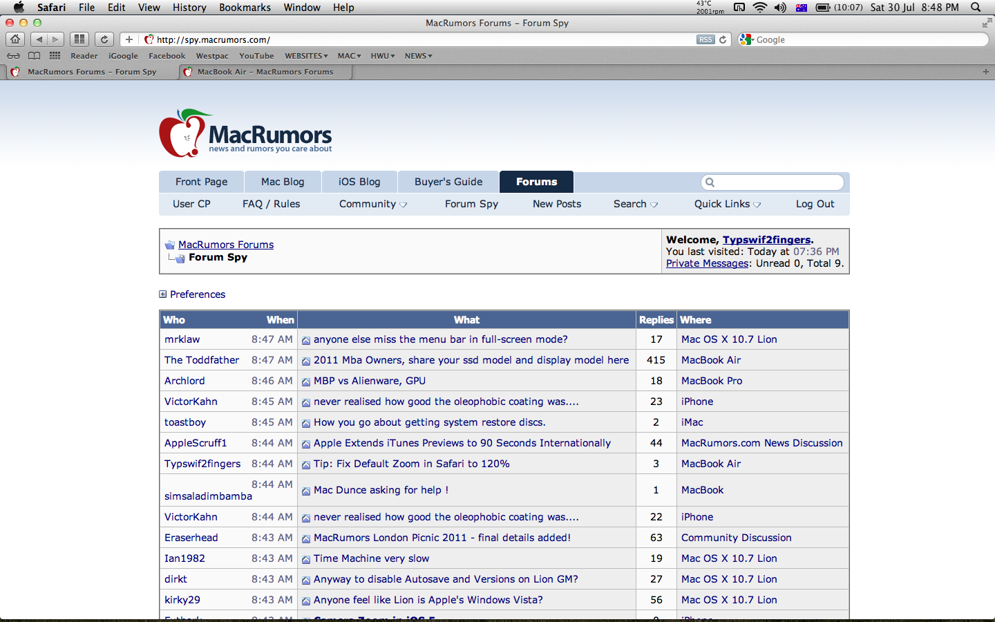

I just noticed my battery clock.. Obviously not gonna last... but interesting never the less.. 🙂
EDIT: Also.. where did my Omni bar go in that picture? 🙂 Weird... Its on... right now...
