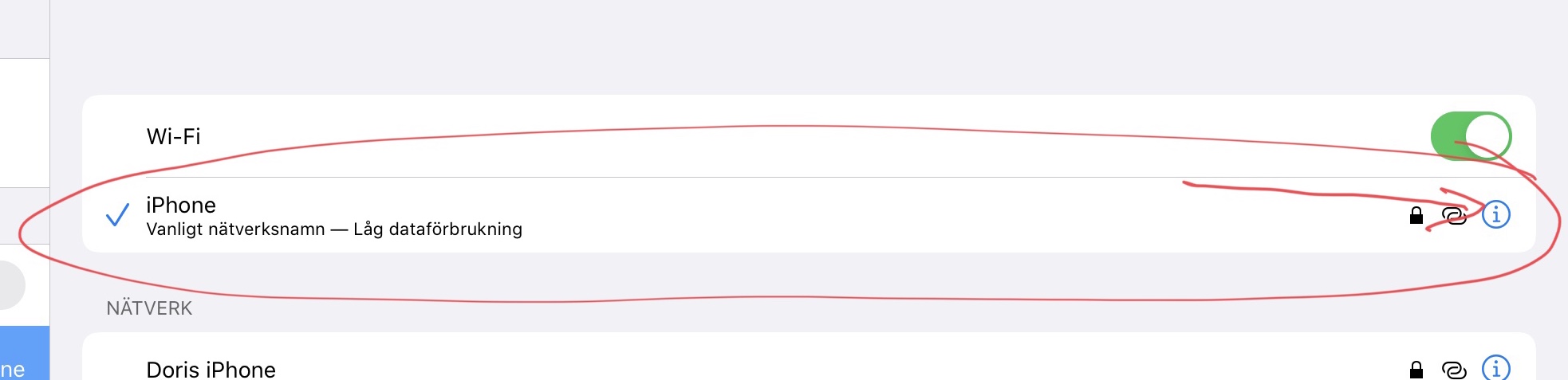

I have unlimited data on my phone so I'm using it for all my internet needs. Share to my iPad is a problem because it always switch to low data mode. Even if I switch it of as soon as I leave the settings app everything is back to low data mode. Streaming movies takes a long time and in low resolution. Someone know how to keep the low data mode switched off? Thanks

The pictures is from the ipad

Low data mode is automatically switched on when an iOS is joining a personal hotspot broadcast by another iOS device. This is to prevent the initial inrush of data when you first connect and your device starts downloading updates, email, messages, etc etc.
