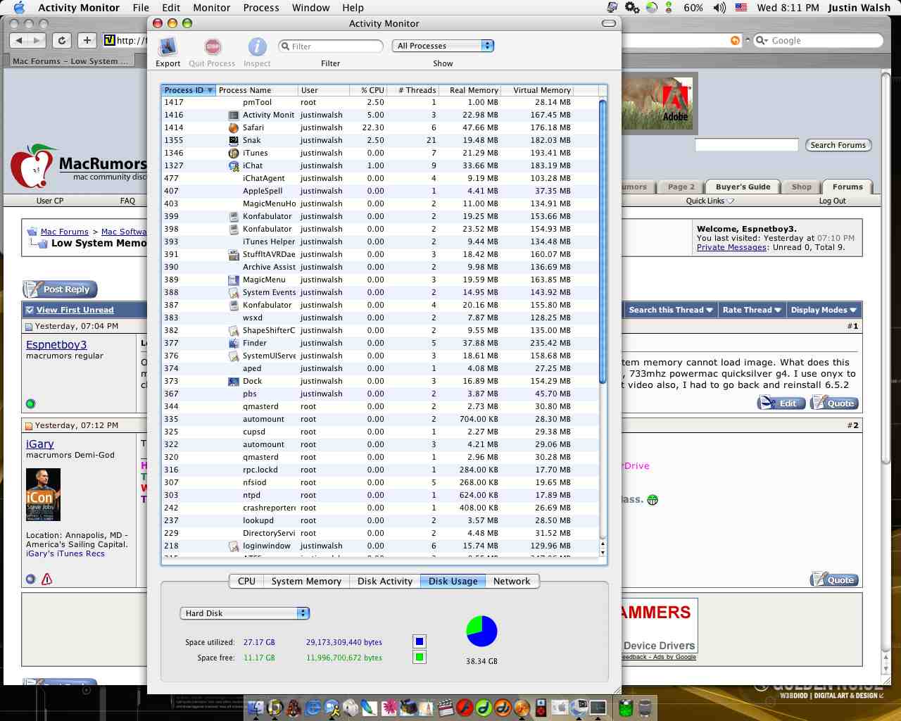

For instance it seems everything I have been doing lately my computer is working twice as hard. Like when I took a screen shot it spiked my cpu usage to 100 percent for a few seconds.

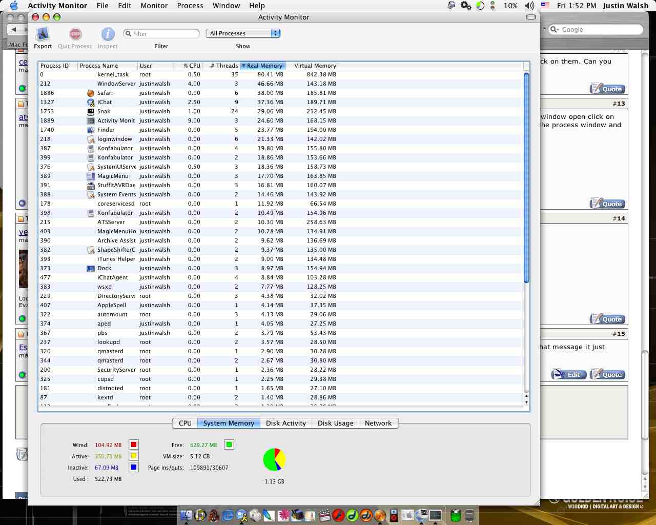

The window needs to show "System Memory" on the bottom instead of "Disk Usage". Disk usage is the space left on the hard drive. System memory is the RAM usage for your system.
Even though I wholeheartedly agree with the above advice to ditch Konfabulator, I still think that there's a discrepancy. He says in the beginning that he has a gig of RAM and I don't see any processes, even the Konfabulator widgets together, taking up that much. I guess we have to wait and see the screenshot of the memory panel first, though.

Well I don't see a lot of processes either, but the VM swapping could be effed up, which is why we need to see the right panel. Perhaps he's fixed it.
well im only running the weather and an internet thing through konfab. Here is the new screenshot.

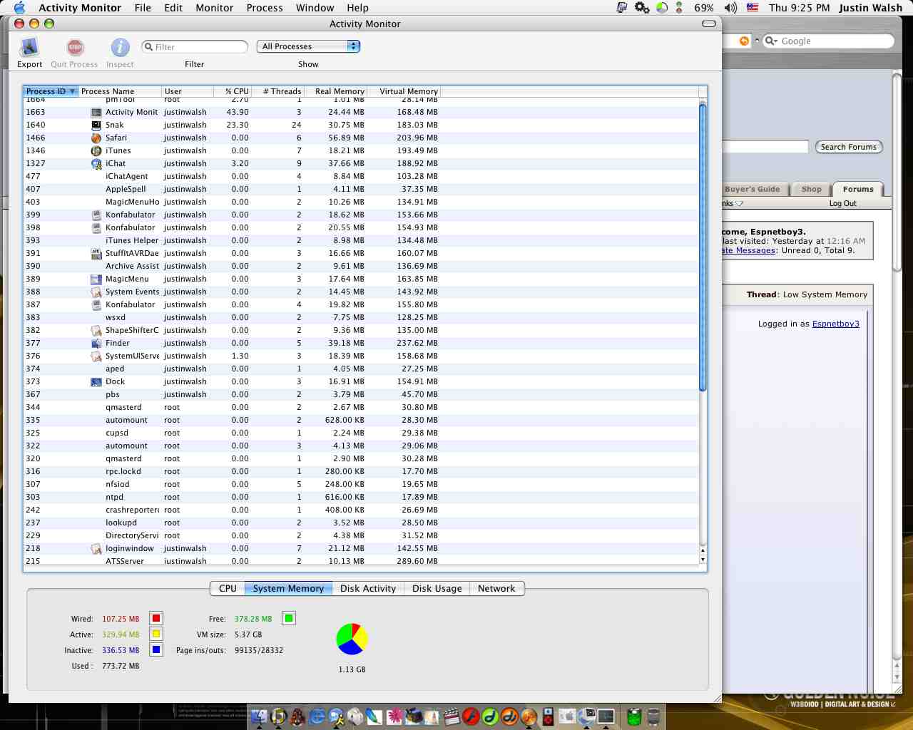

You're probably getting tired of screenshots but try this, it may give us more information. When you have the activity monitor window open click on the Real Memory heading in the process window until you have an arrow pointing down next to it. Then scroll up to the top of the process window and take your screen shot. This will show you/us the biggest memory users and hopefully lead us to the culprit.
