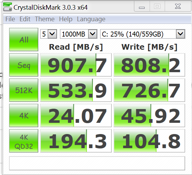

This is the benchmark test I ran on my 1 TB PCIe SSD. What does everyone think?
4k rates and Access times are very poor. Try the tweak I've mentioned in the link above and rerun the benchmark. Do not forget to switch to the High Perfomance mode before.
Generic AHCI driver - yes, all latest Macs with Bootcamp use them. But the thing is not in bootcamp itself. The thing is in the ssd form-factor - it is no longer a SATA device, but a PCI-express now. There is no need for a specific driver for PCI-e devices in Windows.

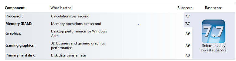

There's definitely something wrong there. As a point of reference, here is my Windows Experience Index with my Late 2013 iMac (also Haswell), using not the internal PCIe SSD but rather a Samsung 840 EVO in a Delock Thunderbolt enclosure.

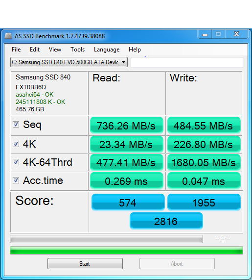

And here are my results with the AS SSD Benchmark

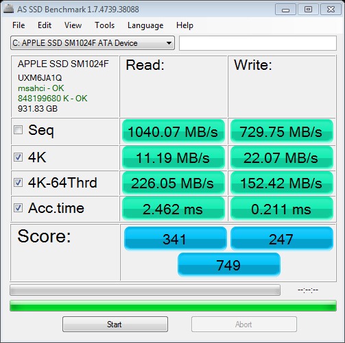

Thank you lipid for the thorough research you did. I have the same issue of a windows experience index of only 5,9 for the disk subsystem with a mid 2014 rmbp and a 1TB SSD. However i run windows 7 ulitmate from bootcamp and the processor states can not be set as in windows 8.1 (or can it?)
Any idea of what i can do, otherwise i'll need to return the system. My colleague has a 2013 rMBP and with a 512 SSD and he doesn't have the issue.
Any advice will be greatly appreciated!
