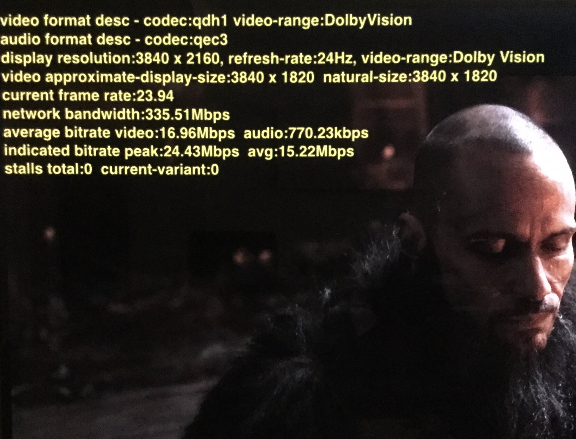

Can you test See on Apple TV +? Pre-Covid, it was 29 Mbps, with a peak of 41 Mbps. 😳
See attached picture for See's bitrates taken today at 16:30.
Reactions: EugW
I wonder if the higher bitrates reported by MacRumors is comparable, or if they're outliers, cuz they reported bitrates almost twice what you got.
I really couldn't say.
I know that bitrates for movies off iTunes are consistently lower than rates for the same movie using the Movies Anywhere app at the moment.
Perhaps Apple has temporarily throttled rates.
