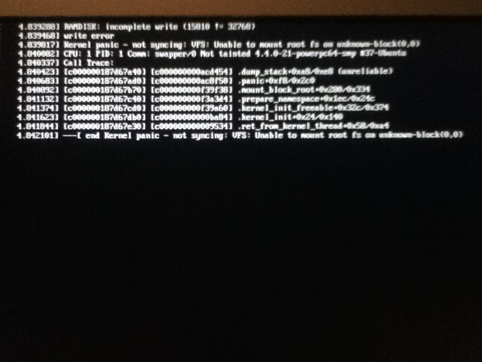

So I put my Live CD in, type "live-powerpc64" when at the Yaboot screen (I'm doing this on a G5), fire up GParted, and set 2 MB assigned to the bootstrap partition (hfs, sda2), 927 GB to the main os partition (ext4, sda3), and 4608 MB/4.50 GB to the swap partition (swap, sda4), because I have 4.5 GB of RAM.
Then, I get into the installer. And then when it comes to the point where it gives you the option between an automatic format and a manual format, I choose the "Something Else" option (manual formatting). I format the bootstrap partition to NewWorld Boot, put the main partition into Ext4 Journaling, and the swap space to linux-swap, and hit "Install". There are a couple internal errors during the installation (one of them had something to do with WebKit), but it mostly goes well. It finishes, ejects the disc, reboots, and comes into Yaboot.
I press "l" to choose GNU/Linux, press enter at the next prompt, have that grey screen for a second where it confirms the display is working OK (which it passed), then I get this.
I apologize for the low quality, all I had was an iPod touch 4.
Could someone please help me with this issue? I was really looking forward to having Lubuntu drive my G5.

I tried the automatic format option, too. It got me to the exact same place.
Now that I review it, from what I can understand from the picture above, it's likely to be an issue with mounting the main Ext4 partition.

Yes, I recall this happening with one of my G5s, I can't remember which (maybe a 7,2?). The installer somehow switched between HDD device 1 and 0 in the yaboot config.
Easy fix: if your Linux HDD is in position A (in the tower) move it to position B or vice versa.
The alternative is to edit the yaboot.conf and change the SATA bus OF path from 0 to 1 or vice versa.

Question, where exactly in yaboot.conf is the setting for the SATA OF path? I see a "/ht@0" and a "ffffffffffffffff/@0". Which one of them do I change to 1?
I think the 1st is the bus and the 2nd is the device.
No harm in trying either until it works.
You can always change the startup disk in Mac OS X and then check the output of nvram for the boot-device, this will show you which disk or bus your Mac OS X is on, then go from there

Yaboot.conf must be pointing to the wrong boot volume. You can manually edit the yaboot.conf by mounting the hfs bootstrap partition in OSX. Check the OF paths are correct as per @z970mp's issue.
I changed ht@0 to ht@1, attempted to save and overwrite, and it threw me an error saying "Can't open file to write." I used Leafpad.
