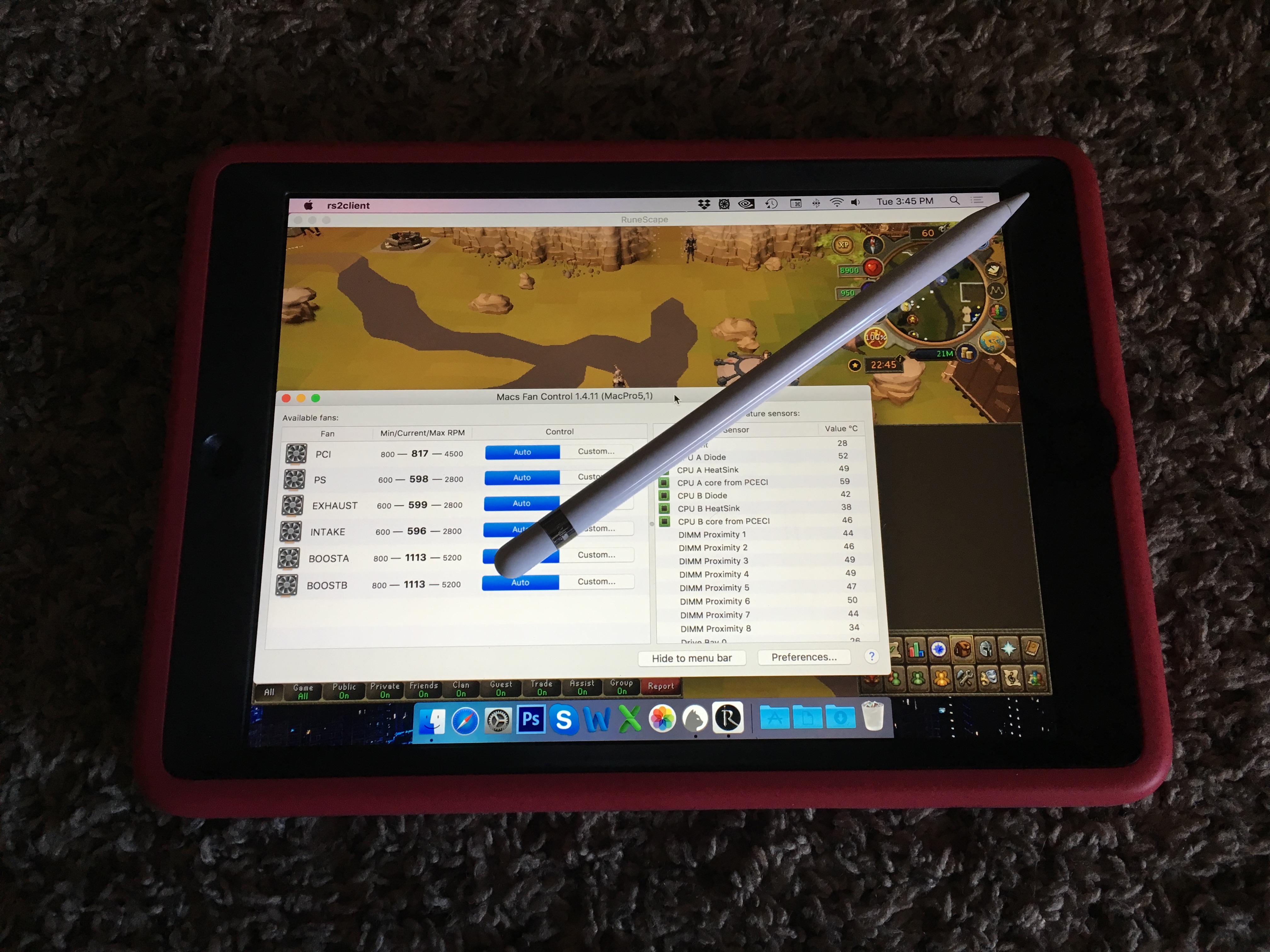

i got it installed today, and so far it appears to be working. theres a little bit of lag, but there's a lot of wi-fi congestion in my area. it would be nice if i could use the iPad keyboard instead of the OS X on-screen keyboard, and i could direct the audio to the iPad, but the luna display works well enough for playing runescape.
[doublepost=1543360190][/doublepost]an issue i have noticed is that the luna display mac app doesn't remember settings, so i have to set it up again and again when i want to use it.
[doublepost=1543360603][/doublepost]i'm not sure if the luna display adapter is causing this, but my mac pro seems sluggish. not lag, but beach balling, bouncing apps, etc.

Despite my complaints about the Luna Display, it still more closely matches my desired usage. If the weird beachballing and delayed app launch on my Mac Pro while using the Luna Display were resolved, it would go a long way toward suiting my needs. As it is, I'd rate the LDA 3/5 stars.

If you refer to upgrading your cMP, I don't think that it would alleviate the beach balling. My specs aren't maxed out, but they're pretty substantial:
2x 2.93 hex core Xeon
4x 8GB ECC RAM
MSI Twin Frozr 2GB GTX680 (mac flashed with the evga bios)
256GB Samsung AHCI M.2 SM951 in slot #2 (16x adaptor)
OSX Sierra
