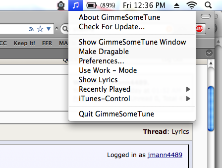

I actually tried the gimme program and it wouldn't work 🙁. I launched it, and I knew it was launched b/c it wouldn't let me delete it (said program was in use), but it did not appear in the dock and the only evidence that it was running was a little info tag that would appear each time a new song started. No way to control anything, no window, and it wouldn't get the lyrics.
Gimme doesn't have an icon in the dock, it puts a little music note in the task bar where you can access preferences etc, that is where you can control if it saves album artwork or lyrics etc. You can also change the position and color of the box that appears when the song changes.
