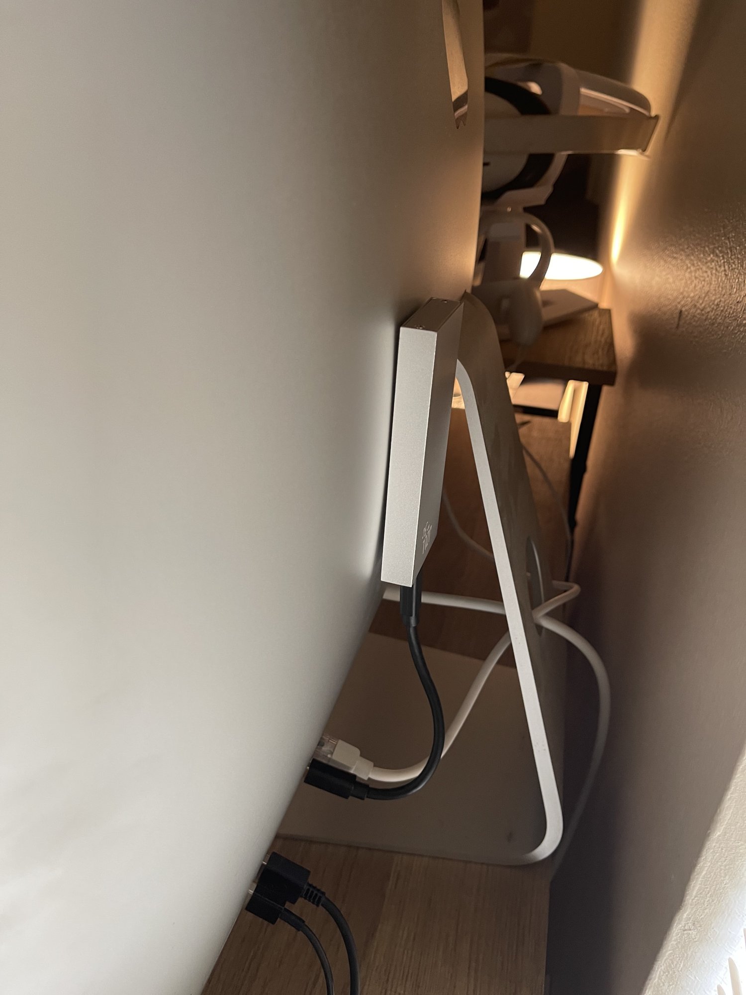

I know this post is old but for anyone viewing. If you want to use a thunderbolt 3/4 nvme m.2 enclosure you will need a thunderbolt 3 dock because the thunderbolt 2 to 3 adapter doesn’t transfer power. So it would go thunderbolt 2 to 3 adapter to dock. Nvme m.2 enclosure connected to the dock other port and then itll work.
Other and best solution is to buy a thunderbolt 1/2 enclosure. This way you won't need a dock. They sell them on eBay. Im using a thunderbolt 1/2 enclosure with a 500GB nvme m.2 that I boot from. My speeds are 830MB/sec read and 690MB/sec write.
