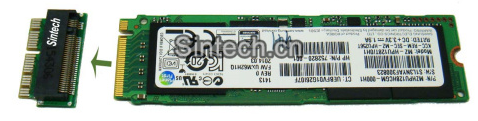

If you don't want to depend on proprietary Apple PCIe SSD's, I met this tiny M.2 SSD adapter: http://eshop.sintech.cn/ngff-m2-pcie-ssd-card-as-2013-2014-2015-macbook-ssd-p-1139.html
Could also be useful in future Mac's. Just buy a Mac with the smallest SSD, and install yourself the M.2 SSD you want.
Note: 1) NVME SSD's will most likely only work with newer NVME compliant Mac's (October 2016). 2) Enabling TRIM for third party SSD's: Terminal, type 'sudo trimforce enable'

Why not? The adapter is of course compatible with MP 6,1. Only restriction is that an AHCI-M.2 SSD is installed. NVME SSD's would not work in MP 6,1.
I came across this same adapter earlier this year as well. Hoped that it could be a more affordable solution to stick flash storage. Unfortunately it did not work in a rMBP (late 2013) I tried. Here's the link to this adapter on Amazon (no longer available) - https://amzn.com/B01CWWAENG

It isn't this same adapter. One you linked is "reverse way" adapter than Synchro3 posted.
As you can see on a pic from your link, the adapter is from Apple to regular NGFF, Synchro's one is from regular NGFF to Apple pinout.
Not sure what you're seeing, but both are the exact same - to convert the physical connection of regular NGFF M.2 to Apple.

However: Since it's evident the format of the new MacBook Pro 2016 with it's NVME-SSD's is not compatible with this adapter, I do not continue this project.
