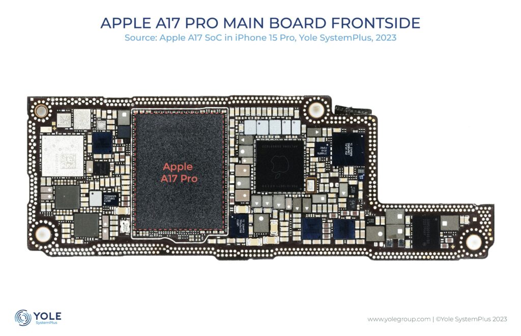

I can see the possibility. M4 works in the thinnest Apple product ever. It should work in an iPhone ultra as well.
M-series SoC packaging is far too big to fit on an iPhone logic board.
Whenever Apple launches their foldable is more realistic.
yes but the logic board is not limited by the thickness but by the area
what if they release a lower bin m4 specifically for the iphone? something with lower clock speed, 2 or 3p and 6e cores, and 8gpu cores.
Binning doesn’t help. There is no room for an M because those packages are about 50% wider and taller. Instead of RAM being underneath the SoC, the RAM is next to the SoC for better cooling and capacity.
You suggest something with fewer cores, lower frequency, and slower RAM. Guess what? That’s an A-series. 😄

M1 = 118 mm sq
A15= 107 mm sq
If they are not putting an m series cpu in an iphone then its still safe to assume a18 pro will feature more cores overall. if they could fit 6e cores in plain m4 it's certainly possible that they will do the same for a18 pro

It’s not the die size that’s the problem. It’s the package.
Again, the DRAM is on the same plane as the SoC for M-series. You need far more pads for 128-bit memory interface. You need a heat spreader. This means the package is far bigger.
