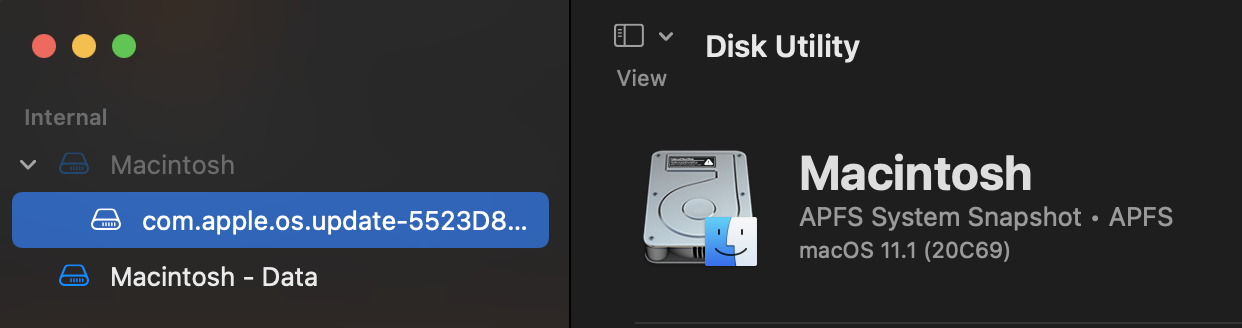

I did a clean install, and everything seems work ok, but is it normal in disk utility? Why don't just showing Macintosh?
Because Big Sur does not boot from the filesystem directly, it creates a snapshot and then boot from that (read only) snapshot, the com.apple.os.update-xxxx is the name of that snapshot. The snapshot process is part of the the new security feature called Signed System Volume introduced in Big Sur. Each time a system update is performed, instead of modifying the filesystem directly, a new snapshot is created and the system will boot from that new snapshot instead.
