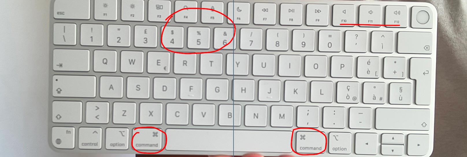

Upon further testing the left side (my right) of the camera is less on focus than the other half, you can see it this photo of my keyboard, especially on the "command" keys and others. It's not a super big deal, still annoying though, but I think I can live with that

Yes I know it looks tilted and I could took a better one, but it's not that. I can easily verify this by putting my two hands in front of the camera, the left one will be in focus, the right one slightly blurry. Or if I lean left my beard is crisp, if I lean right my beard is a bit blurry.
Intuitively I felt there was something wrong but it was only when I visualized something with text that I could clearly recognize where was the problem.
It might be a very minor assembly issue and I'm sure most won't notice. But I'm also a photographer so I might notice this more.

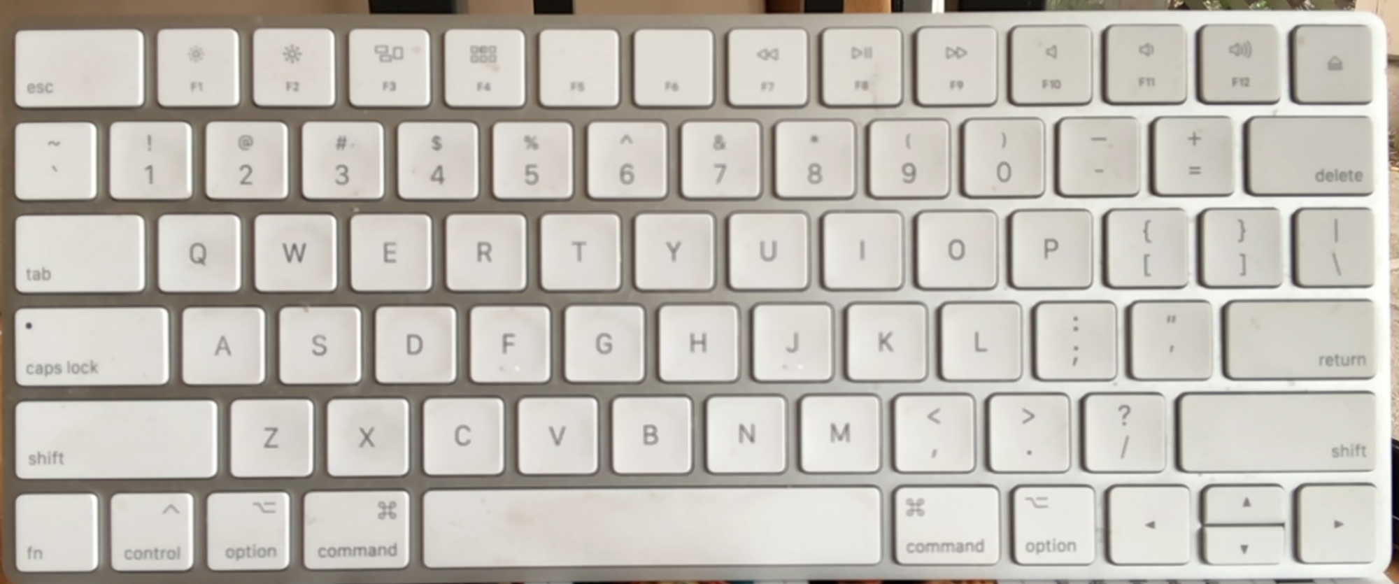

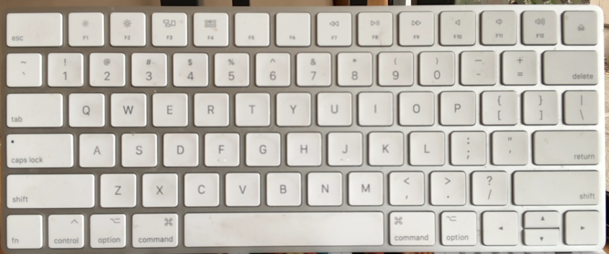

Here is mine from a 2020 iMac camera, for comparison. Taken from a distance (about 10 inches) that almost filled the field of view. I propped it up on something to be sure there was no movement/shake.
It is quite possible your lens/sensor is slightly decentered or tilted. With these tiny sensors the tolerances are very small. I ran into this with a dashcam - returned it for replacement which was much better.

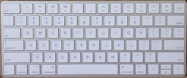

You got me curious, so I also took one using my 2015 MBP webcam, for comparison, this is at about 11" distance:
Although the 2015 MBP has a lower resolution camera, this is actually more in focus (at the center of the frame only) at this close distance than the 2020 iMac camera - confirming what you observed.
They must be “focused” closer as you said, and probably the out of focus center on the iMacs at closer distance is due to a weird combination of factors. Apple should hire me for quality assurance

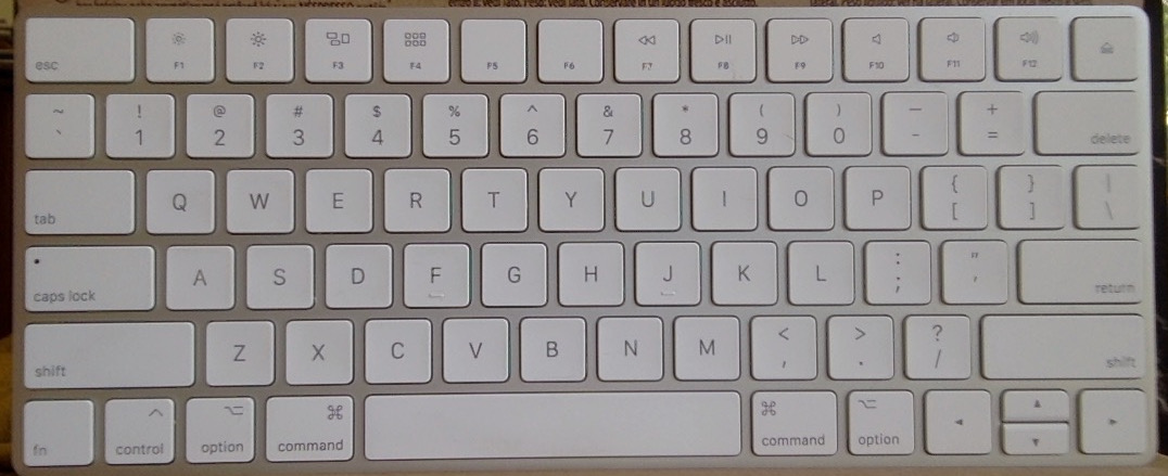

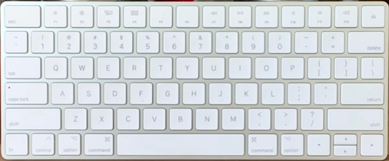

One more comparison, taken from 20 inches away (a more normal viewing distance) and cropped:
The 2020 iMac camera at 20" distance:
The 2015 MBP camera at 20" distance:
Although the 2015 MBP camera is lower resolution, the resulting sharpness is pretty similar. Readability is about the same, I think. These are taken at the center of the frame - the edges may be a different story.
