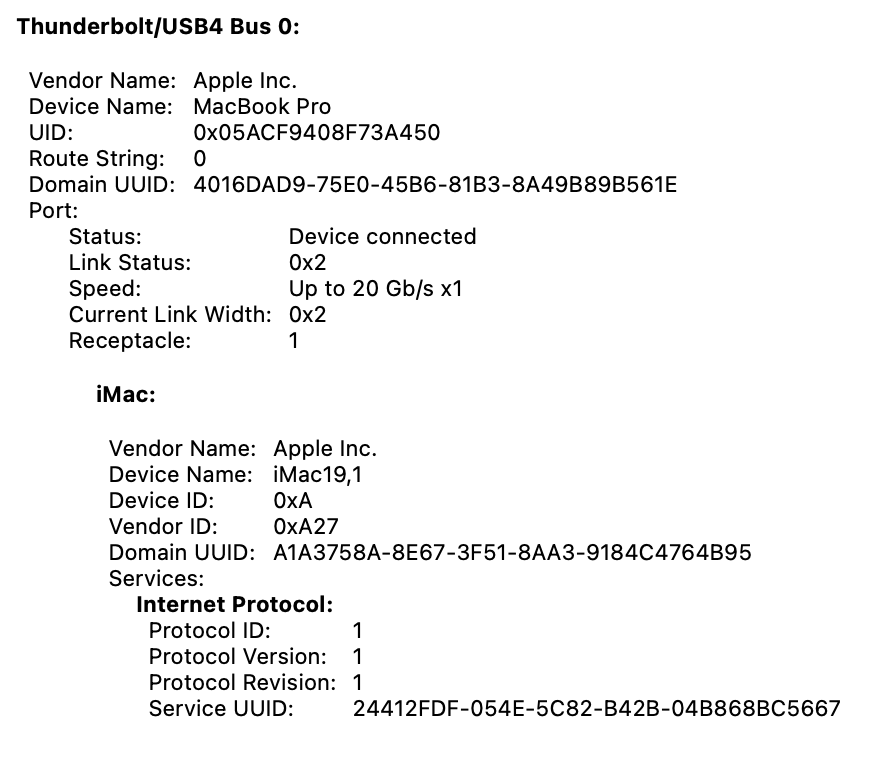

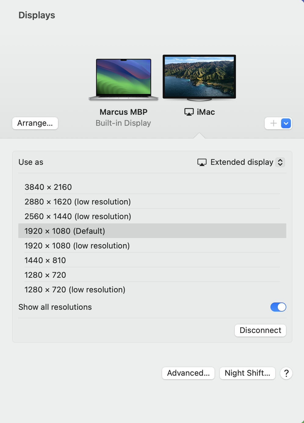

Correct. This is what I can see on my setup.

Very interesting. That isn't a Thunderbolt cable though. It won't necessarily support maximum resolution. I'd be interested to see the results with a Thunderbolt cable.
Airplay simply won't support the full resolution of the iMac's display and Target Display Mode is definitely gone. I'd get a 27" 5k display and use that and it will be less clunky than trying to make this work. Apple's Studio Display will be the best integrated and will have build quality on par with Apple's other products, but you won't have to run a whole second computer to get a partially functional external display.

Lots of people have said that Airplay won't support the full resolution but I haven't once seen it documented. So I'm not yet convinced. Apple Support didn't even know about Airplay Receiver for Mac. I think I need to go into a store and try it.
Unless someone on here can try it with a Thunderbolt cable first...

The screen shot in post 8 shows an iMac that's connected to the MacBook Pro over Thunderbolt. If it were connected via a USB cable it wouldn't show up in the Thunderbolt/USB4 section of the System Information app.
Thunderbolt 3 or 4 is 40 Gbps
Pretty sure that could be USB4 and not Thunderbolt. I'd like to know what happens when TB4 cable is used. I'll visit a store. Thanks
