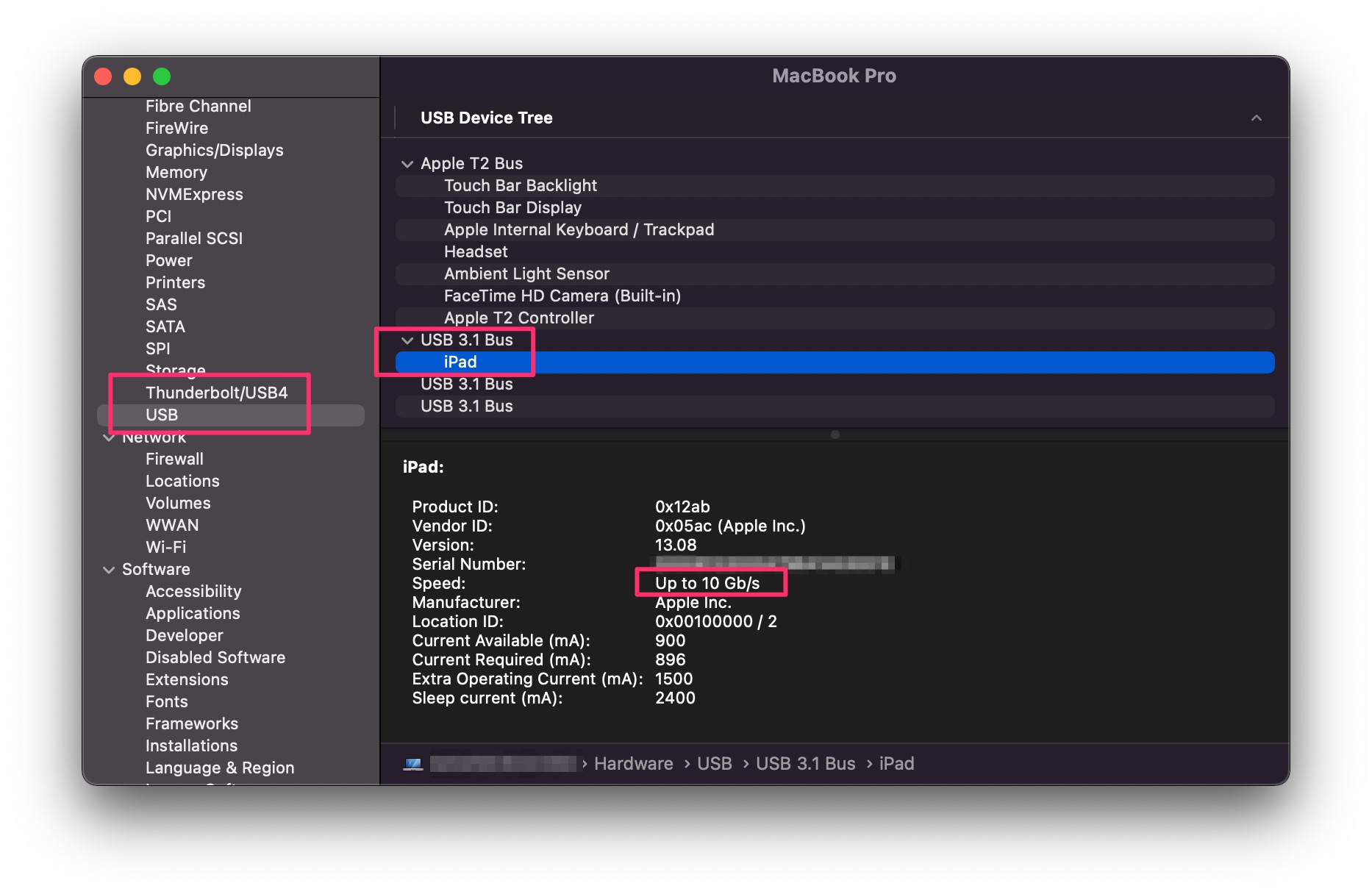

Using the CalDigit Thunderbolt 4 cable (supports TB 4, TB 3, USB-C 4/3.2/3.0/2.0 and 100W PD), my iPad Pro 12.9" M1 is reported in System Profiler as using a USB 3.1 connection (10GB/s) to my MacBook Pro 15" mid 2018 (which has four TB 3 ports) rather than using an -expected- TB 3 connection. The same happens when connected to my M1 MacMini, which supports USB 4 / TB 3 (40GB/s). Strange though, as iPad Pro M1 also has Thunderbolt 3 / USB 4 connectivity so I would expect it to use TB 3 / USB 4 (40GB/s) connections rather than USB 3.1 (10GB/s) in both cases? It's probably fast enough for Sidecar, but I still wonder why this happens?
No idea if this helps, but I had ongoing SideCar-over-USB problems with my 2018 iPP (yes, I realize it wasn't TB/USB4). What finally worked was a DFU reset. I appears I had some firmware glitch. The iPad would show up in system profiler and behaved fine, could even transfer files, but SideCar refused to see it over USB.
