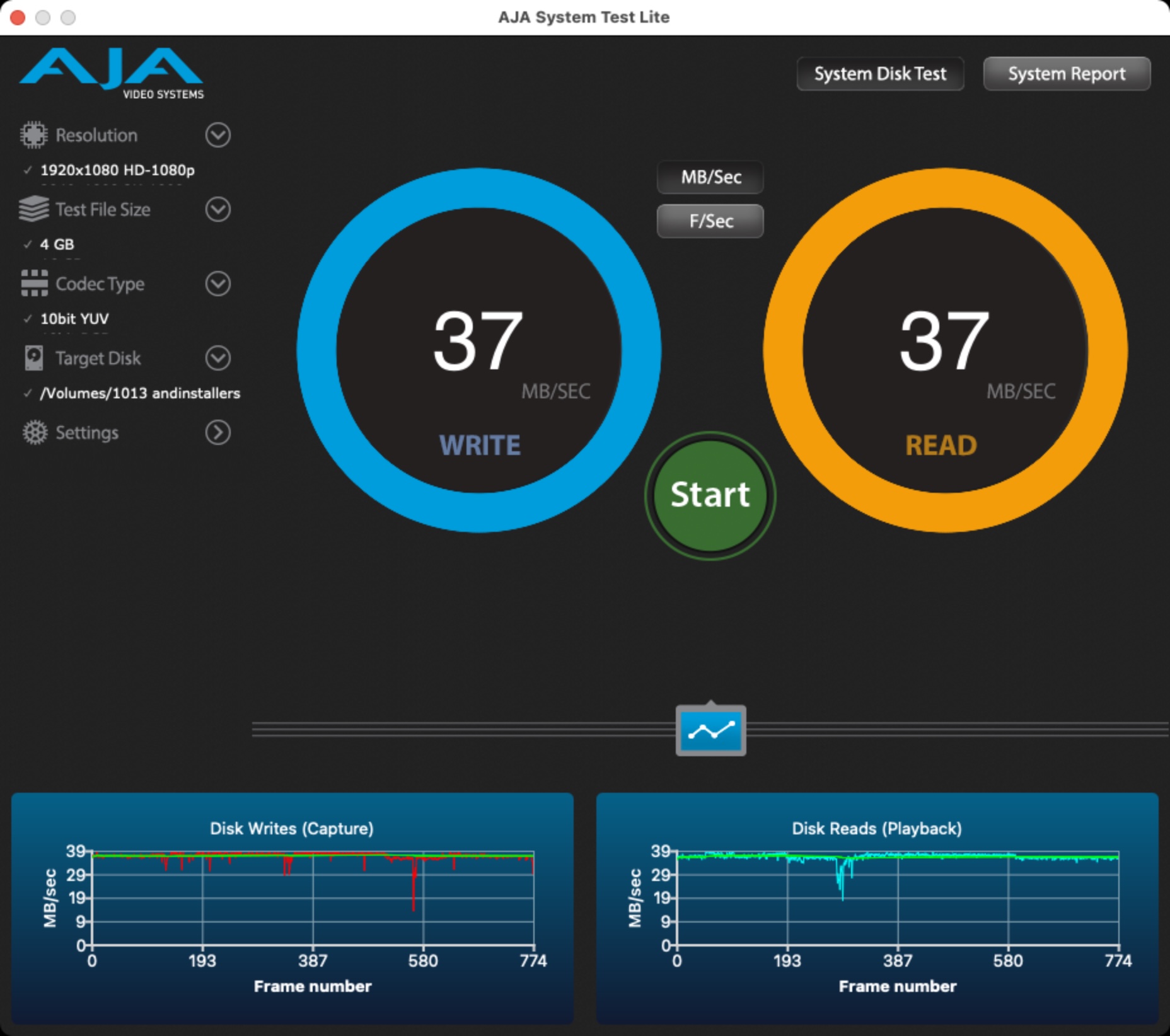

The USBC/TB ports on my new M1 Mini (8/500) are ridiculously slow at 40MB per sec reading and writing an external SATA SSD. Same SSD drive connected minutes before to the regular USB ports give 380 or so. I've tried multiple external SSD drives including the T5, and all give the same result. Installed Big Sur clean in a new partition, absolutely no difference. What's going on?

Looks as if you might be using a USB-C charging cable which are often only USB 2 speed for data.

OP: Those speeds are indicative of a USB 2.0 cable. My Crucial MX500 2TB SATA drive in a no-name USB 3.0 enclosure gets 223 MB/s write / 240 MB/s read on my M1 Mac mini.

The cable I've used is a standard short USB-C cable off Amazon connected from the Thunderbolt port to a Samsung T5. I later did try an Apple USB-C charge cable, which gave the same grim 40Mb rate as the standard USB-C cable. What rates are you folk getting with the same setup? What data rates have folk got using a Thunderboltexternal drive?
Get a proper USB 3 cable. There is no such thing as a standard USB-C cable! "USB-C" is just the name for the physical shape of the connector not what it does. It could be USB2, USB 3, Thunderbolt etc. All cables sold as charging cables including Apple's are USB 2.
Your Samsung T5 should have been supplied with a 10Gbps rated cable. Otherwise buy one from Amazon but make sure it says "10Gbps data transfer". It doesn't matter if it also says "charging cable" as long as it says 10Gbps.
I just checked Samsung T5 connected to my M1 MBA and it is 389/377 MB/s (R/W) with a 10Gbps cable.
BTW the Samsung T5 is not a Thunderbolt external drive, it is USB.
A charge cable doesn't need to transmit data, so it may be a USB 2.0 cable.
Samsung T5 is not a Thunderbolt external drive. It's USB 3.1 gen 2. Some USB devices are not connecting to the USB controller of the M1 Macs at 10 Gbps speed. Therefore the solution is to connect the T5 to a different USB port. A USB 3.1 gen 2 hub may allow the T5 to work at 10 Gbps. However, in that case you are still using the USB controller of the M1 Mac which is reported to be slower than most other USB 3.1 gen 2 controllers (except the ASMedia ASM1142 which is limited to 8 Gbps). Therefore for max speed, connect the T5 to a different USB controller. Thunderbolt hubs and docks have their own USB controllers which are faster than the USB controllers of the M1 Macs.
