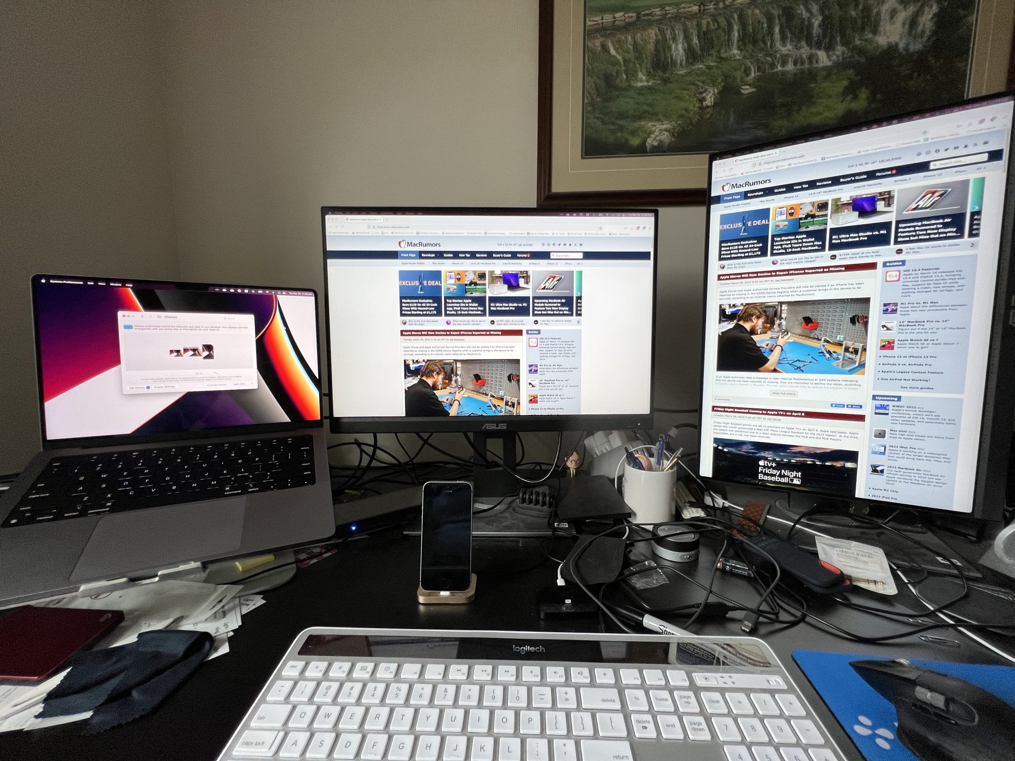

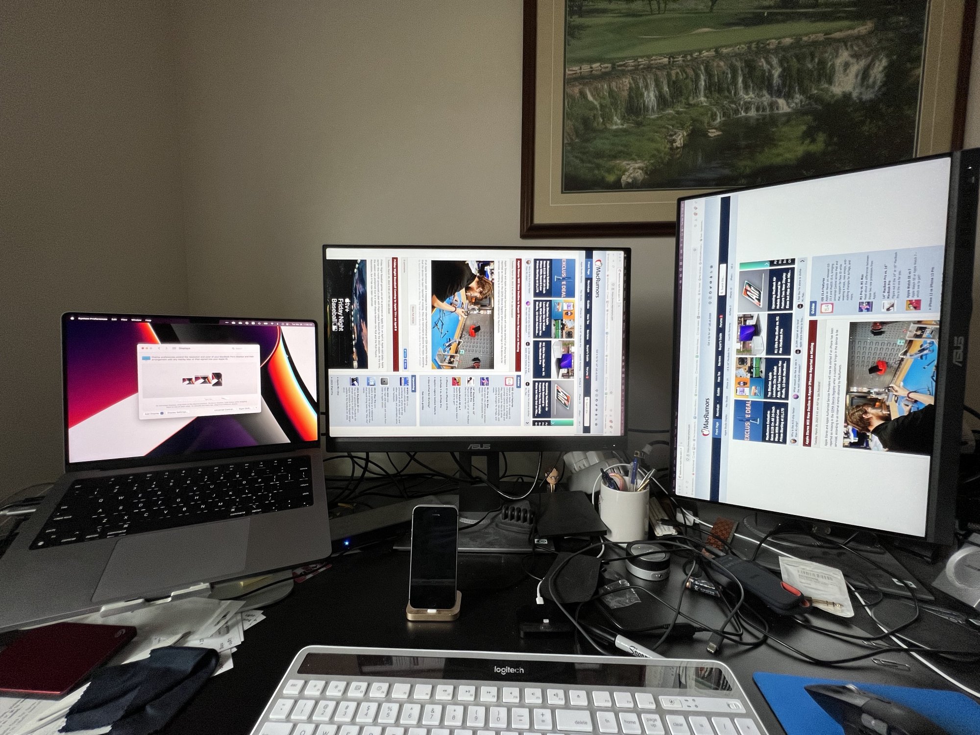

Here is the before and after. I can try to fix the configuration in system preferences, but my guess is that it would then be messed up when I connect and would then have to sleep and wake the displays to get the display arrangement corrected.
After connecting to the dock:
After sleeping and waking the display, this happens whether I manually sleep the display or if it happens from the 5 minute delay:
