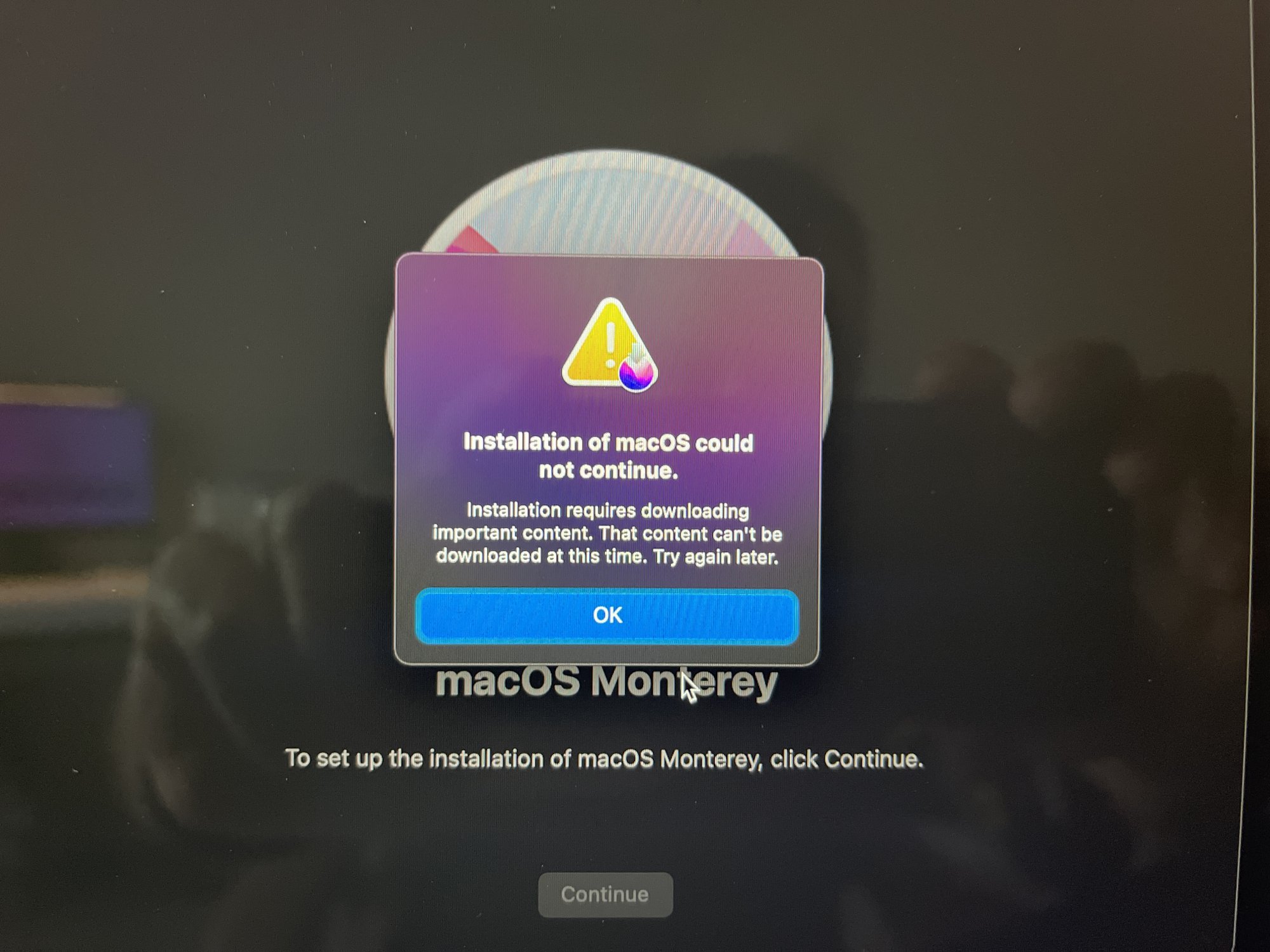

I have problem with reinstalling Monterey.
I installed first WITH beta profile installed of latest RC build and all went fine.
I than wanted to do clean install so I restarted in recovery mode. I erased the drive, Mac than rebooted and activated properly. Now when I click Reinstall macos I get the following error after a few seconds "installation of macOS could
not continue.
installation requires downloading
important content, That content can't be
downloaded at this time. Try again later."
MacBook boot properly into recovery but it can't seem to download required files. Is it because of my Mac or are jus ape servers busy?

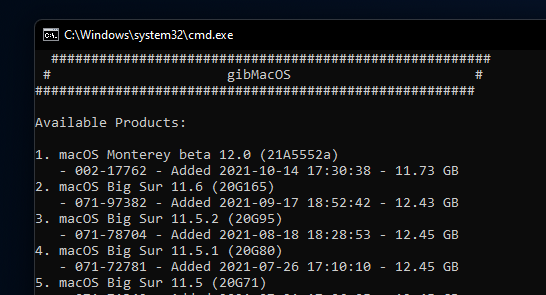

According to gibMacOS script, there is no full installer yet for the RC, this is probably why we're getting that error... Hopefully it will be up later tonight.

I tuned off my Mac mini M1. Removed power for 10 seconds. While pressing the power button I re-connected power and then it was showing in DFU mode on my MacBook Pro in Apple Configure. I dragged my IPSW file to it and did the restore option. When trying to complete the setup of my Mac mini afterwards I get stuck on the very same "installation of macos could not continue installation requires downloading important content".
