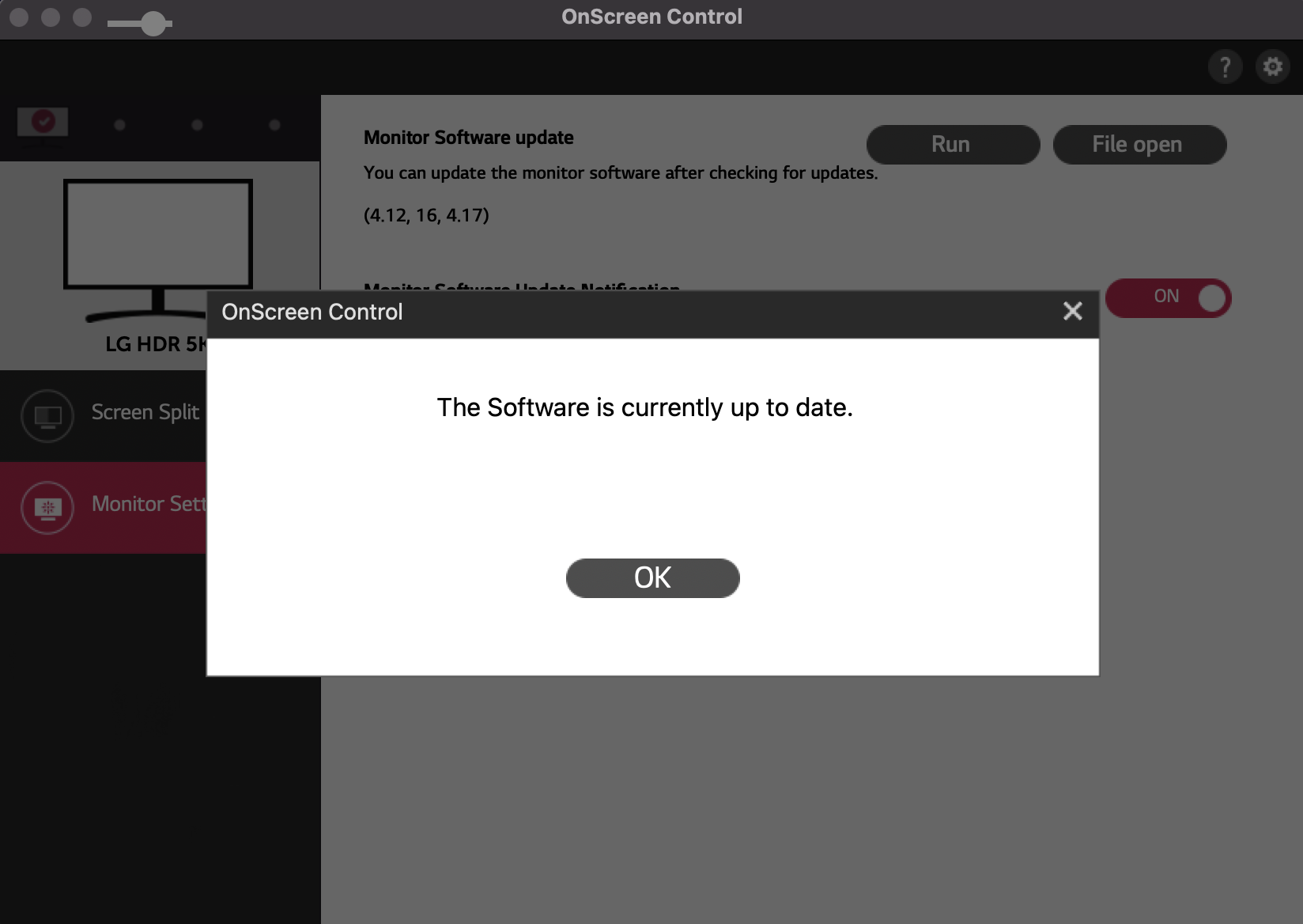

Where can I find this Firmware? My LG monitor model is BN88U-B and I can't seem to find a Firmware update anywhere.
That's not even the monitor in the thread title. LOL.
For 34WK95U/34BK95U, it's updated through the "OnScreen Control" software. You download it from the LG web site.
