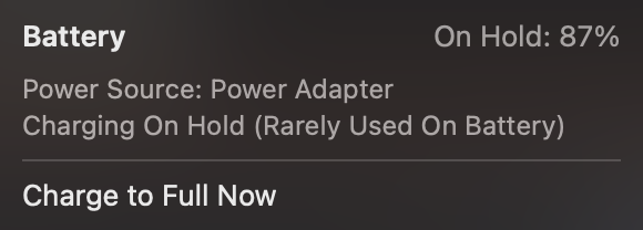

upgraded to macOS 12.2.1 this morning, now the charge behaviour changed. no longer do frequent top ups, my charge now hold at 87%
It’s trying to learn your battery usage patterns. If you regularly change when you use your MacBook on battery you will probably see the behavior change. I use my M1 MacBook Air almost exclusively on the charger so I see the “on hold” behavior nearly all the time.
That 1% of the time it’s unplugged is keeping the computer from holding at 80%. It simply doesn’t know how long your next unplug will last so it plays it safe. Use a third party app if you want to hold at 80% while unplugging.

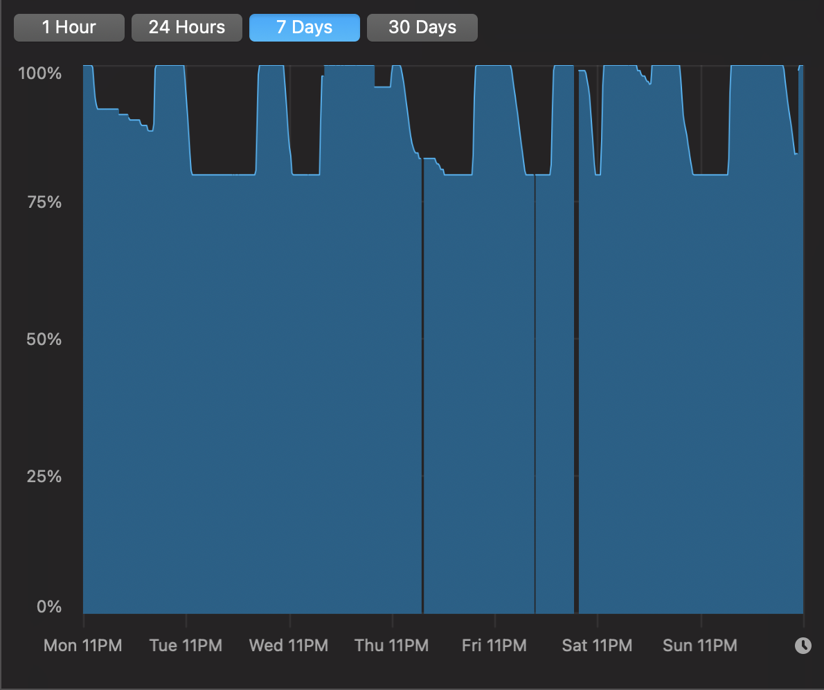

Here is what a week of battery charge percentage looks like for me even though it's plugged in 99% of the time:
Without being a battery engineer, isn't a lithium-ion battery composed of many individual cells, that each "gain" from being partially discharged and recharged from time to time ?
In the sense that it may be a way to "cycle" this discharge between different cells, while making sure the computer is always at least at 80% in case you suddently need it.
