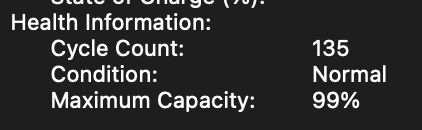

Weird numbers. Had mine last July 2022 and here are my stats:
I think the cycle count is weird for a device thats already more than 1 year old.

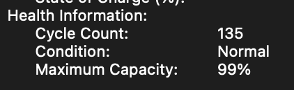

Every battery is slightly different so the number may not be precise with your specific battery. 34 cycles in 14 month suggests use mostly on charger, if you did not calibrate battery recently, system may not read it correctly. There is lots of possibilities. Also, time is very important - old battery with only few cycles will also loose capacity, simply due to age. So not using your battery is counter productive - batteries are consumable item, they will get used and eventually die...
But, it can also be correct, who knows. Batteries vary and there are bad ones once in a while.
Get coconutBattery (free) and compare that that is showing with what system is saying. You can also Compare online (there is button on History viewer of coconutBattery) with others with same system which will answer your question you pose here. I just checked and there is huge variation - at 14 month between 6800-8800 mAh.

Not weird number when it's mainly used as a desktop. 😛
