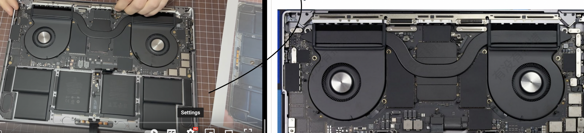

Do you think Apple unnecessarily increased the weight of the cooling system if it didn't provide some benefit?
Has it been established that they increased the weight of the cooling system between the 16" Pro and Max models?
Yes, the Max on the 16-inch has a larger and thicker heat spreader plate covering the SoC package.
On the 16 Max, there is a large copper chunk on the chip which interfaces with the heatpipe. On the Pro, this chunk is much smaller along with the surrounding aluminum memory heat spreader.

wondering if left one is 16 pro and right one is 16 max
