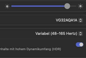

I have the MBA M2 but also an Hackintosh and via HDMI i had no Option to use Variable Refresh Rate or HDR or getting an Brightness Control in the Apple System Preferences:
This i have got only via USC-C to DP Cable or direct DP Cable from the Hackintosh on an AMD FreeSync Premium compatible Monitor.
