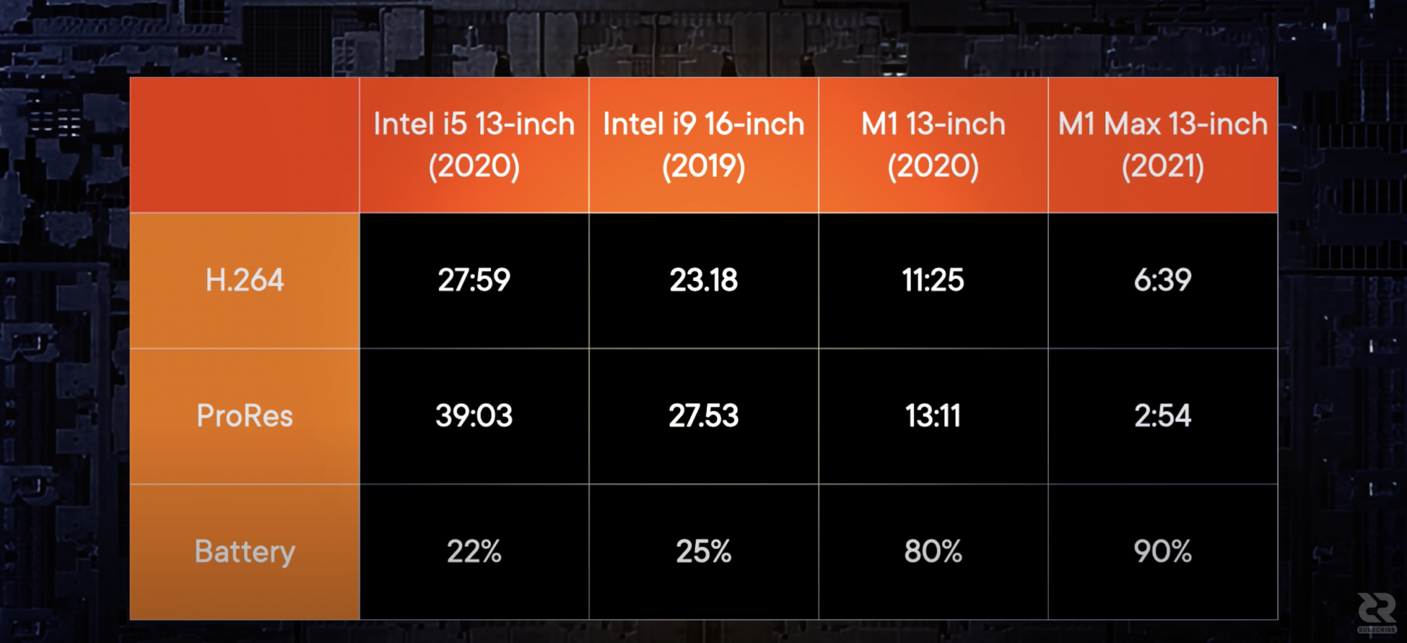

I bought a 16" M1 Max (32 GPU cores) and my video export/render times aren't quite living up to what I'm seeing in benchmarks/reviews.
For instance the following is from Rene Richie's review on YouTube:
(note the M1 Max 13-inch is a typo, it's the 16" model). Here he says he's exporting a 4K 18 minute video, and his M1 Max is able to do a H.264 export in 6:39 which is incredible compared to the intel i9 (which uses a 5500M GPU).
However, my benchmarks a a bit different. Here I'm exporting a 7 minute 4K/60fps video to H.264. My previous laptop is basically identical to the 2nd column above, and my new M1 Max the 4th column. Benchmarks:
16" intel i9 2.4GHz AMD 5500M = 7:03
16" M1 Max 32 cores = 4:44
Granted it's faster than the intel, but not to the degree as Rene Richie's results above. I have High Power mode enabled. What gives? There's something fishy about Rene Richie's results.

What is your acquisition format? And what was Rene's? And are you editing using the internal SSD or an external disk? Disk IO may play a factor, as can the compression of the original camera files. Was Rene using optimised material (ie. ProRes?)
Source footage is captured from a GoPro 9 camera and is in H.265 HEVC format (100 Mbps bit rate). Everything is in internal SSD (4TB model). No idea what Rene's source format is, he uses some high-end cameras so maybe is was ProRes?

Unless you did what he did, why would your results match his?

He uses "CANON 4K 10-BIT CLOG 2 XF-AVC" (noted in bullets in the video). HEVC -> H264 vs XF-AVC -> H264 is likely a significant factor.
The i9 and T2 on the 2019 MBP both have HEVC encoders (through VideoToolbox) so it shouldn't be much different than the M1. Note, through VT, it won't be using the dGPU. It would be using the i9 iGPU or the T2. Your results are what I'd expect.
If your question is how he got such a high number, well. He probably rendered either using the CPU or the GPU and not through VT. Why? IDK, intentional? dumb?
I had some disappointing results until I got my M1 Max to actually use the hardware encoders.
Now it's absolutely FLYING!
Check out this guide to get it working. Use Apple Devices Presets for H.264 or HEVC encoding.
