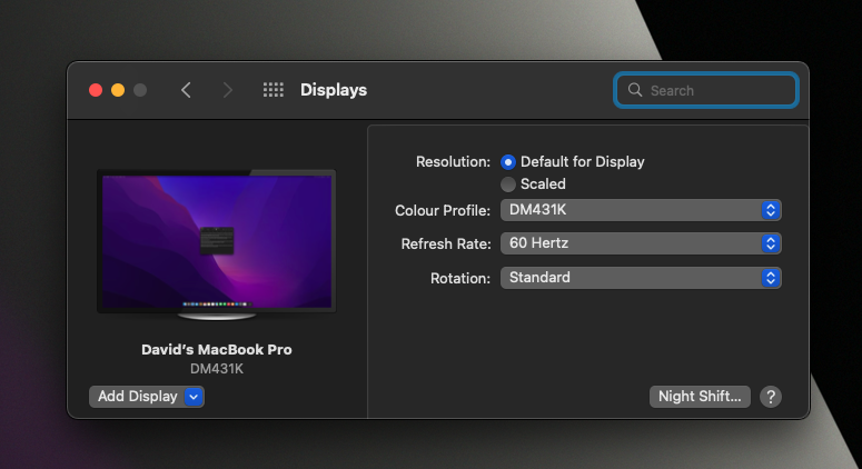

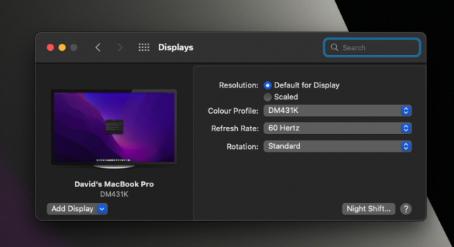

Thanks for replying. Yes its the Acer DM431K, it picks up the correct monitor profile when plugged in and using the desktop its buttery smooth switching between mission control.

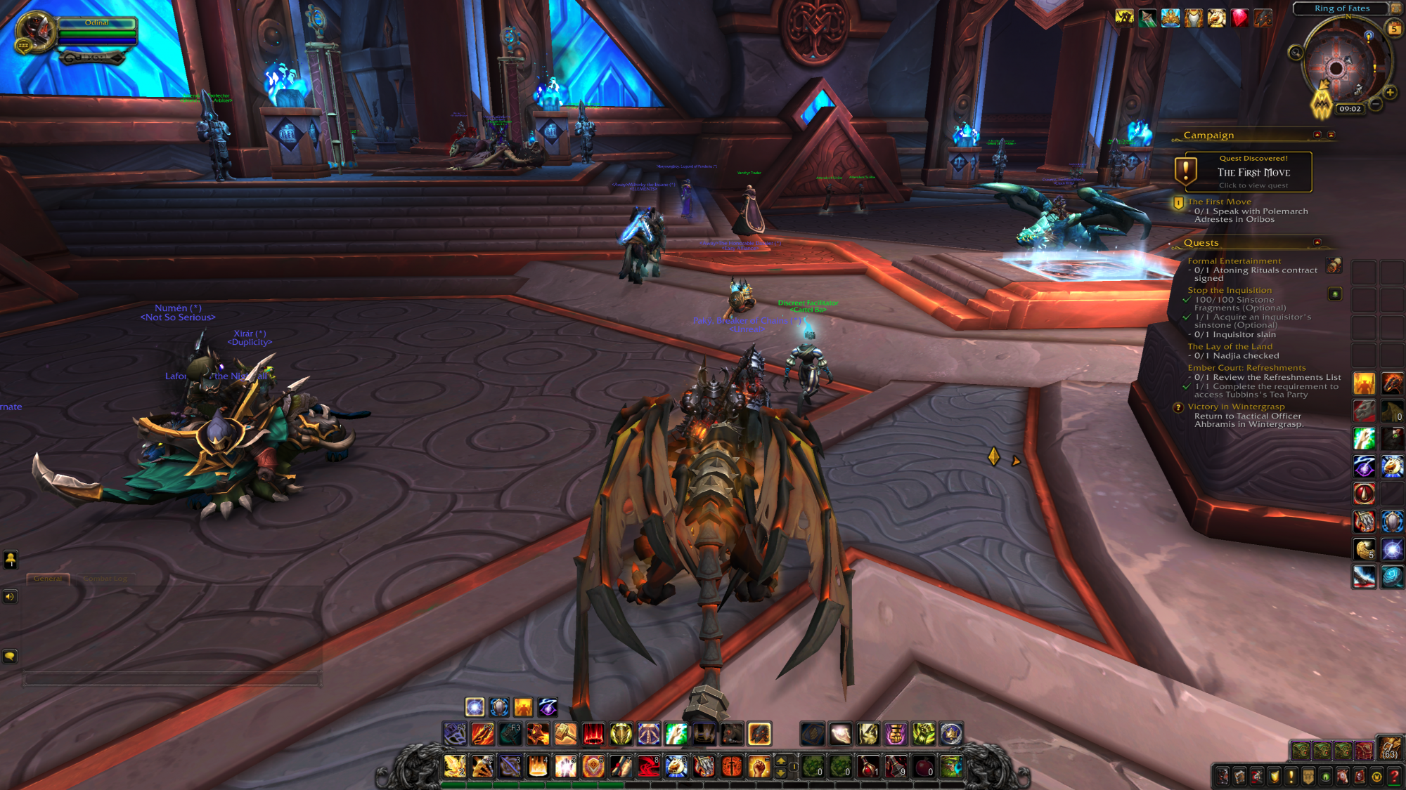

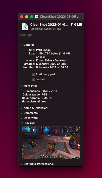

You want to make sure the game is not trying to do 7680x4320 or anything greater than 3840x2160. Try taking a screenshot, then check the size of the screenshot.
Thanks guys, seems to be running at 3840x2160 with no type of scaling. I will do a video to show you what I mean.

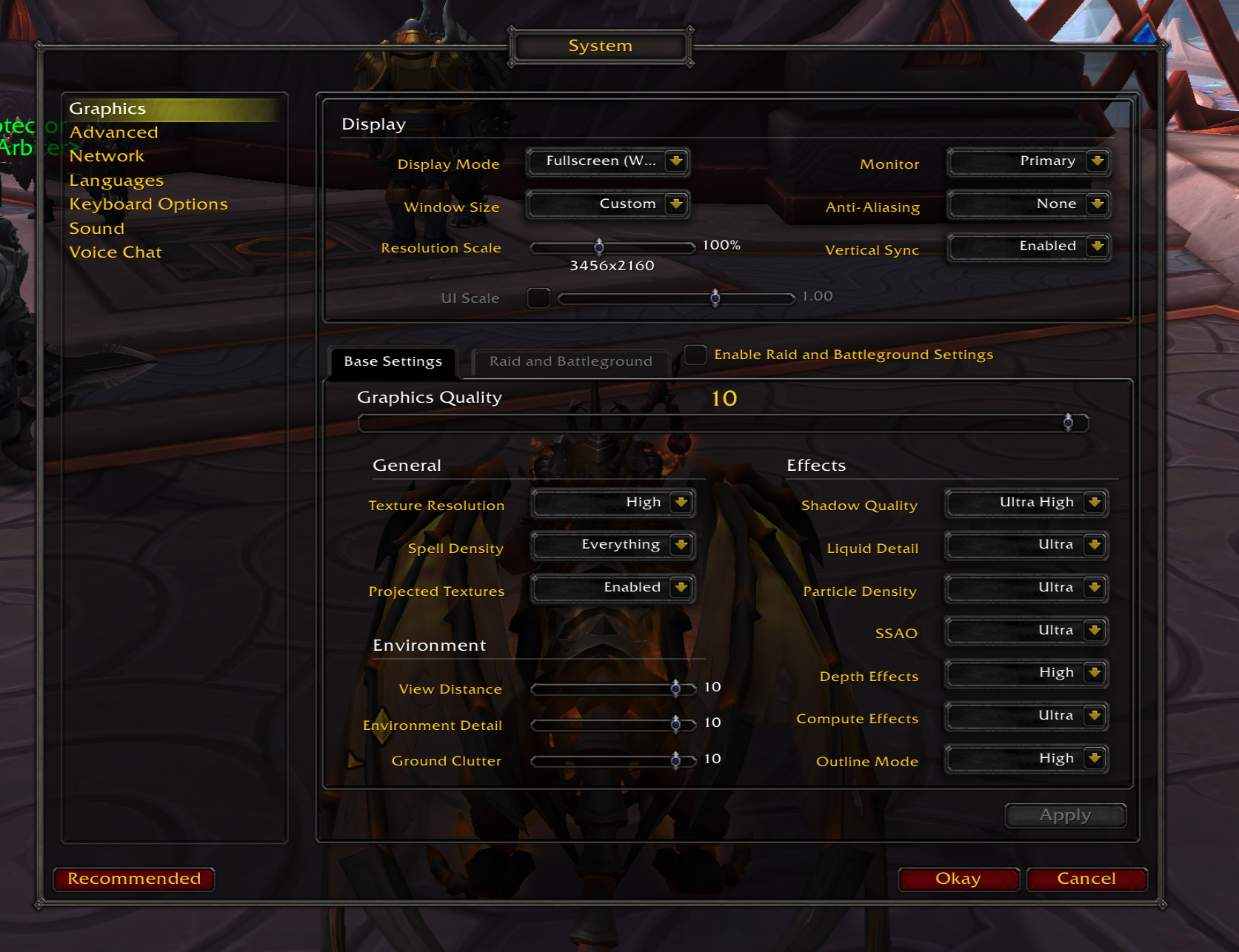

Tried running in a window at 1440p and got the same wild frame rates. It should definitely run flawlessly at that resolution.
What does the game resolution show when it's running on the built-in screen? I assume the 3840x2160 shown is for the external screen. (The default for the internal display is pixel doubling, so 1728 x 1117 with pixels doubled each way.)

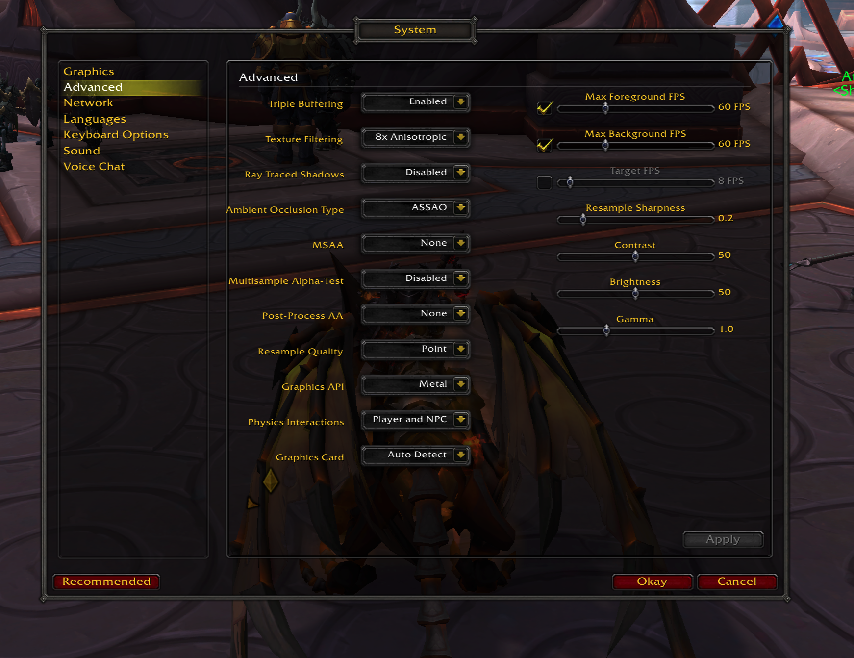

I use a cable direct from the monitor to the Mac. A guy from Reddit replied with this…
Check under your WoW Advanced Graphics settings under Graphics Adapter if it says something like “M1 Max (low power)”. This is the cause for the low FPS.
How does it happen?Basically I use my laptop running on batter, e.g. on my couch. Then I move to my desk, plug it into my Ultrafine 5K display via thunderbolt, which also charged the M1 Max. However - at least as far as WoW is concerned - the GPU remains in some sort of “mobile” mode and WoW will give really bad frame rates. Fiddling with powersaving and whatnot doesn’t change WoW’s mind. The only thing is to reboot the Mac. WoW is fine then.
My take on it: probably some glitch in Monterey. I’m having all kinds of thunderbolt troubles which I didn’t have on my M1 MBA with Big Sur.
