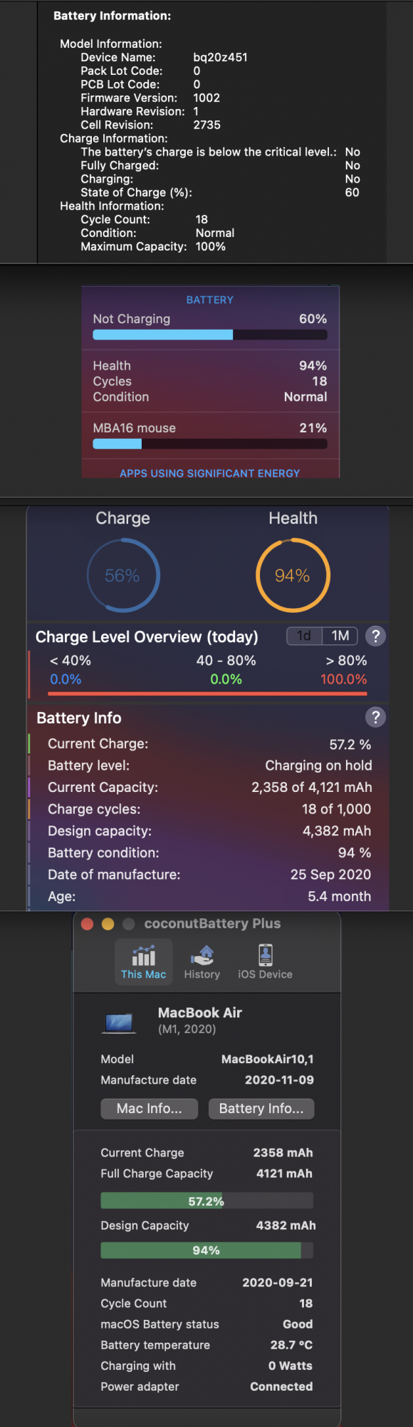

I can see my battery health in four different places on my M1 MBA:
About this Mac > System Report > Power shows maximum Capacity as 100%. It doesn't call this "Health" but I am assuming that it is full charge mAh as a percentage of design max mAh. ie the normal Health definition. (NB the Mac is only at 60% charge so no confusion with current charge%)
Coconut, Better Battery and iStat Menus all say Health 94%
All four sources say 18 cycles.
System Report and iStat Menus report current charge as 60%
Coconut and Better Battery both say current charge is 57.2%. Better Battery has an option to "show true charge" which accounts for the difference 60 to 57.2.
94% Health on a 3.5 month old machine with 18 cycles is a bit worrying, but the Apple System Report says 100%.
Machine has been plugged in to power nearly 24/7 since new on November 21st. I started using Al Dente to keep it at 60% max two weeks ago.
Anyone understand the difference between System Report and the Third party app reports?

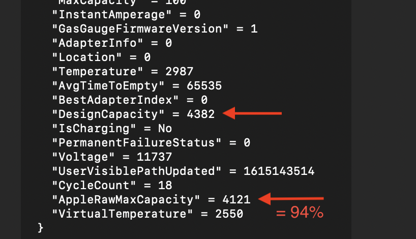

I've looked into this pretty extensively and while I don't have any understanding of why different percentages for current charge are reported in different places, they are all coming from the OS as far as I can tell. I've built a bunch of shell scripts and tools that use the command line ioreg tool and I can get values for everything that match coconut battery, the menu extra values and the system profiler values.

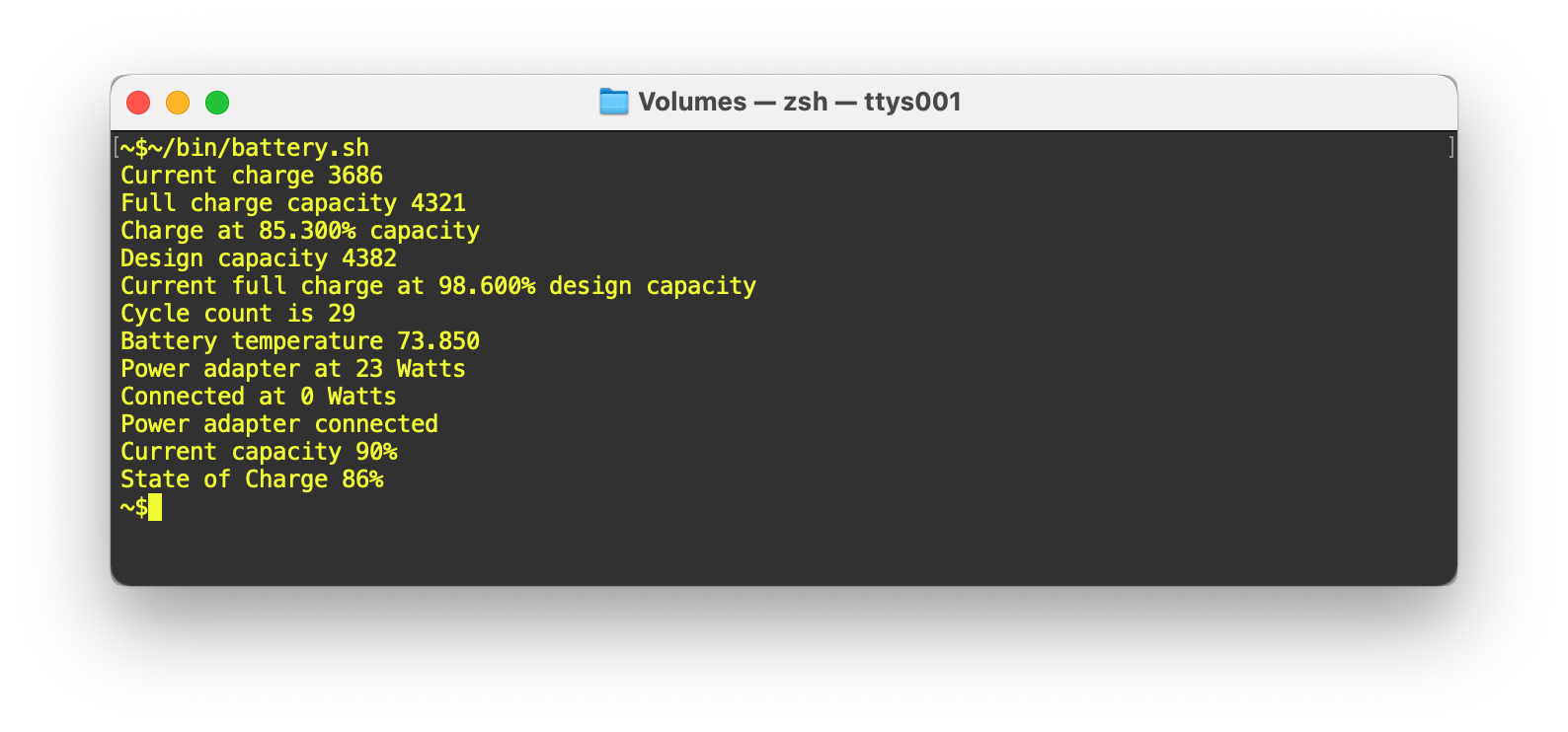

The consolidated output of my shell script:
The first "Charge at x% capacity" is calculated from the full charge capacity and current charge values retrieved from ioreg. The "Current full charge at x% of design capacity is calculated from design capacity and full charge capacity. The cycle count and battery temperature are simply retrieved from ioreg (Edit: though the temperature is returned as degrees Kelvin and converted here to degrees F). The "Power adapter at x Watts" is retrieved from ioreg. The "Connected at x Watts" is calculated from two values not otherwise displayed, "AppleRawBatteryVoltage" multiplied by "InstantAmperage" (which is represented as a two's complement binary when negative.) This shows Charging, Discharging or Connected depending on the value. In this case since the battery is neither charging nor discharging I used Connected.
Then we get to the odd values. Both Current capacity and State of Charge are simply retrieved from ioreg. The current capacity value matches what is in System Profiler and the menu extra. The State of Charge is approximately the same as the calculated value though I don't know if it is displayed anywhere in the OS.
I would love an explanation for all the different values. It really doesn't make a lot of sense to me but I'm fairly certain that these values aren't being calculated by separate applications but are all coming from the central ioreg repository.
I know you've said you aren't much for the command line but if you want to check it out the basic command line to get the values in a mostly human readable form is: ioreg -arc AppleSmartBattery.

They chose to use different numbers just as I did. Once you investigate this, it becomes pretty apparent that the correct numbers are what is being displayed by coconut battery. The other numbers are fudged for some reason to show more of a charge than is actually available at least according to the values in the current charge and full charge capacity slots.
Everyone could be using the CurrentCapacity value but that supplies less information than the other values.

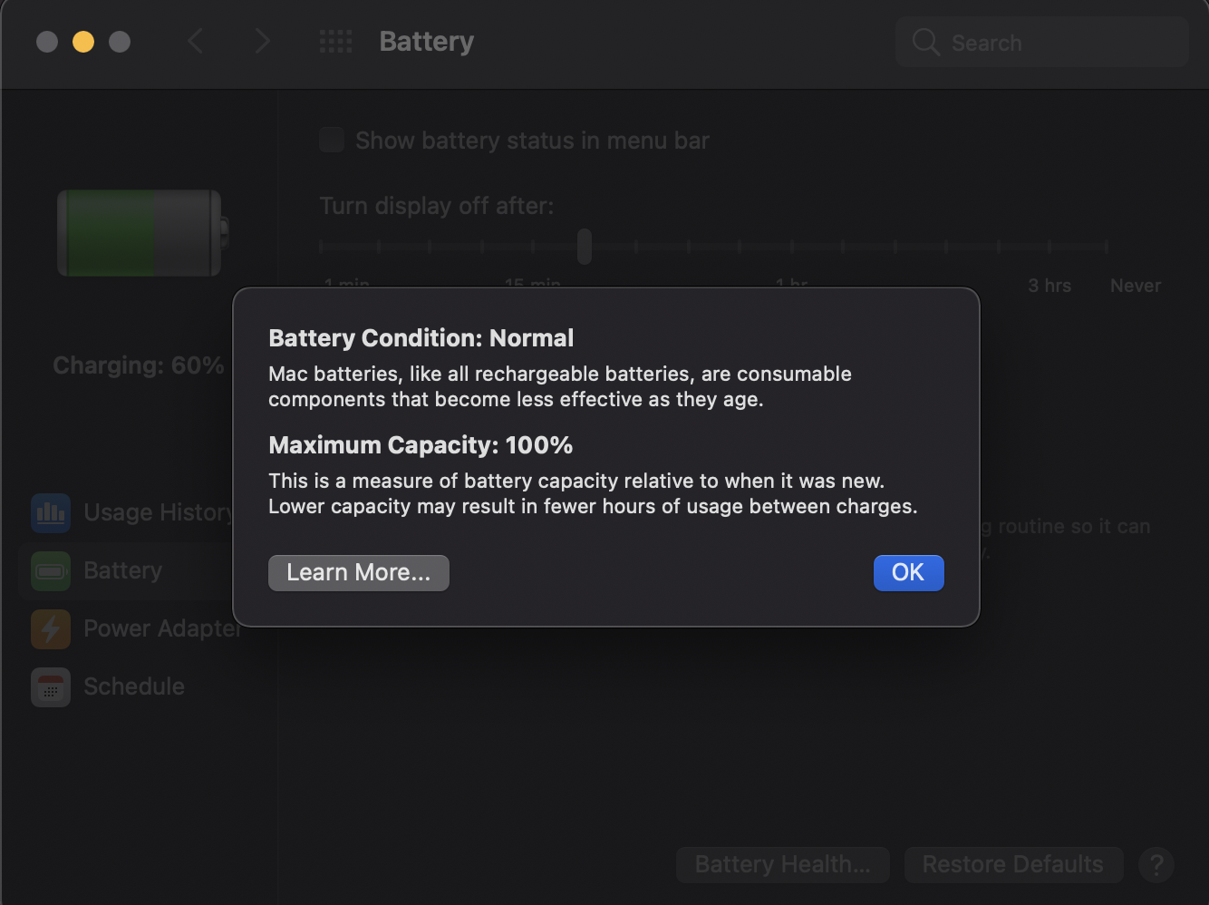

If I read your previous post right what you called the "odd values" related to the current capacity and state of charge, and are presumably behind Better Battery's preference option to show "Real Charge Level" or not.
Your odd values don't seem to include the "Maximum capacity" in System Report and also in the Battery Pref Pane:
In my case I have Apple telling me in bold type 100% health and Coconut and Better Battery only 94%.
I am surprised this discrepancy is not getting more attention.
Normally I would be more inclined to believe Apple reported numbers than a third party app, but Coconut has a good reputation and Apple has an interest in showing a high number.
I haven't researched where Apple gets the Maximum capacity from. It is pretty clear that coconut battery is getting it from the AppleRawMaxCapacity / DesignCapacity. Again, this supplies more information than whatever fudging Apple is doing in that dialog.
Edit: A quick search tells me that the 100% is probably coming from the MaxCapacity ioreg slot but since it doesn't change (yet) I can't know for sure.

It depends. If I was looking for information on whether or not my battery was degrading too quickly, I want the extended information I'm getting from coconutBattery. If I just want to know if Big Sur & Apple consider everything to be normal, then the values from Battery Health are fine.
The biggest problem with information coming from the third party battery utilities is that people are liable to overreact when they see a drop in their full charge capacity even though everything is normal. This is probably why Apple fudges the numbers because they are trying to make the battery degradation look linear to the user when it probably will never be linear for real.
