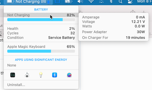

I noticed on Friday that Condition was stating Service Battery but it was unplugged and I thought it'll sort itself out. But now I'm plugged in after a reboot and it's not looking good. It might be holding a charge at 82%, not sure yet.

Istat menus does not read the battery condition for m1 mac's at this time. It's right on their website.
My M1 MBP will show as "not charging" for the first few seconds, but will then switch to charging.
It turns out that the whole thing is indeed a software error within iStats, which to me is severely disappointing and unacceptable. They should not be releasing software which shows incorrect values when they cannot figure out how to calculate something, or get something from the underlying libraries. Instead show unknown, or something along those lines.

Please see Power in System Report under About This Mac. Do not rely on and get anxious with third-party software when it comes to hardware information. Coconut Battery is the only third-party software I trust for battery information. Not even iStats.
Reactions: theSeb
Thanks for feeding back everyone. Yes, it does indeed appear that iStats is at fault so I'll be ignoring that for now - even if I get round to reinstalling it. The native battery reading says all is good. What did seem weird though was that when it did stick on 82% for over 20 minutes (iStats and native readings). Then it did charge as normal up to 100%.

The delayed charging sounds like you have activated OSX battery management.
On the first screenshot I believe there's a power plug instead of a lightning symbol on your battery -- that means that macOS is not charging, it does that on purpose to save your battery when it's not expecting you to be needing it soon.
