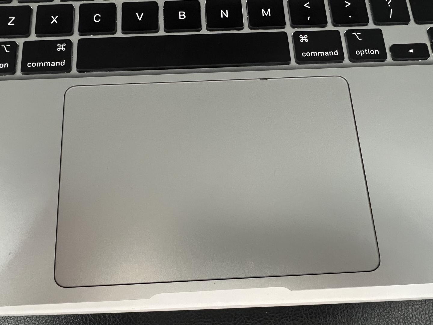

I have a pristine 99% battery (102 cycles) capacity M1 - 8gb model, and a pretty noticeably used and beat up M1 - 16gb model at 87% battery capacity (420ish cycles). The 16gb model has a weird trackpad internal defect (see picture)
that seems like the silvery film they use to color it has deteriorated, the glass is intact 100% and the palm rests/keys show significant wearing from heavy use. The 8gb is much nicer looking.
