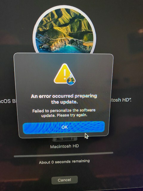

Hey Guys, Just got my M1 MBP 13, After setting it up, my wife wanted it so I went to erase the SSD and reinstall Big Sur... Not. What a horror. After checking Google seems this is a problem! How does apple put out a new product and have this issue? I did make a Bootable USB on my other mac and tried hitting the option button upon start up no bootable USB shows .. Actually nothing shows when OPT key is pressed upon booting... I read that you have to take it back to Apple to have the OS installed... After spending 1700 $ ( 16GB Ram ) I will be going back to apple today for sure, But to RETURN it for a refund.. We will wait till 2021 and pick up the new redesigned MBP ... Just my experience.

Thanks for your help.. But What happens if this was the ONLY Mac computer in my home... Thats what saying . The bootable USB doesnt show up.. Ill give it another shot this am before I head to Apple to return .
UPDATE: Comes up with an error , with the bootable USB drive too! Going back for a refund.

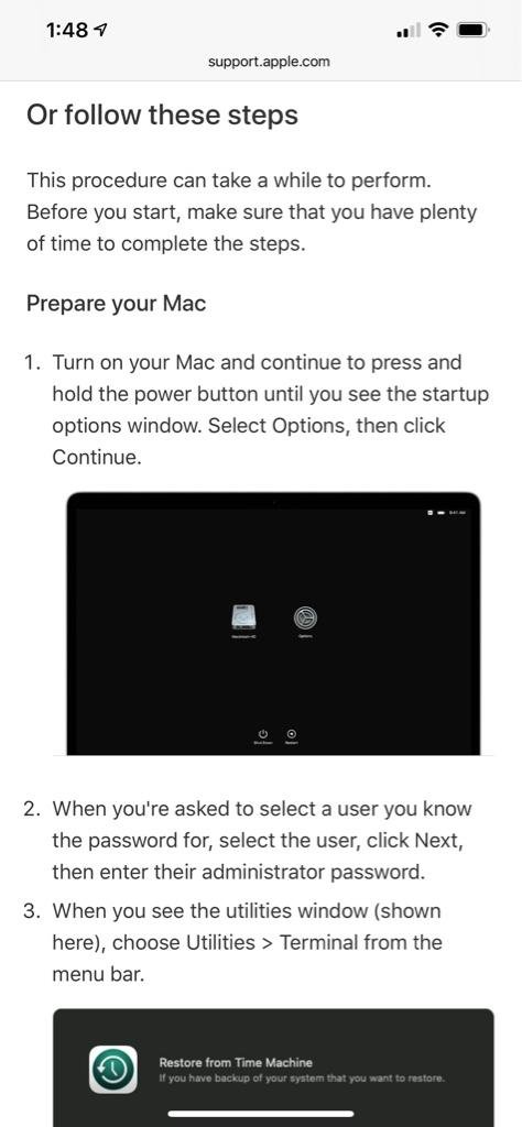

@harleymhs Have you read this post:

You don’t need to return it or require Apple Configurator and 2nd device. Easily fixed just requires time and internet connection.
Jump to 3min mark
Apple Support article:

🙄 dude. I did the same thing when I first got my M1 MBP - installed a bunch of stuff, installed 11.0.1 update, couldn't get my AW to unlock my MBP and decided I wanted to start from scratch. Went into recovery mode - erased, got the personalization error - went F'k then found the solution on MrMacintosh and Apple KB. Followed the video and was able to fix the issue and reinstall fresh. If you decide to wipe and reinstall in the future just follow the steps listed in this post:
