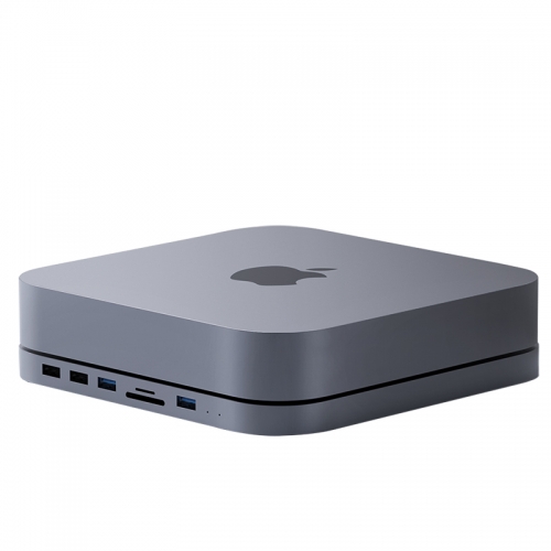

I was tempted by the form factor and price. I was hoping an updated one for the M1 MacMini might show.
So, I decided to grab mine and haul it out. Form factor, it's fine.
The issue is that the M1 mini sees the card reader, but it's not mounting any SD cards. Don't know if it's just my unit gone bad or an incompatibility.
As a USB hub it is working fine, and I've used similar SD Card readers with the Mini. so it is possible the SD card reader is just bad in my unit. Not a great endorsement though.
EDIT: And now it is working, but macOS 11.1 refuses to show it in the sidebar in Finder. Wut.
EDIT 2: After rebooting, things seem to be fine again. I think I managed to hit a Big Sur bug. Neat. :|
I have been using the Hagibis dock for a few days now, and so far it worked well, apart from the occasional error message from macOS complaining about the SSD in the 2.5" bay disconnecting after the Mac mini wakes up from sleep. The USB ports works as intended and no wifi or bluetooth interference was observed.
  • Love
Reactions: MiniApple
One of those hubs would be pretty ideal for me, the chance of data corruption from the SSD disconnecting suddenly at sleep worries me though.
I ordered the same Hagibis dock, however I have yet to get my Mini or this dock as their somewhere on this globe.
In what format do you have the SSD?
