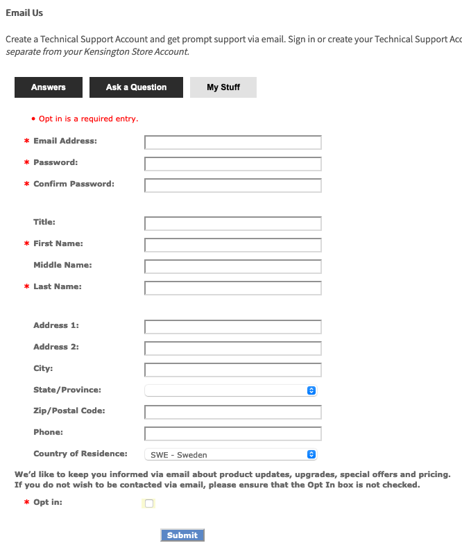

I'd like to file a bug report to Kensington, but the only way to contact them seems to be a phone number, and I'm not calling america for this. I was about to give in and register for an account with them to send a text message, but then I faced this ********:
I don't want unsolicited email from them, so I ensure that the Opt In box is not checked.
When I click submit, I get that Opt in is a required entry.
This is some serious αsshole design.
