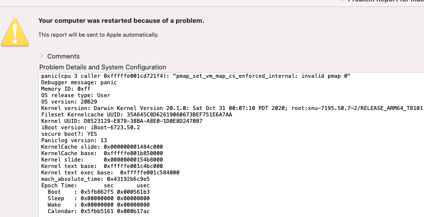

Leaving the M1 Mini turned on overnight, I woke up to the login screen and when I logged in a panic message and restart showed up.
It's been connected to dual displays and has been fine last week leaving it on overnights....
Can anyone decode these panic messages ?
Bad HW. you should not be getting this. I have almost 5 days uptime running heavy tasks etc and its rock solid.
PMAP = Physical map (i.e. the physical addressing of your memory)
VM = Virtual memory
CS = Code signing
Usually the panic is not telling you the actual cause, because it is trying to address something that is 0. So:
A: It could be a chain of oddities leading to an error caused by a kernel bug.
B: A fluke somewhere.
C: Error in hardware.
If you get the same error repeatedly, A is most likely. If you get random similar panics, hardware (C) could be causing it. If it is not happening again, then likely B.
Reactions: 4sallypat

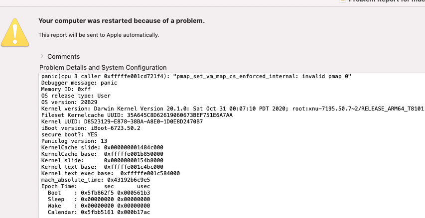

what did you end up doing? i get this occasionally as well. not sure if its hardware of software

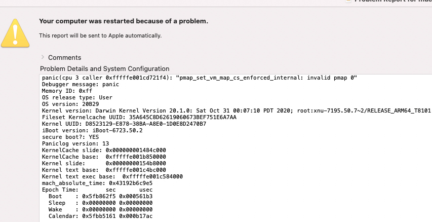

I disconnected all the USB devices and went wireless KB & M.
I am still on hard line (Ethernet) as Wifi is not as speedy as connecting direct to a 1Gbps switch.
No more panic kernel messages so I guess what ever I was running or installing may have fixed it ??
So far so good for now...
