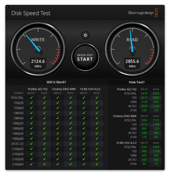

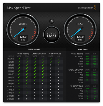

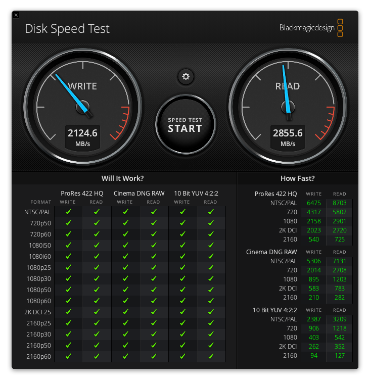

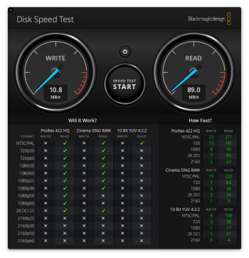

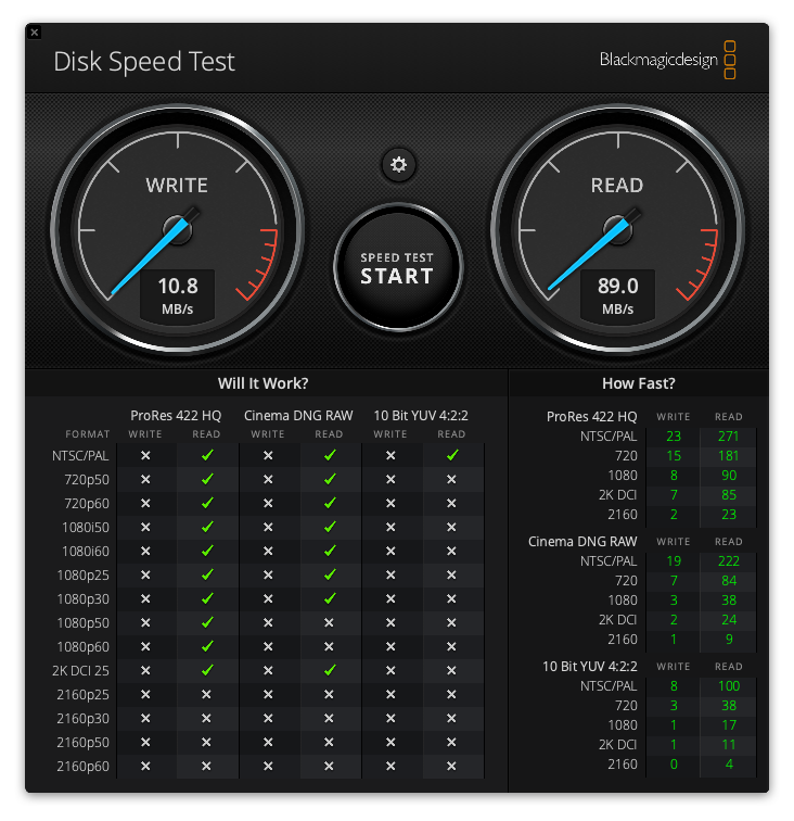

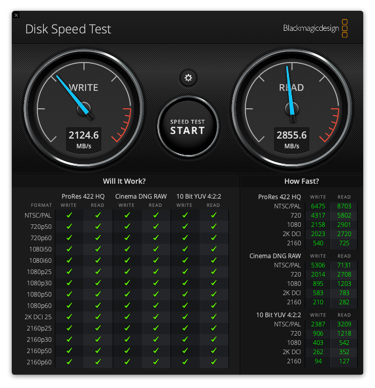

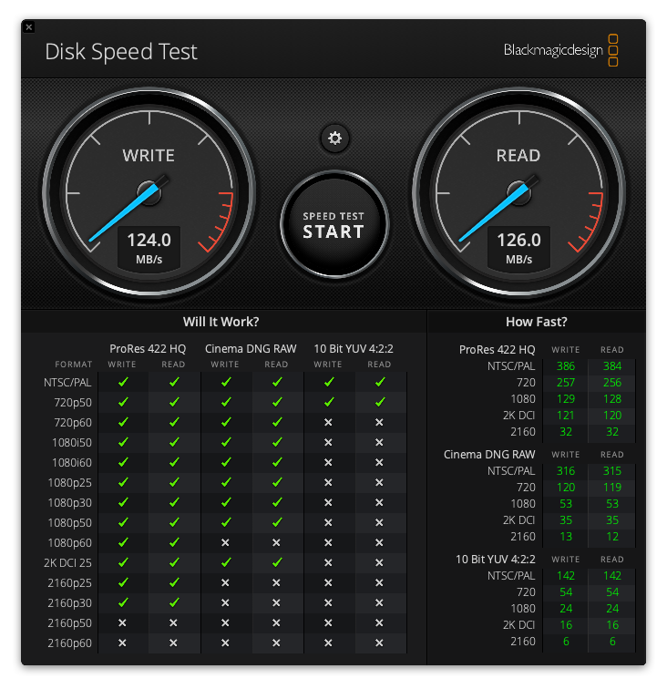

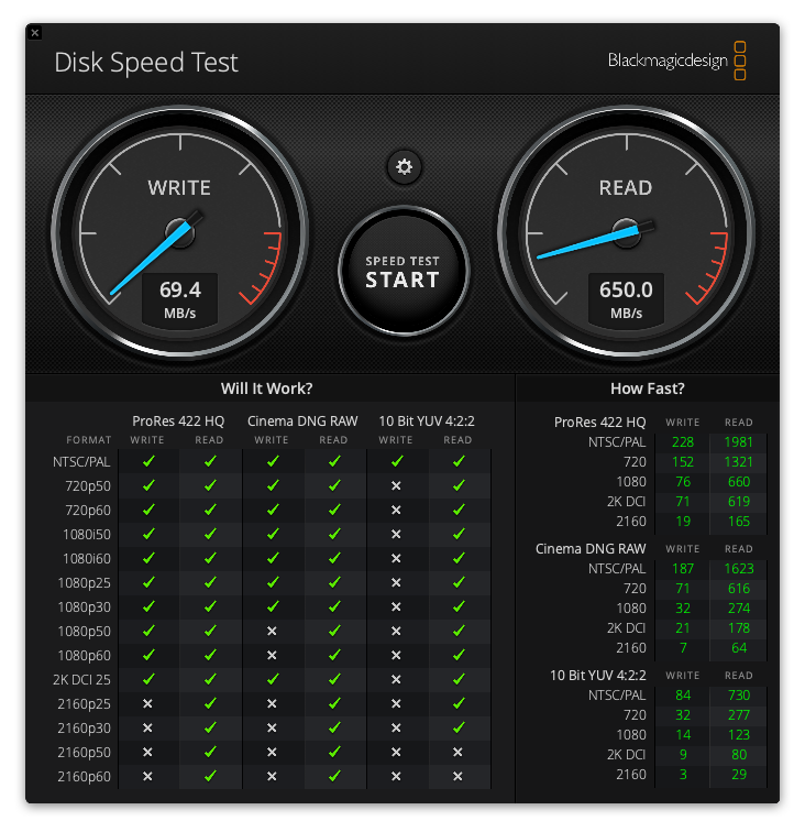

Some tests with Blackmagic.
Most of those benches seem on par. The T7 write looks low to me, though I've never used one or seen tests.
Anyway... The PNY thumb drive does appear to be a slower performer. If you look at the reviews here...
...Your values aren't far off.
So, based on some quick calculations, it'd require about two to three hours to write 67 GB of FLAC music files.
