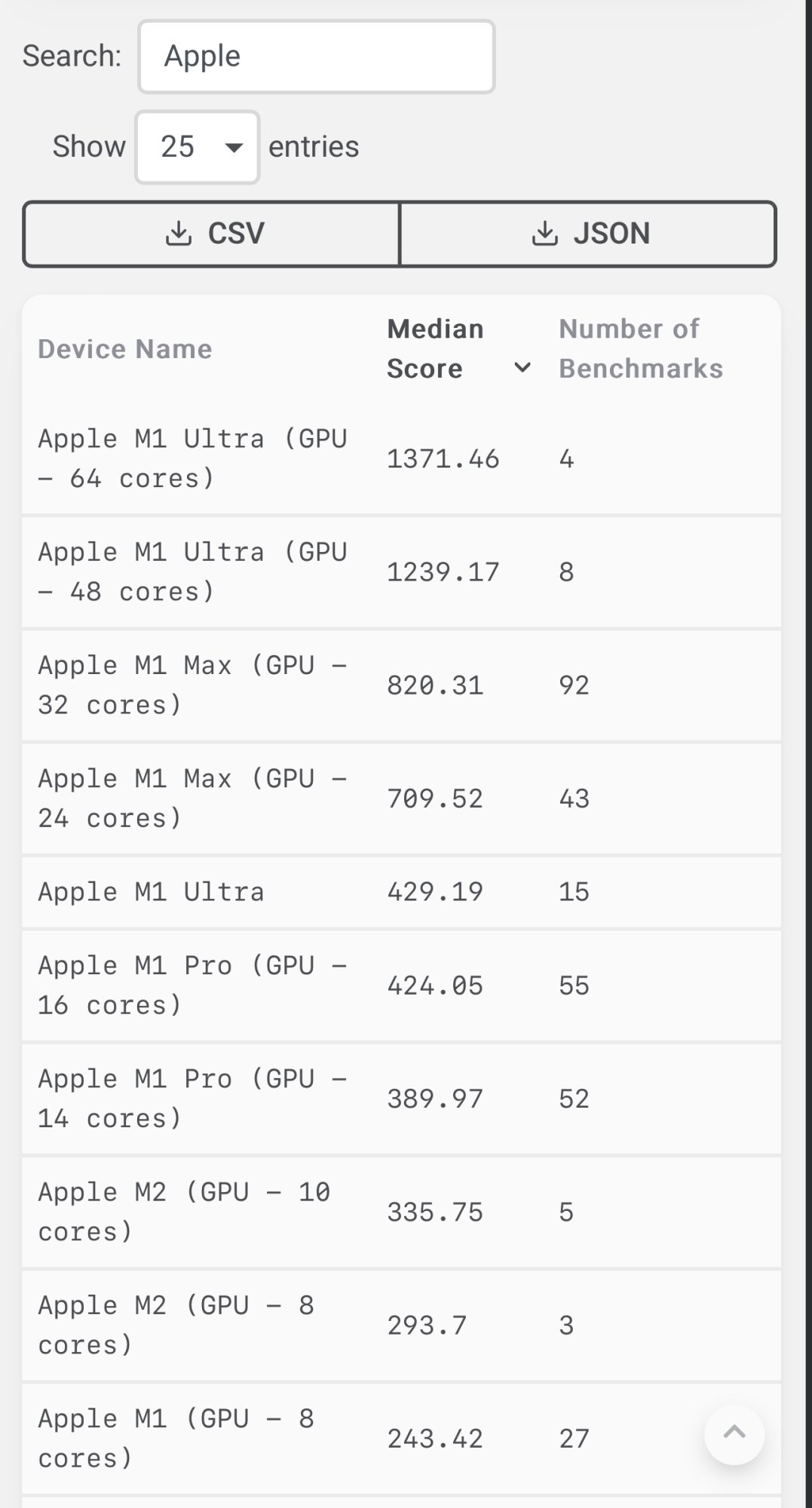

Inwould not necessarily base my decision on a 1 year old video when it comes to blender.
Here some numbers from the faire recent 3.4 version
