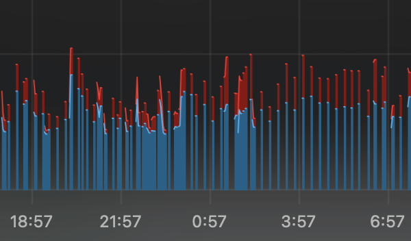

My 14" M1 Pro wakes up every 15 minutes when in sleep mode. I lost 7% battery overnight with all of this background activity. There must be some way to stop this? I recall there used to be a setting for something called "Power Nap" that could be disabled, but I no longer see that as an option anywhere in system preferences.
Attached is an image from iStat Menus showing wakeup every 15 minutes overnight. Any ideas on how to make the computer really sleep? I know I could just shut down, but I really like being able to pickup right where I left off...
