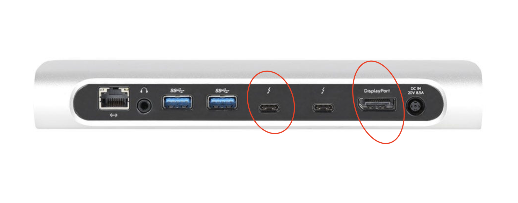

I have a Belkin Thunderbolt 3 Express Dock HD which I got for cheap, but it doesn't work with my PC or my Mac for some reason even though it seems to be in good condition. Giving me similar errors and not really sure why. Could well be the M1 thing.
MBP can support two external displays over Thunderbolt. You will need a TB hub with HDMI/DisplayPort/USB. MBP can support a display via HDMI and via TB/USB for two external displays. If you want two external displays via single USB, you need a USB hub which supports DisplayLink.
You can do two displays via a single Thunderbolt cable. One display can come from the dock's DisplayPort, and the other display can come from a USB-C to DisplayPort/HDMI cable from the dock's downstream Thunderbolt port.
That does mean you need a Thunderbolt dock that has a downstream Thunderbolt port, but plenty do.
Have you tried this:
Plug one monitor into the DP port, and the other into the secondary TB port (USB-C to DP or USB-C to HDMI).
Unless the dock itself doesn't work at all?
Dual external displays is unfortunately really fiddly on the Mac. Windows will do dual displays over USB-C or Thunderbolt, using 'MST' (multi-stream transport), so it's not fussy at all. Mac won't do dual displays over USB-C at all because it doesn't support MST. It will do it over Thunderbolt, but only if one of the displays is connected via the dock's secondary Thunderbolt port.
Annoying, expensive, but it does work. And it'll continue working on Windows if you wire it up that way.
I had tried USB C port (display) to USB C port (dock), using an Apple Thunderbolt cable. But that may be the problem. I haven't tried a DP to USB C or HDMI to USB C on that same monitor.
Can the HDMI or DP-to-USB C be any USB C or does it need to be HDMI or DP to Thunderbolt?
I'm a little confused by your terminology here.
If you can, I would do this:
Dock's DisplayPort port > DP cable into 1st monitor's DP port.
Dock's second Thunderbolt port > USB-C to DP cable into 2nd monitor's DP port

He apparently also has a "Belkin Thunderbolt 3 Express Dock HD". Will be interesting to see what happens if he tries plugging in as I mentioned above.

Yep. I just ordered an HDMI to USB C cable and plan to try it and report back. I'm still skeptical it'll work, though, because the Windows PC gave me errors saying it couldn't detect the dock when I connected it even with just one monitor connected. That's probably a Windows problem, but I will update after I get the cable.

Dude, you're a genius. This worked. Weirdly, I had to end up switching cables between the machines—Monitor A connected to Belkin dock via DP and Monitor B connected to Belkin dock via USB C to HDMI cable wasn't working. Worked on Windows, and macOS detected all 3 monitors, but Monitor B was flickering and wouldn't show an image. So I switched the cables for each monitor and now they all 3 work across both Mac and Windows! I'm saved! Huge thanks.
Edit: so...the displays are working as I said, but I just realized that my Windows laptop isn't getting power from the dock - or not enough power because it almost died on me despite being plugged in. Haven't tested that with the Mac yet.
Edit 2: Seems like some Redditors have found that this dock doesn't charge Windows PCs correctly due to some lack of drivers. Not ideal, but I'm still happy the dock now works with both devices even if it only charges one of them.
