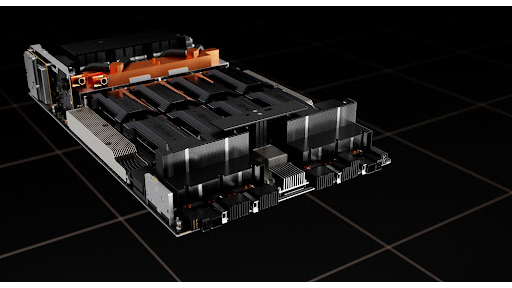

I wish Apple would explain their SOCs in as much detail as Nvidia did with the NVIDIA HGX H100.
To be honest, I don’t see any more information in the Nvidia product Brief than what Apple tells us in their presentation. Sure, Nvidia’s stuff looks more detailed, but it’s because the hardware has more complexity. Apple doesn’t need to connect multiple discrete GPUs together, they don’t support FP64, and their architecture is in general “flatter” and more streamlined. But they did offer some details on how the SoC works, including the basic logical architecture of the GPU cores. We do know for example that an Apple GPU core consists of four 1024-bit wide compute units each capable of executing an independent instruction stream.
