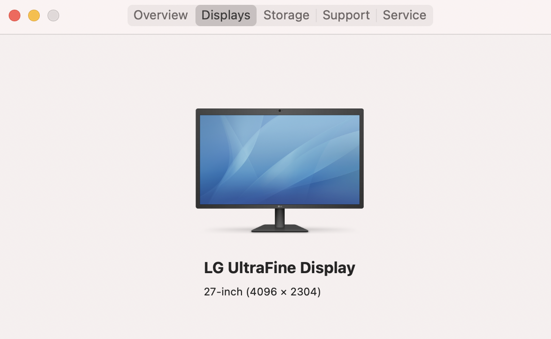

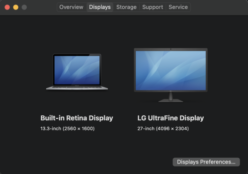

If you go to About this Mac though what does it say? Mine looks like this:-
Okay there is a thread on this. It looks like it is a little twitchy, often get stuck in 4K and you have to switch the cable into the other port a couple of times. I am back at proper 5K now.

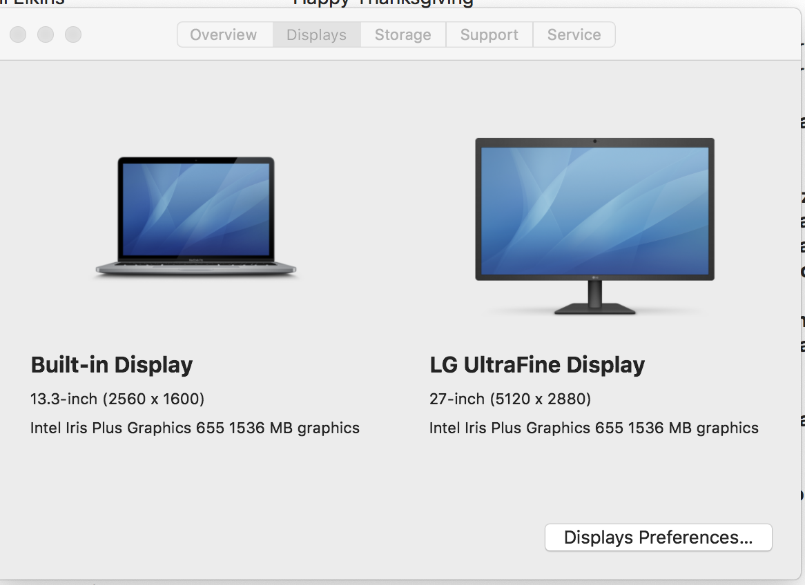

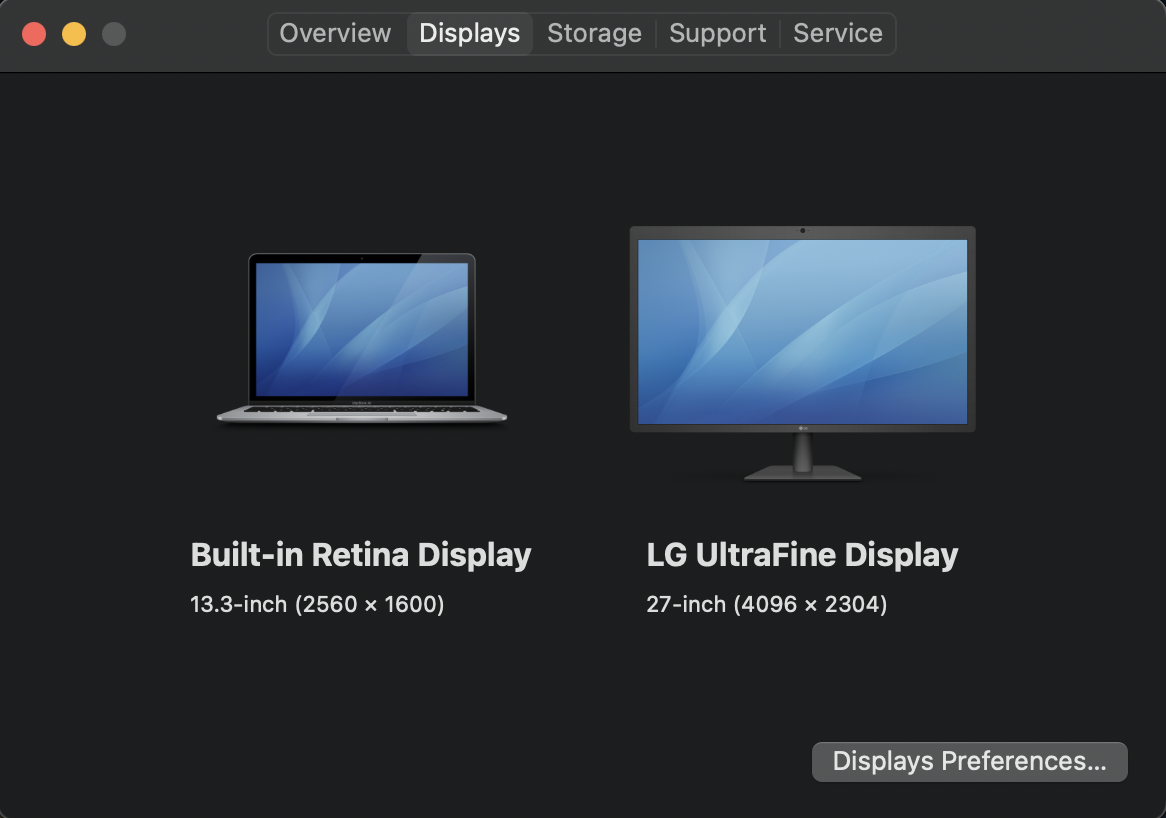

I have the LG 5K display on my 13" MacBook Pro (2018). I get 5120 x 2880 there. See attached.
Can the M1 do that?
Anyone managed to reliably fix this? I've got an M1 MacBook Air and the LG Ultrafine 5K 27MD5KA (1st Gen) running 11.0.1 but only displaying as 4k. Multiple reboots and port switches but can't get it to recognise 5k. Also the LG Screen Manager doesn't recognise the monitor.

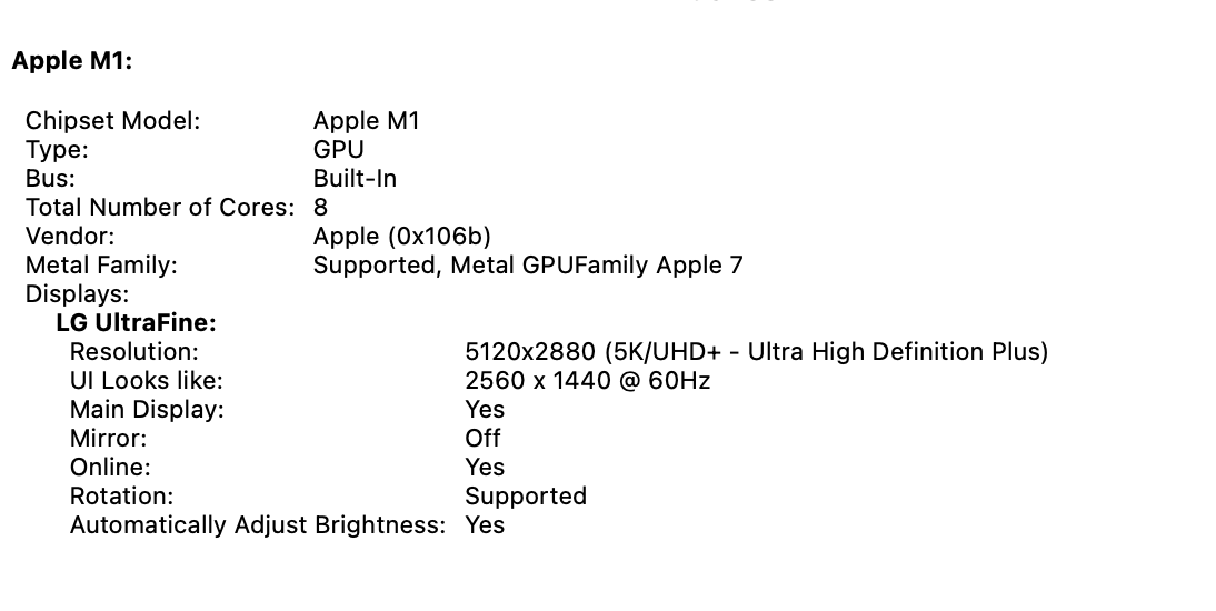

Mine comes up in 5K correctly but LG Screen Manager also doesn't see it.
I had a similar issue. it's probably your cable.
An official apple thunderbolt cable will connect in 5K. A "lesser" usb-c cable connects in 4k. I'm not clear why it even works at all. The first gen LG Ultrafines don't support USB-c display output like the 2nd gen do (like for the iPad).

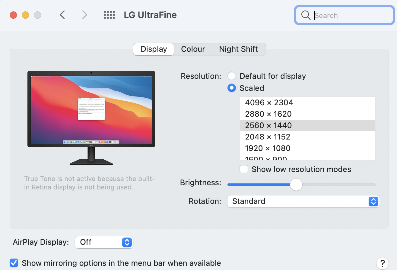

I've tried a few cables without success and never had it display as 5k. There is a bug. I wonder if when you change it to run at 2560 x 1440 if that is true retina or if everything is a little off...

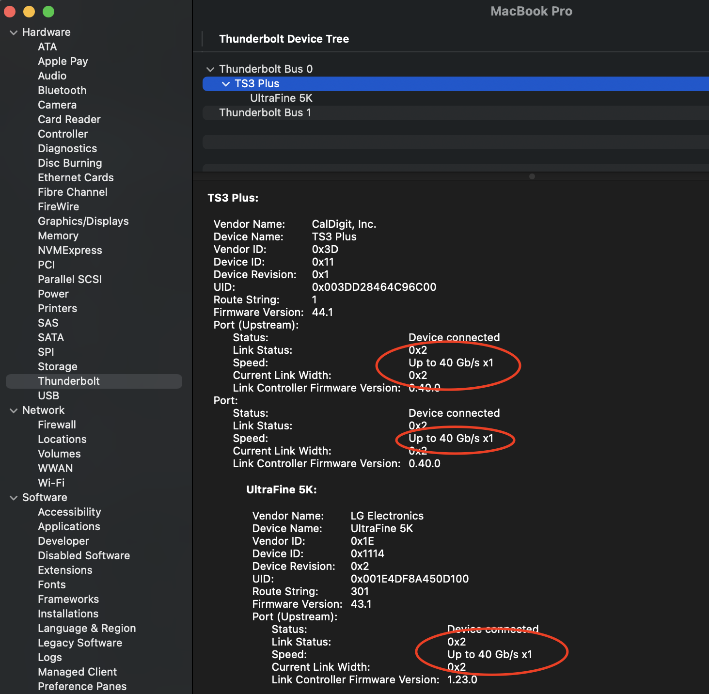

I had issue in which my M1 MBP would only connect to LG 5k ultra fine with 4k resolution. My problem was the cable. TB3 cables actually come in 20Gbps and 40 Gbps. My 20Gbps cable would only drive the monitor at 4k, and when I used a 40 Gbps cable, I could drive the monitor at 5k. Go to "About this Mac" -> "System Report" -> "Thunderbolt" and make sure all of the Thunderbolt connections between computer and monitor are running at 40 Gbps. I have a snapshot below - I'm running through a CalDigit Dock.

Check the Thunderbolt section to make sure the display is connected properly like arfung says. It should be:
Code:
Link Status 0x2
Speed: Up to 40 Gb/s x1
Current Link Width: 0x2
If there is a problem, then maybe connecting the display to a Thunderbolt dock might help?

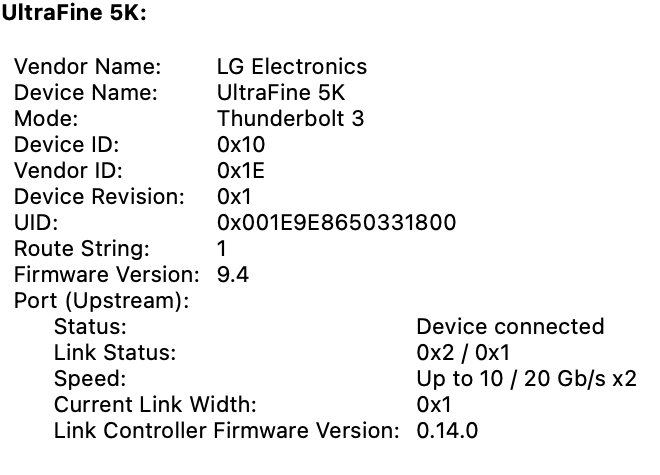

Interesting. I have an M1 MBA and it will only show 2560x1440. Does this mean a problem with the cable, with the monitor, firmware, software, gremlins, or something else?

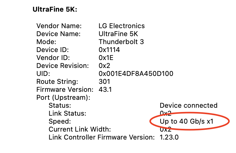

I think it's your cable. Are you directly connected from M1 MBA - LG5k? or, are you going through some kind of dock. Here is my sysinfo. As you can see, speed through my cable is much higher...
So that is connecting with the (Amazon) Thunderbolt 3 cable that was included in the box. It was NOT the one that originally shipped with the monitor, as this was a "renewed" monitor from Amazon.
But notice the dramatic difference in the firmware versions.You have firmware version 43.1 and the Link Controller firmware of 1.23.0. My firmware is 9.4 and link controller firmware is 0.14.0.

Only one of the lanes is working (link width x1) so you're only getting 20 Gbps instead of 40 Gbps. Maybe the cable is broken.
You have a 27MD5KA. Maybe arfung has the second version 27MD5KB which uses a different Thunderbolt controller. Notice his Thunderbolt Device ID is different.
