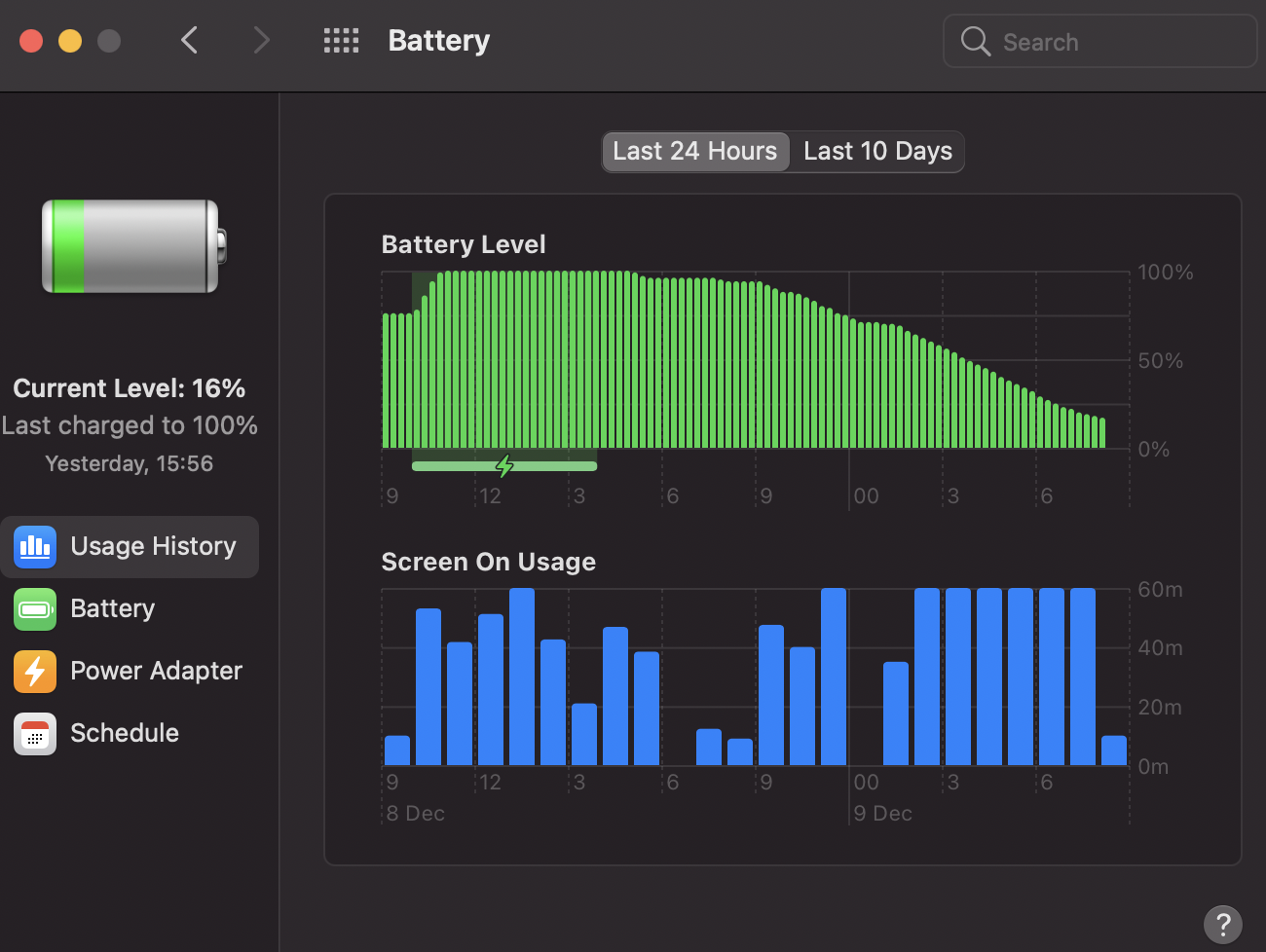

I have briefly tested my MBA M1 and battery life is maybe better than my previous MBP 2019 1.4GHz, but not huge difference. For example just used battery from 100% 83% MacOS reading (79% in Coconutbattery) in 2hour 16 minutes. With my MBP I could get about 1h 30 minutes to 2 hour 15 minutes using the same percentage battery (but it has bigger wattage battery, so a bit more watts used that M1 MBA does). Still I doubt I could get 10 hours of use out of my MBA M1...

What's your normal workload? My MBP M1 is a huge boost to my previous 2017 13, the battery life is almost tripped.
Reactions: LFC2020 and jerryk
Just basic surfing on the internet with maybe 5 tabs open, but I often play music from YouTube using my AirPods. I always use Safari and also installed Wipr to wipe off ads. Display brightness manually set to max -5 clicks.
This YouTube + AirPods used to drain battery very fast in my previous MBP, and it ran rather hot. This MBA M1 is cool al cucumber doing the same but it seems to use battery still pretty much doing that.
I just clocked 2 hours 40 minutes battery is 100 to 75,5% in Coconutbattery (80% macOS reading). So extrapolating that I could get about 10.5 to 11 hours using battery 100% to 0%.
This is quite different from my side, as Youtube playback almost use "nothing". About 1hour and a half, battery only drained 5% on my MBP, brightness is min + 8 clicks, or 50%.

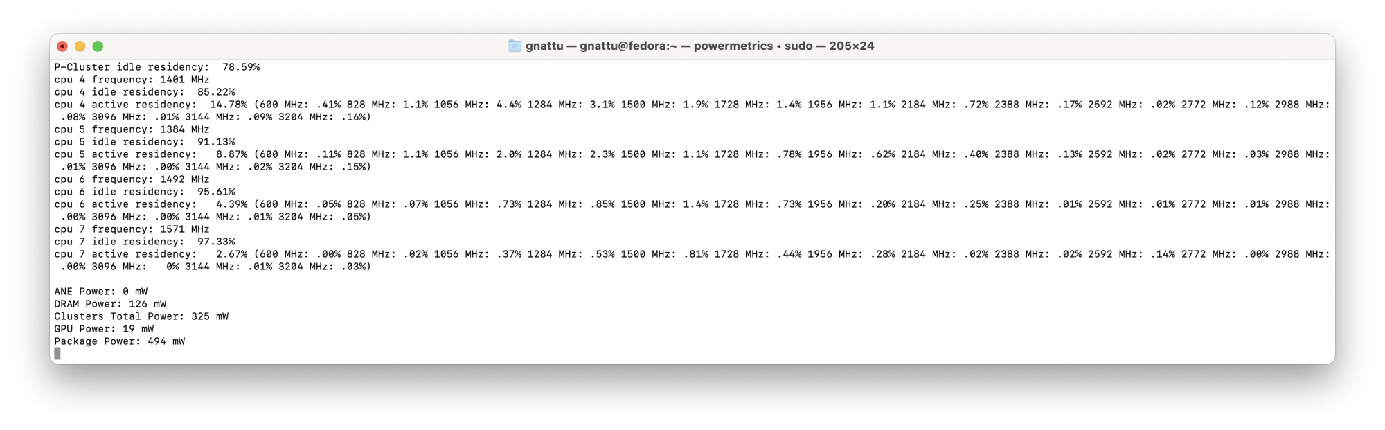

Maybe the panel used by MBA is consuming lots of power? As the CPU is not the most power hungry part in this case(only ~500mW whole package from powrmetrics)
This is taken from playing a youtube video, with 9 tabs open, an Linux VM in the background running VS code server, email apps and IM apps open. The whole package is using less than half watt.
Can you measure it by typing sudo powermetrics -s cpu_power in terminal?
That is incredible low. I just looked at coconutbattery during that and it was around 4-7W. I was using Airpods so bluetooth will use some power then.
Thanks. I need to try that code to see CPU power usage and that will tell if it is LCD panel draining power.
