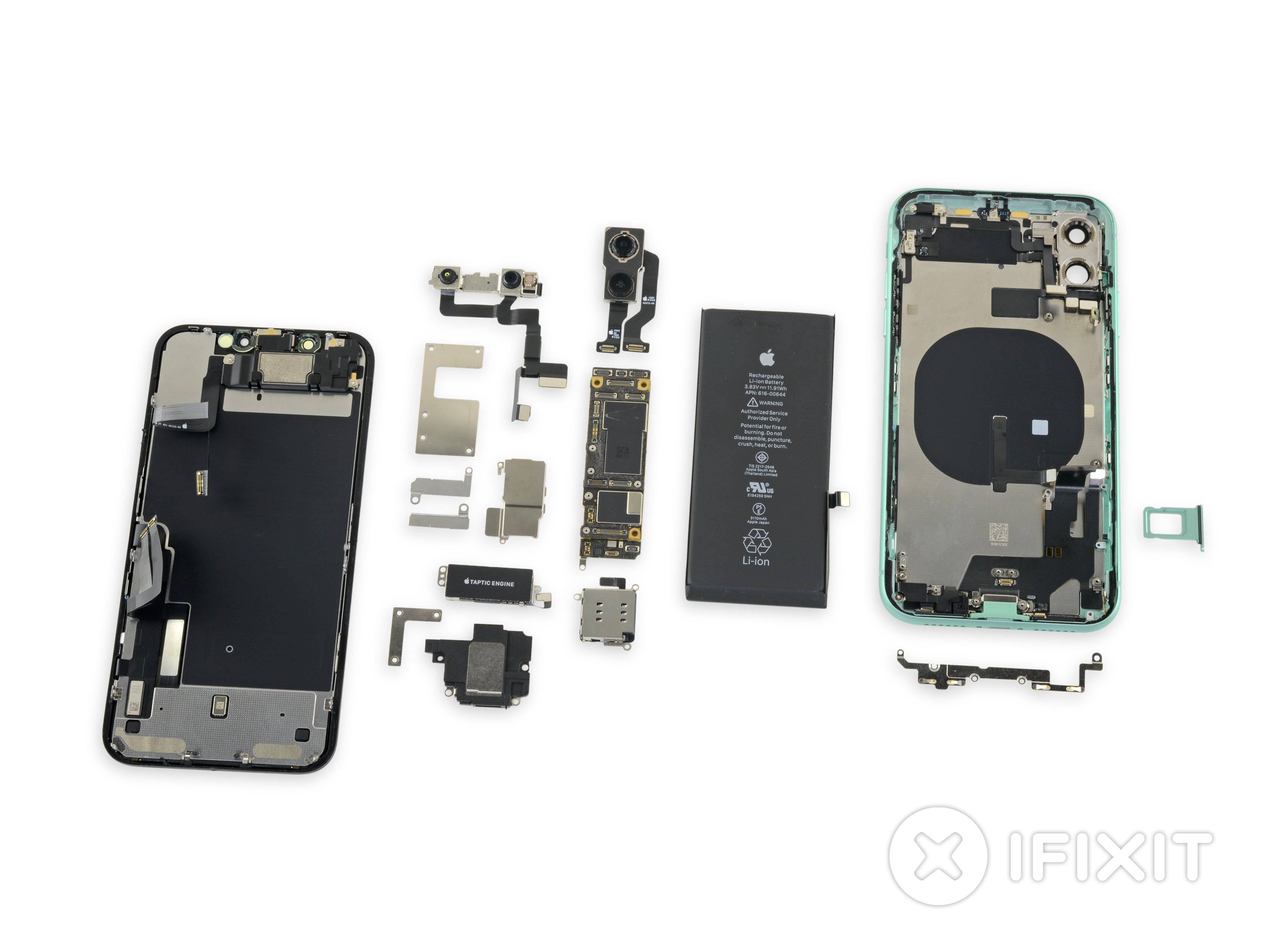

One thing I do find confusing about this is that, according to the pics from the iFixit teardown of the iPhone 13, the A15 chip is pictured as being on the outer surface of the sandwich, not buried within (https://www.ifixit.com/Teardown/iPhone+13+Pro+Teardown/144928)
The paragraph after he talks about it being “bad” to put SoC on inside he mentions complaints of the cell modem throttling . In the ifixit taerdown the modem is on the inside . The NAND storage chip seems like it would cover modem to some extend . Heat from to SoC can so leak through bottom to modem and RF chip area .

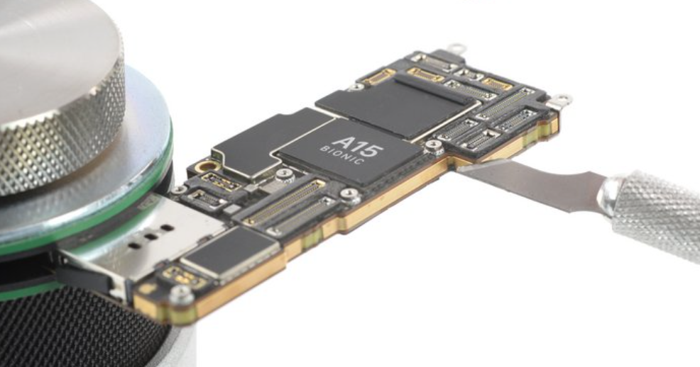

I think that's just a sticker Apple puts on the outside so you can see something marked as A15. Other pictures from the iFixit teardown show the actual A15 SoC package on one of the inner sides of that PCB sandwich.
Reactions: theorist9

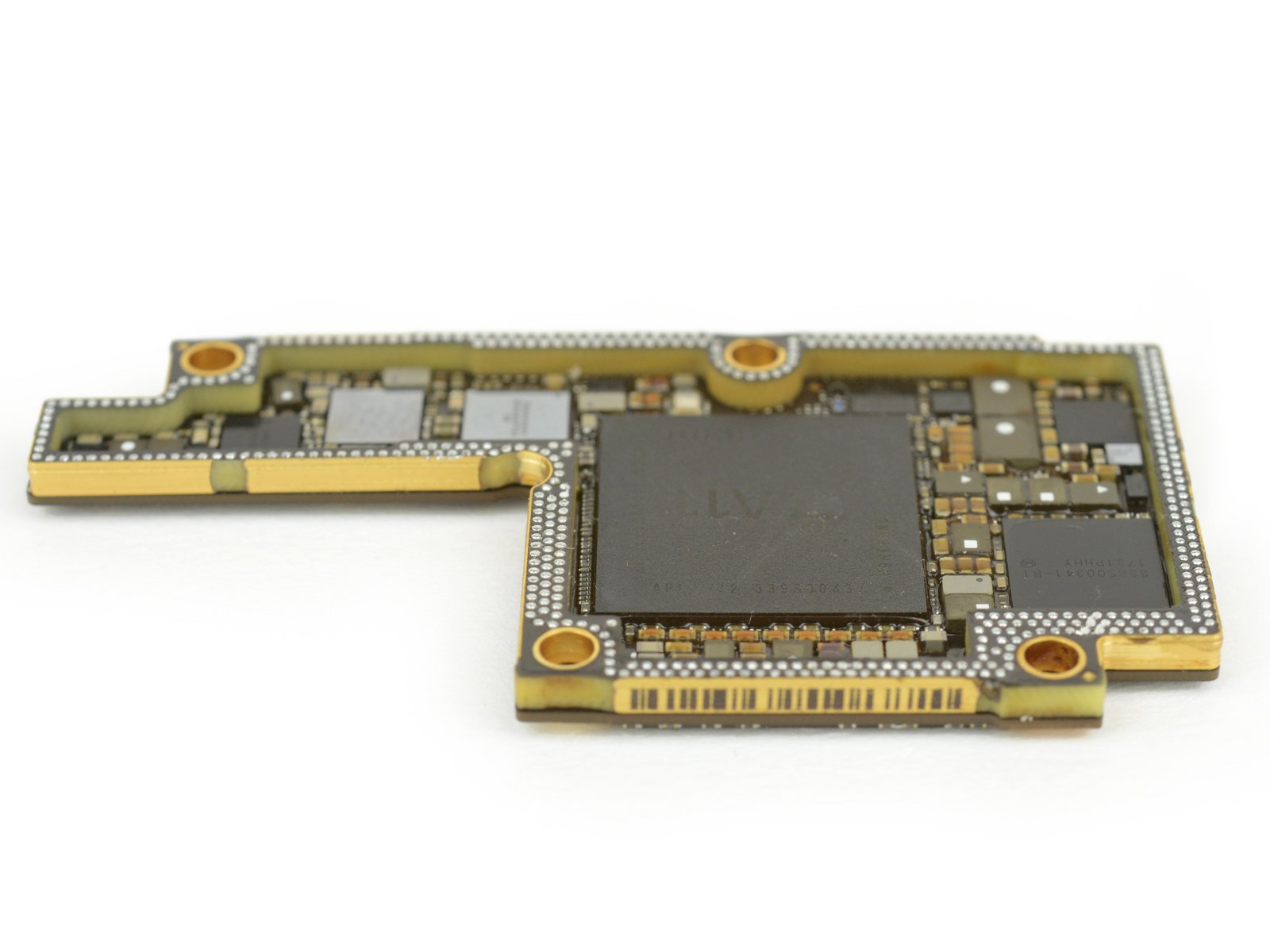

Edit: I had a look at the high res photo. Yeah, I’m wrong. It looks like three PCBs stacked. Is the SoC tucked in that center layer where the gold plating is?!
It's two PCBs stacked and interconnected using a third PCB as a combination interconnect and mechanical spacer. Here's an image showing one PCB plus the spacer PCB the from the iFixit teardown of the iPhone X, the first model where Apple used this design:
Ah that makes more sense. Step 7 is both bottoms . Step 8 both tops ( the NAND chip is blurred to mask the confusing “A15” label. Kind of cuurio had the decipher the vendor if Apple painted over chip )
Very cool! Er… cozy. Well, plenty of heat will dissipate through the vias. I wonder what substrate they’re using.
Good point on the vias. Even if Apple didn't bury the SoC in this kind of board sandwich, they might be the best thermal path. After all, A13/14/15 etc are space-optimized phone PoPs with an entire DRAM package piggybacked on top of the SoC package. If you attached a heatsink to the top of the SoC package, it would have a poor heat conduction path to the SoC die - there's DRAM package encapsulation material, substrate, and DRAM die to get through.

That is exactly my thought pattern. Any thoughts about what substrate they’re using?
Thinking about thermals, I looked at ceramics at first, but it’s dark brown; reminds me of phenolic composites, like old school impedance controlled dielectrics. I wish more youtubers had X-ray spectrometers— maybe someone can airdrop an iPhone to Cody Reeder.

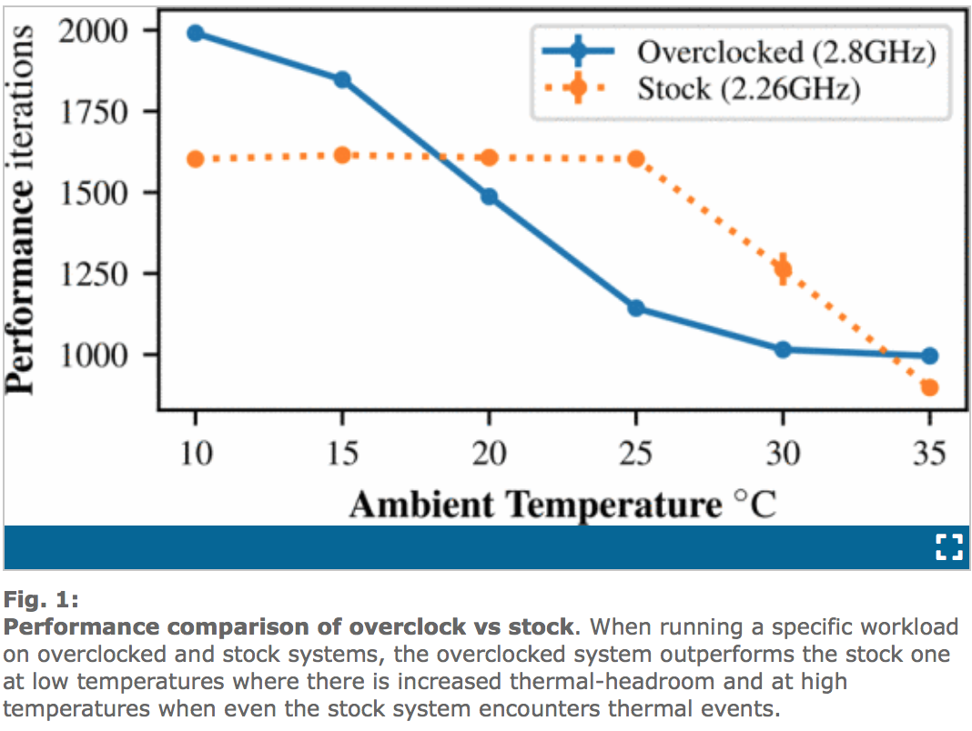

Well, instead of giving me the "Hm", you might have checked the literature. Here's an article from IEEE (about smartphones generally, not Apple specifically) in which they say:
I am not sure whether results from Nexus 6 translate to the latest iPhones. Neither do the authors offer the definition of "thermal throttling" or any source for their claim (they mention the PhoneLab paper but I don't find any discussion of throttling there)
One could easily test this: like do a long sustained performance benchmark (e.g. Wild Life Ultimate) on an iPhone in a warm and in a cold environment and see whether there are significant differences in the reached equilibrium levels.
The last board design I did was probably about 15 years ago, so I'll bow out of speculating about substrate material. Wasn't too involved with substrate choice when I did it, and it's been so long I've forgotten what little I knew. 🙂
Here are the results they show for performance on an unspecified machine-learning workload as a function of ambient temperature. Yes, it's unacceptably lacking in explanatory details (the IEEE peer reviewers were asleep at the wheel here), and the paper should certainly have been better written—but I don't think we need a precise defintion of "thermal throttling" to understand what's being shown here: With the stock Nexus phone, there's a drop in performance when ambient temperature exceeds 25C, due to thermal effects (and the overclocked variant is even more sensitive to ambient temp, as one would expect):
And yes, a Nexus isn't an iPhone, and it would be good to have iPhone-specific data, which I don't. But let's be reasonable here: Isn't it more plausible than not that, if an iPhone's performance on a task is thermally limited, this performance is going to be more reduced at 32C than at 4C (to use the example ambient temps I gave in my last post)?
