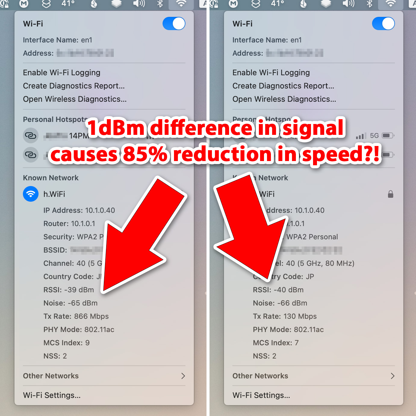

So I've been loving my new m2 Mac mini (base model, 16/512) except for one thing - I cannot seem to maintain a high-speed connection to my wireless access point, despite the fact that my signal strength is 93% (according to Wifi Explorer).
I have an Orbi RBK50 system (router plus two satellites) and I've gone through all of the standard troubleshooting, none of which has helped;
  • Separated the 2.4GHz and 5GHz SSIDs
  • Physically relocated the access point that the Mac is connecting to
  • Adjusted the radio strength from 25% to 50% to 100%
  • Tried DFS channels, as well as 36-44, one by one
  • Switched from HDMI to Thunderbolt for my display connection
No matter what I do, the Mac's wifi speeds are consistently erratic, meaning it varies between 866Mbps (my Orbi's fronthaul max speed) and 130Mbps or so. I'm attaching a screenshot to show this. A 1dBm difference in RSSI causes an 85% reduction in speed! Actually, that's not true - sometimes I've seen it at 130Mbps with even better RSSI and lower noise.
The problem I'm having clearly isn't about signal strength or interference or router placement. Is the M2 Mac mini's awful wifi a hardware issue, or is this something Apple can fix via an update?
edit: just took another screenshot showing equivalent RSSI and less noise than the left side, above, but only managing 144Mbps, rather than 866Mbps. Right after taking this screenshot, the Tx Rate said 585Mbps. Seriously, WTF? These fluctuations are constant, and there's no physical change in my network (interference, physical obstructions like people walking around, etc. Nothing) ... Just constant up-and-down speeds from the Mac mini.

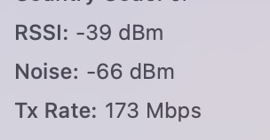

Just sat and watched it for a minute or two, and took these two screenshots about five seconds apart from each other, at the same RSSI and Noise levels, but wildly different speeds. Am I the only one this is happening to?

You mean, besides the fact that my wifi speed consistently bounces between 130Mbps and 866Mbps, despite having a direct line of sight to the wireless AP and signal strength of 93% ... ? Are you saying that's perfectly normal behavior and nothing to worry about trying to fix?

I posted the screenshots above - macOS is reporting speeds between 130Mbps and 866Mbps, at identical RSSI and noise levels, with no physical obstructions between the Mac mini and the AP, etc. That shouldn't be happening (and it doesn't happen on my Windows computer, connected to the same network on the same BSSID). I don't need iPerf to tell me that my speeds are fluctuating - macOS is quite clear about that!

It looks to me like the TX rate moves based on how much data machine is transmitting?
I did a test with my M1 Macbook Pro & Plume setup -- TX rate was ~195mbs idle. Then i started writing a big file to my NAS, and it shot up to 816mbs and stayed near there until i stopped the transfer.
Are you doing sending a lot of upstream data? Most usage i would expect would be downstream, and I don't see the RX rate in the diags?
