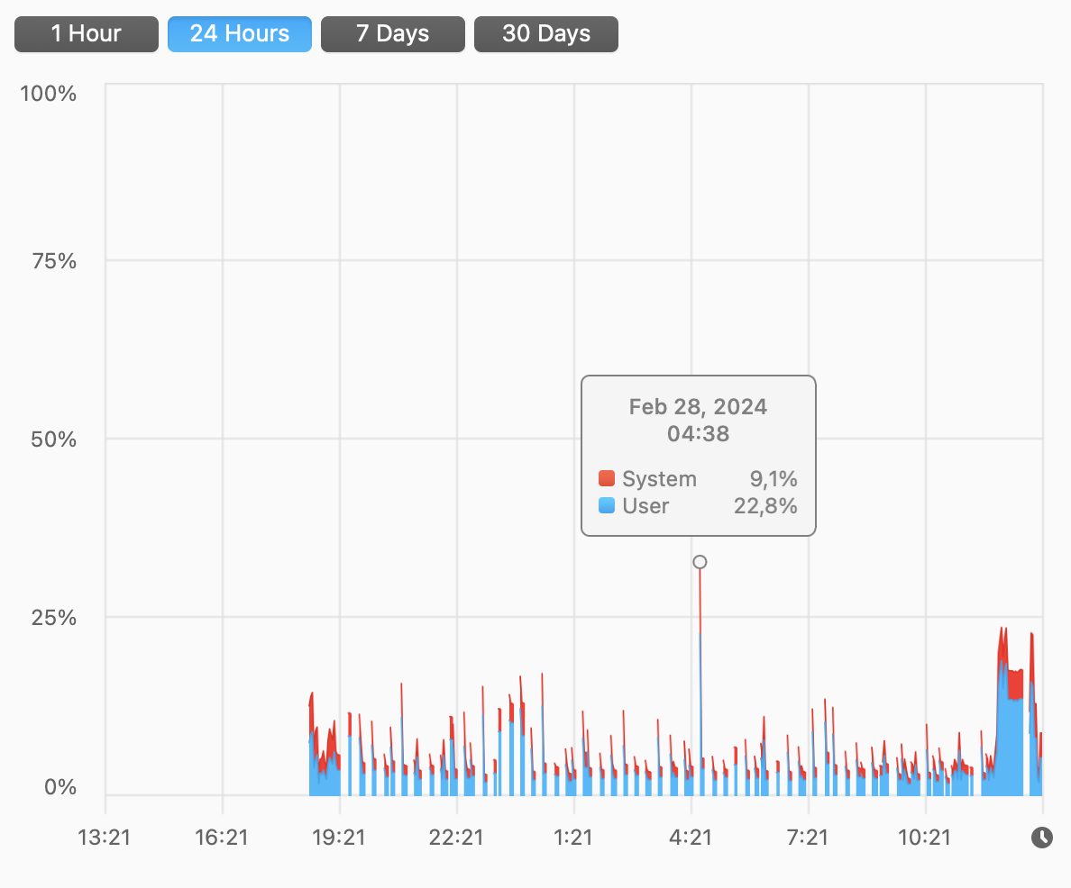

So far nothing much. Apple Support couldn't help me with this. Their guess is that the mac mini seems to be the issue and constantly waking the ASD in the background although the display stays off.
I've installed iStat and had a look at the activities. There was a peak at 4:38 in the night. Tracing back to the console I saw this log at the said time and it refers to some kind of syncing with the Address Book.
Address Book event completed. Changes: 0 (0/0/0). com.apple.message.domain: com.apple.sleepservices.addressbookData
According to iStat there is some sleeping done 😀
It's also a lot of stuff like this:
com.apple.message.domain: com.apple.sleepwake.type com.apple.message.signature: Deep Idle com.apple.message.signature2: Maintenance Sleep com.apple.message.result: pass com.apple.message.summarize: YES
com.apple.message.domain: com.apple.sleepwake.waketime com.apple.message.waketime: 1277.437875 com.apple.message.waketype: Dark Wake from Deep Idle
Most of the time it's Mail and Contacts syncing or doing something in the background. Sometimes it's Dropbox but less frequently.
