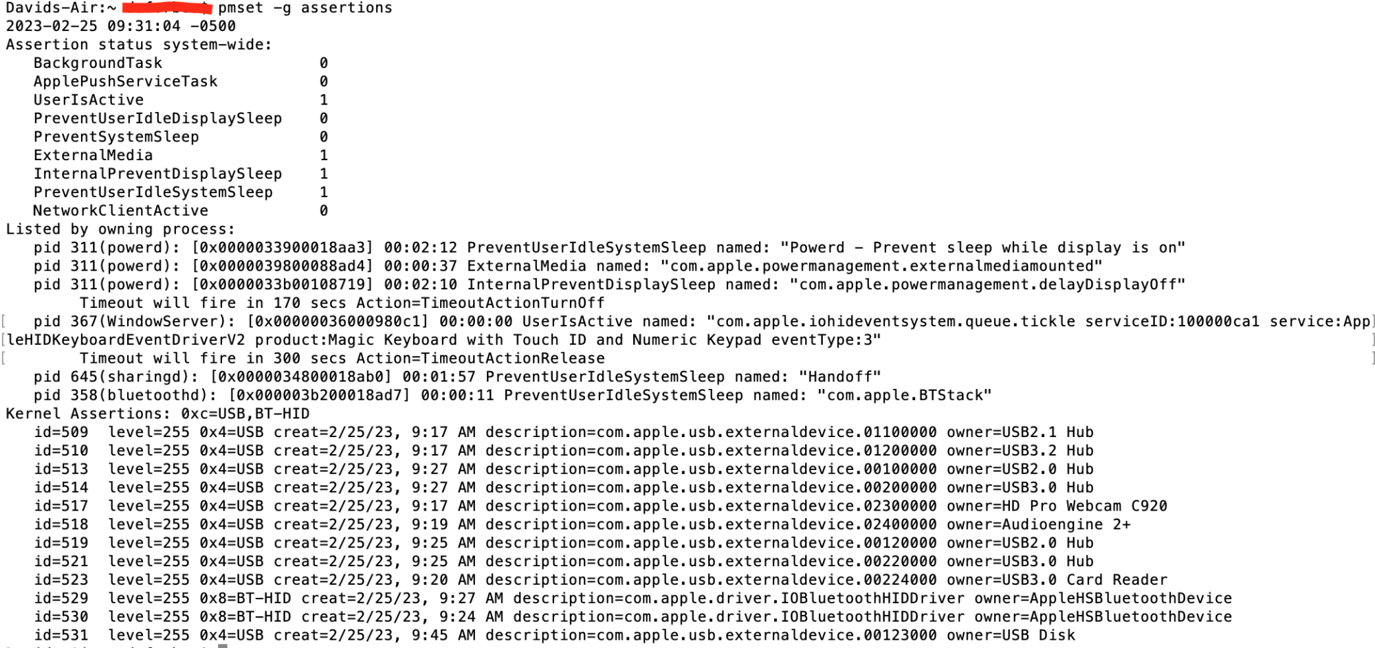

Hi. This is different from the other Mac Mini sleep discussion. I've had my M2 Mac Mini for a few weeks and love it, except it will not go to sleep when I choose "sleep" from the menu. It worked for a few days, then was intermittent, but now has completely stopped. I have two external 27 inch Dell monitors but they don't seem to be the issue.
  1. In Energy Saver, everything is unchecked (put hard drive to sleep, wake for network access, and start up after power failure)
  2. There are no processes running in the background that are doing this that I can find in the Activity Monitor
Any other suggestions?
Thanks.
Does it go to sleep at the time set in Lock Screen settings for "turn display off when inactive"? (Make sure that setting is longer than the screen saver setting).
Also check System Settings->Displays->Advanced->Energy (set "prevent auto sleeping when display is off" to off).
Do you run both ethernet and wifi turned on? I ask because my monitor delayed entering power saving mode at the set time until I enabled wifi. So wifi is somehow connected to sleep issues on the mini (at least my M2 mini Pro).
I don't use a screen saver. I only have wifi, not ethernet. I'll try some of these and let you know. Thank you for the help.
There are no changes I make in the System Settings that help.

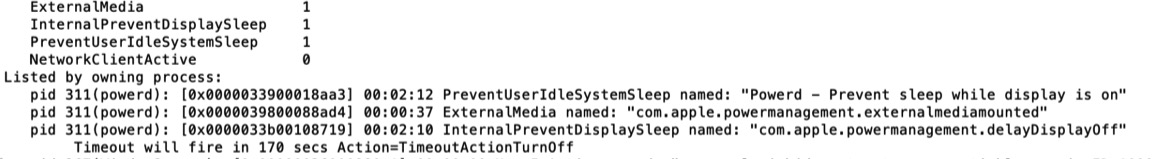

I did run the terminal command @Basic75 suggested. But I don't know what this means. I have a USB drive plugged in for 3D printing but that's not usually there when I put it to sleep. I don't know what the InternalPreventDisplaySleep or PreventUserIdleSystemSleep means, or how to change them.
