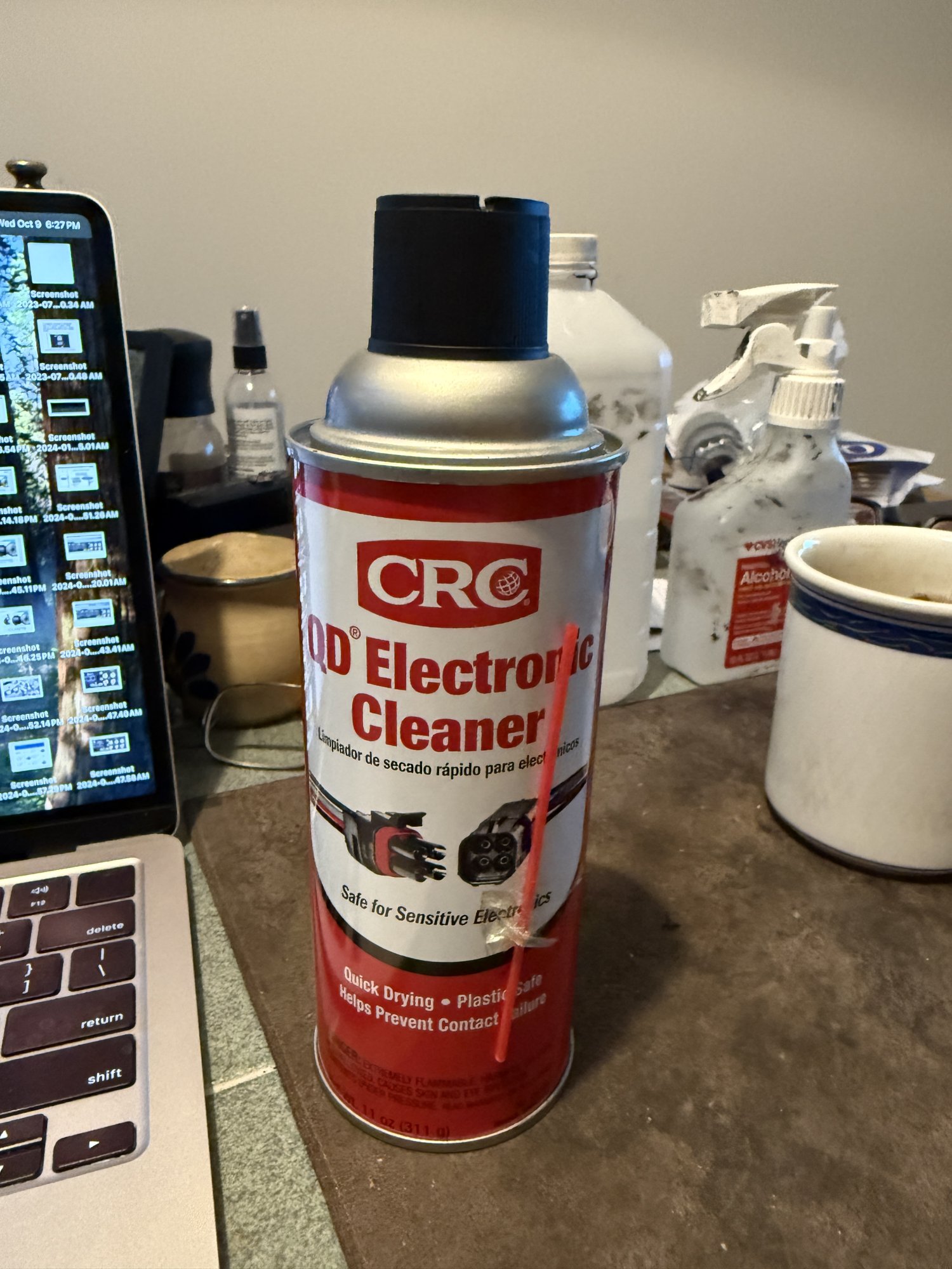

So, I sprayed a tiny bit of this stuff into the edges of the trackpad and damn, if it isn't working great again, for an hour so far. We'll see how it does tomorrow after it is totally dry although this stuff is so volatile is really should be gone already. I won't call this solved until tomorrow... and I guess I'll have a spare trackpad when the one I ordered comes next week.
Reactions: Jhonjhon236
Well, the CRC spray turned out to be a fail. The trackpad worked great for awhile but now I have just the opposite problem. Instead of being sticky and not clicking the taps register and the haptics fire off far too easily even when set to "firm", making the trackpad almost unusable. Maybe the thing had some dielectric grease in there that got dissolved? IDK. So, back to waiting for the new part. LOL.
Edit: so, I gave it a tiny bit of silicone spray into the edges of the trackpad and that has helped tamp down the sensitivity. Not sure if that will persist, or maybe even get sticky again, or what. I am still expecting to have to replace the thing, but you never know. Maybe I'll get lucky.
