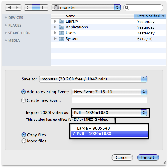

What exact editing application have you used then to edit HD in Mac OS X?
If you have used iMovie, have you made sure to set the resolution to full before import?

As for settings all my videos are imported using "full 1920 by 1080" unfortunatelly the finished product never looks like the original....very sad apple needs to fix this fast or risk users sticking to windows for there HDvideo needs.
