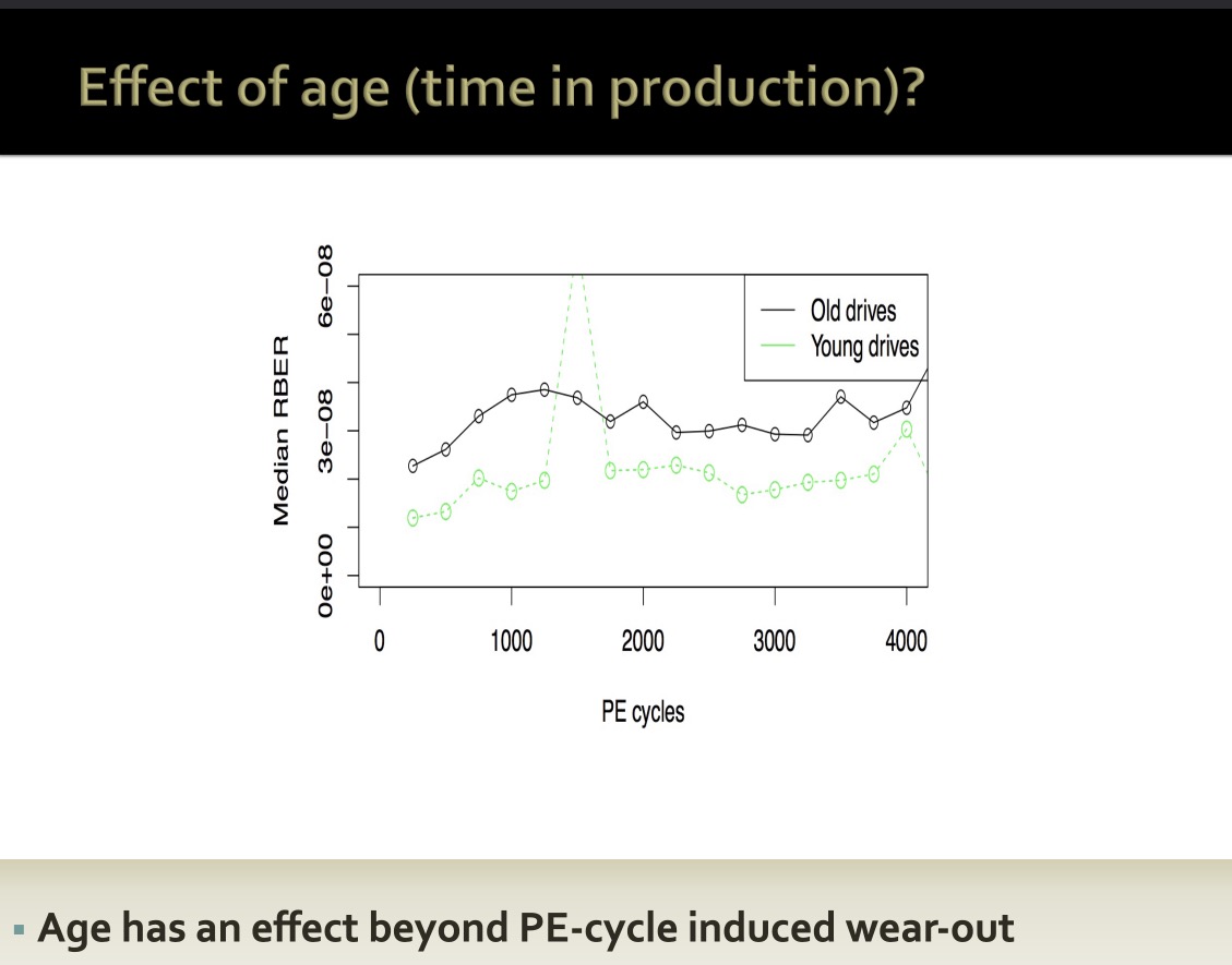

Google and University of Toronto did a multi-year study on SSDs used in Google's data centers and found no change in the failure rate of their SSDs when they hit their rated lifespan (3000 PE Cycles in the chart). While the lifespan consumed number didn't predict rate of failure, the older a drive was regardless of how much it was used was correlated with a significantly higher failure rate. Bear in mind, the total failure rate in this study was 1-2% so even with that significantly higher failure rate, we're still talking about small numbers.
This study was published in 2016. SSDs have only gotten more reliable since then.
https://www.usenix.org/conference/fast16/technical-sessions/presentation/schroeder
Your chart is missing a lot of information and all DRIVES DID NOT HAVE A PE RATING OF 3,000.
Most notably, 40% of the drive models in this study had a PE Cycle rating of 100,000 and 20% had a rating of 10,000. So extrapolating your conclusion from the 4,000 PE Cycle chart is misleading at best. The chart you posted does however show that the age of an SSD does have an effect beyond just PE Cycles and that's exactly what the chart was used to demonstrate in the study.
Reactions: IG88
