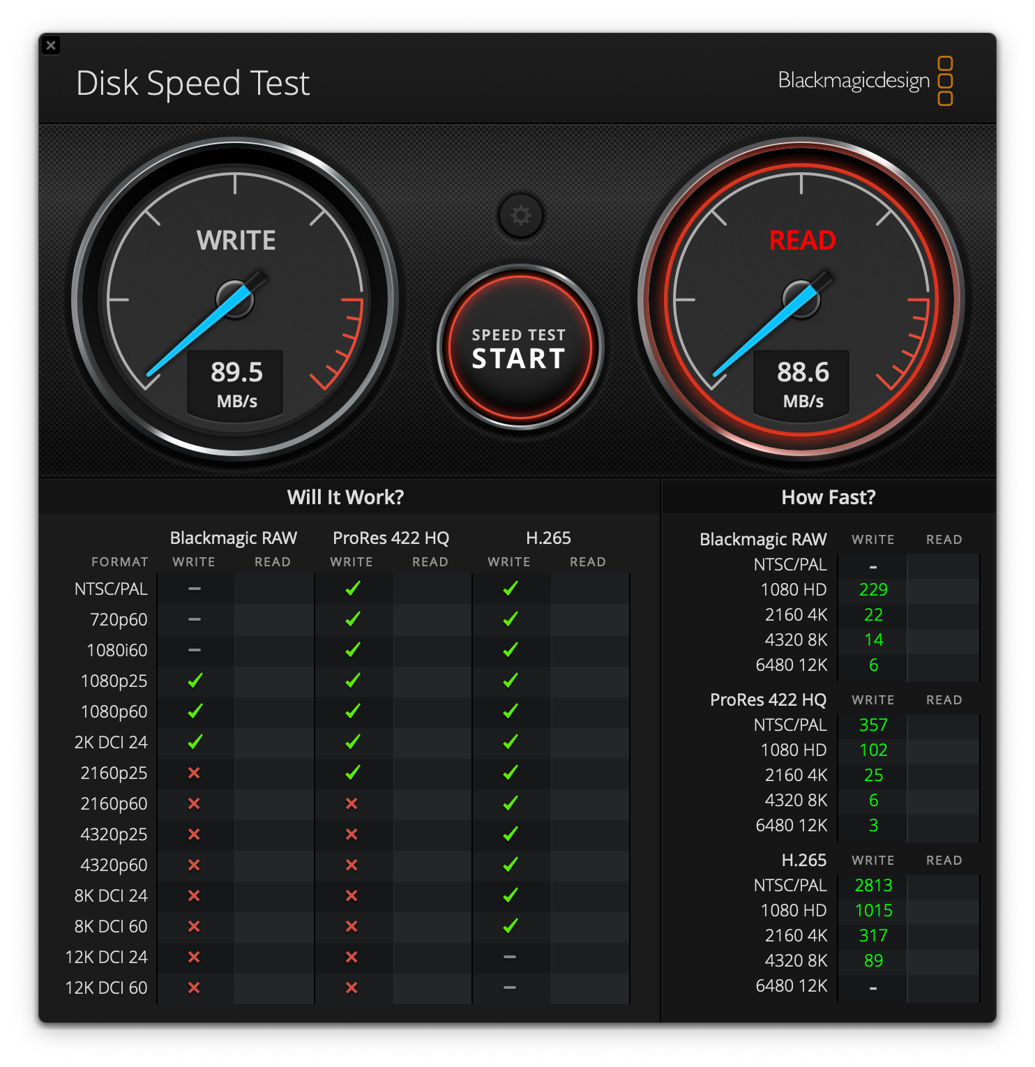

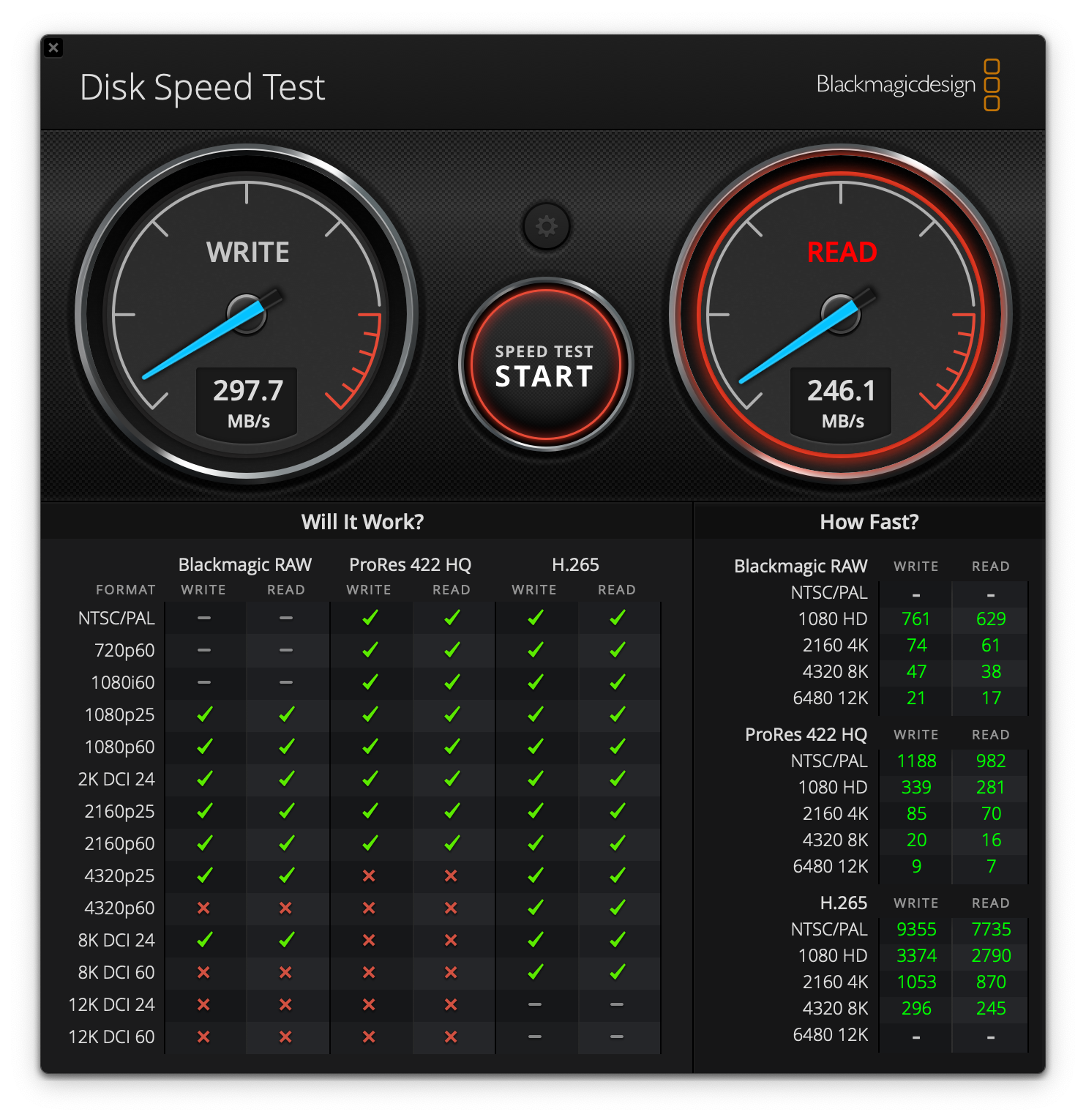

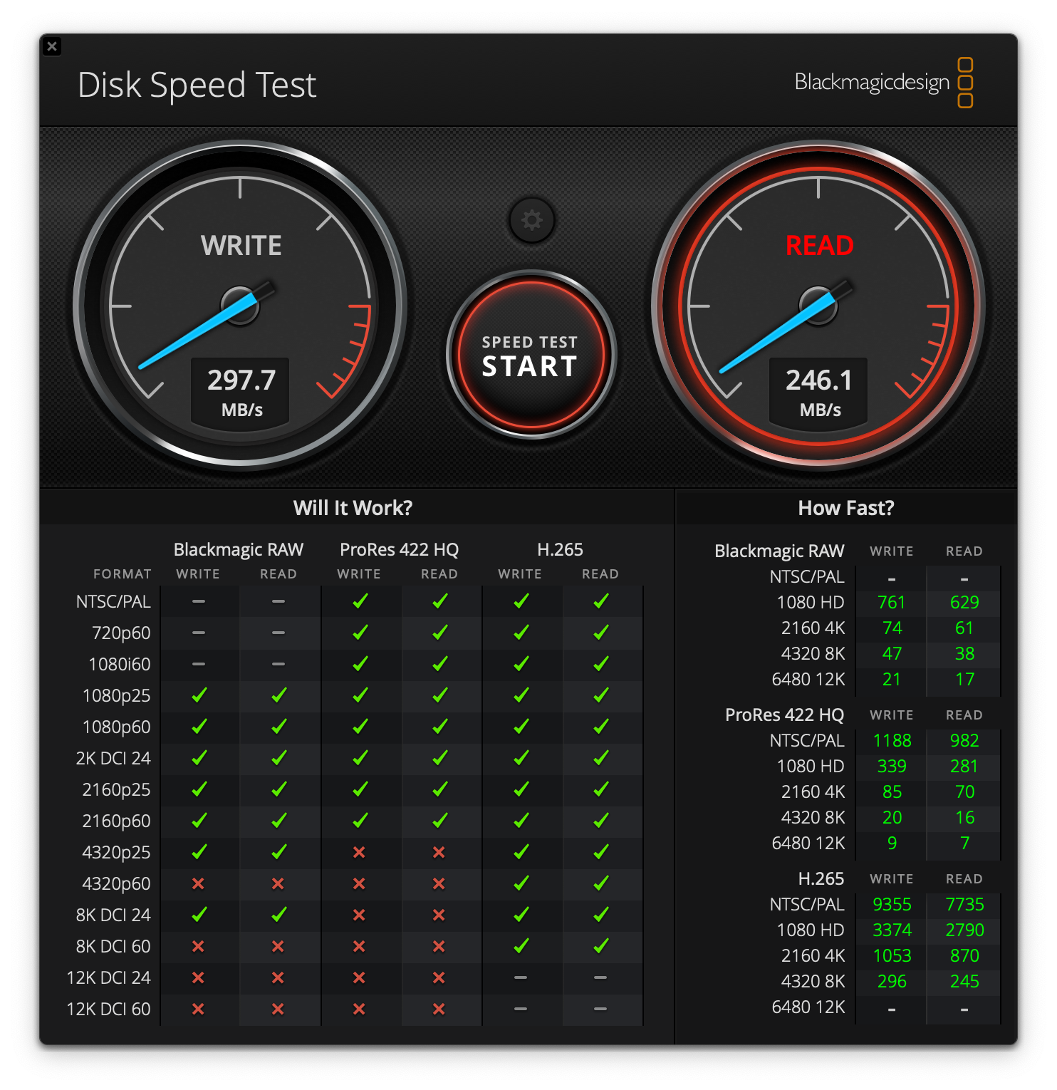

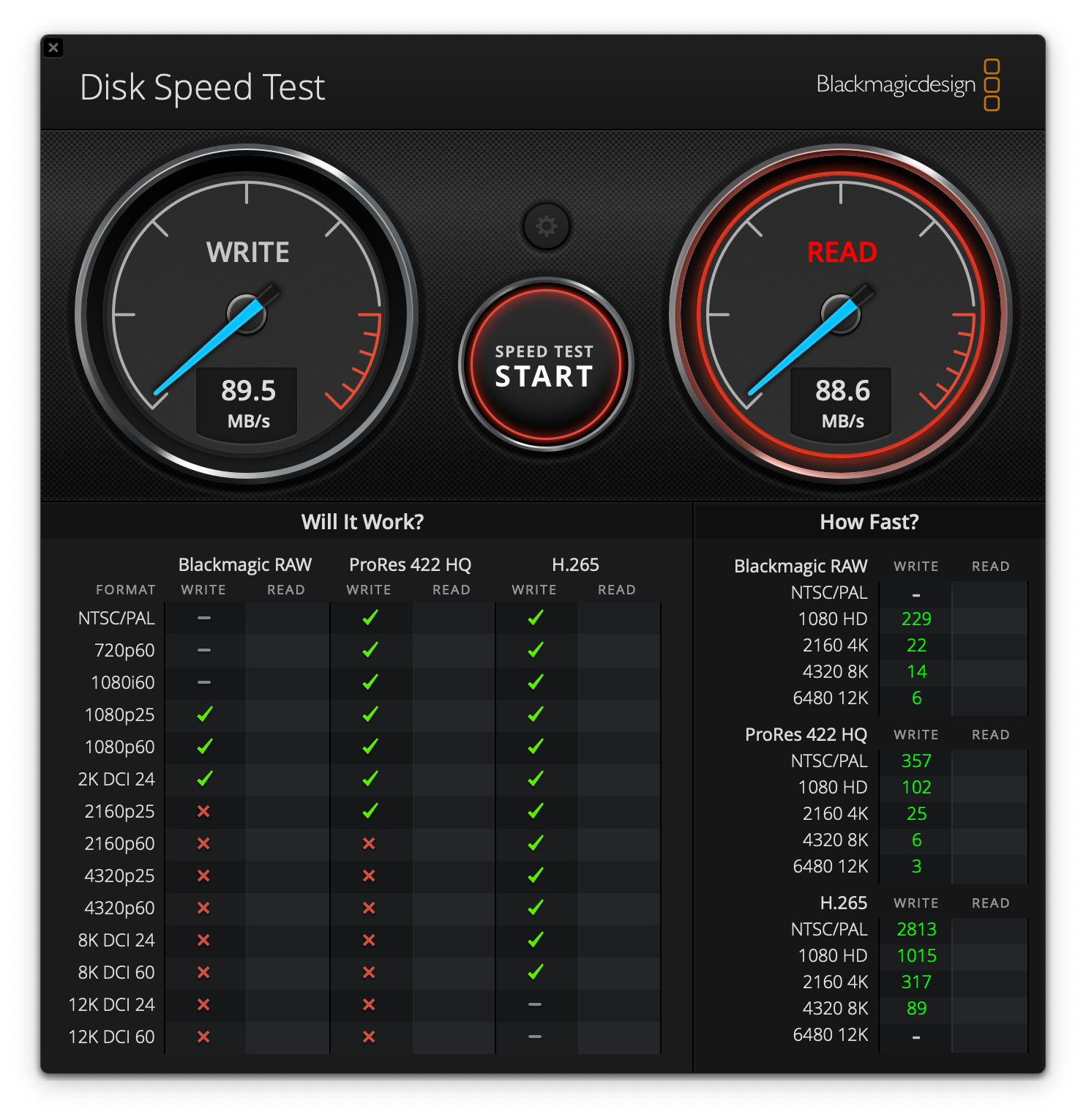

I can tell you exactly.
Software used: Black Magic Disk Speed Test, 2GB read/writes. Difficult to time the screenshot, because the "READ" stays red and it starts cycling to the "WRITE" next, so once the "READ" red circle was full and it briefly paused, I took the screenshot.
Hardware used: 14" MBP M3 Max 16/40 64GB 2TB built-in SD card reader
SD Card results for UHS-II and UHS I:
Sandisk Extreme Pro 64GB 300MB/s UHS-II: 297.7 MB/s write | 246.1 MB/s read
Sandisk Extreme Pro 128GB 170MB/s UHS-I: 89.5 MB/s write | 88.6 MB/s read
