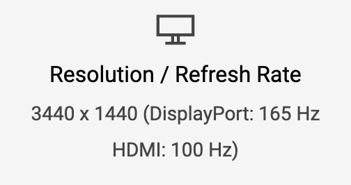

I was able to do some searches including DSC. I came up with.Alienware 4K 240hz through HDMI
Perhaps you quoted the wrong link? Alienware AW3423DWF only supports 165Hz natively via DP.
