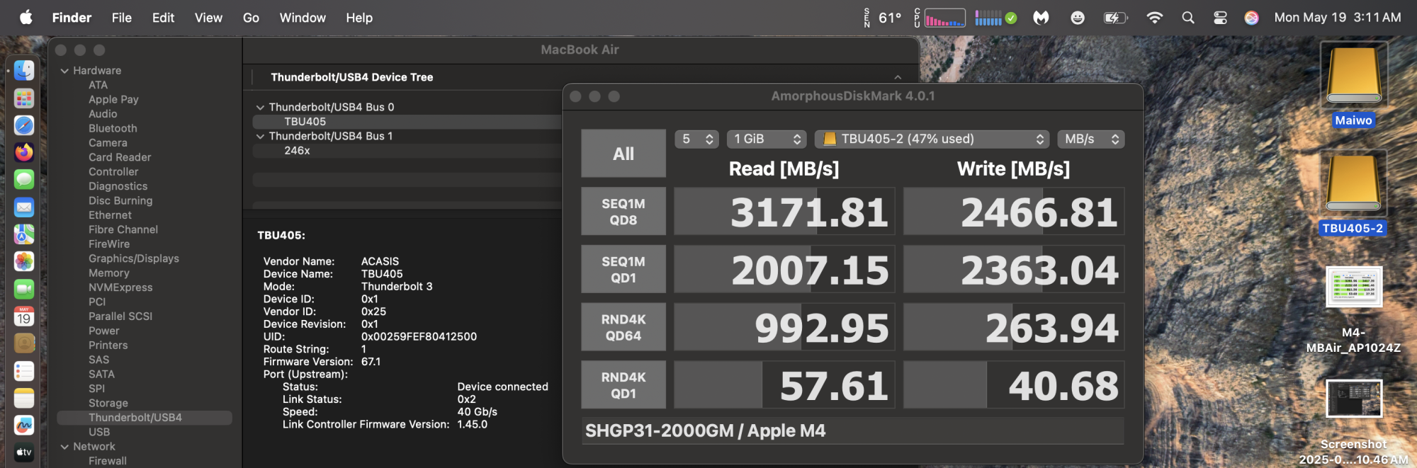

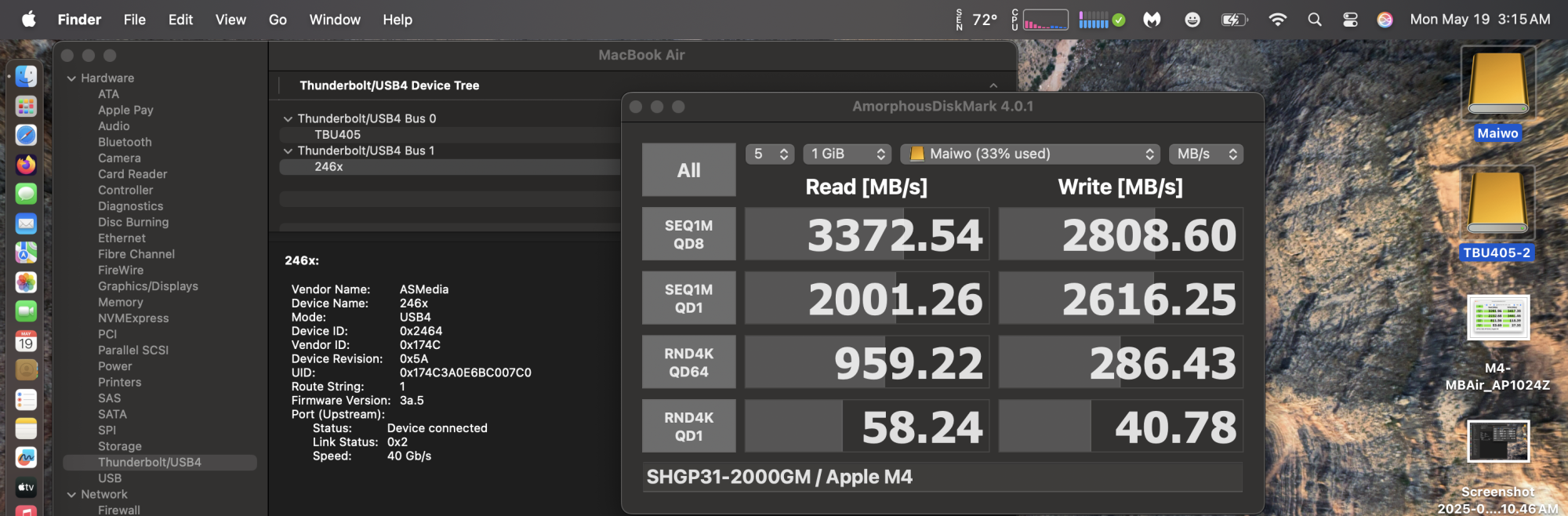

Just managed to get to seeing how my new 13" M4 Air BTO w/70W charger handles these things.
Interestingly, I can attach and use both my Acasis TBU405, and my Maiwo 1695, with/without the charger.
Reactions: Brian33

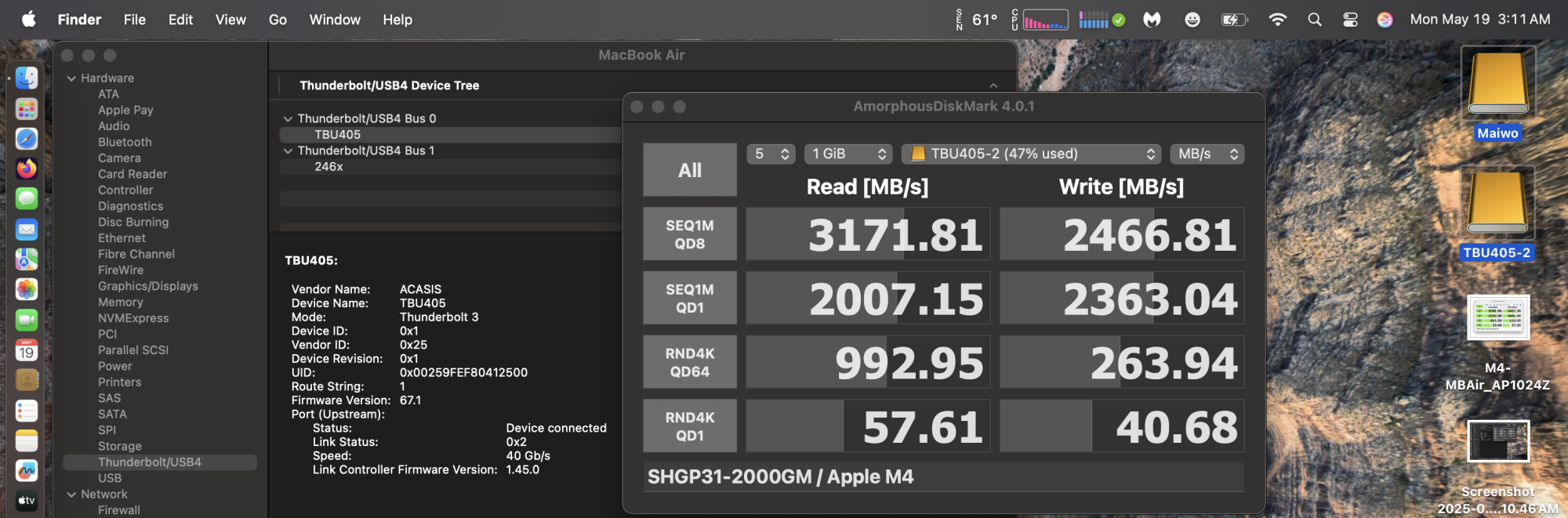

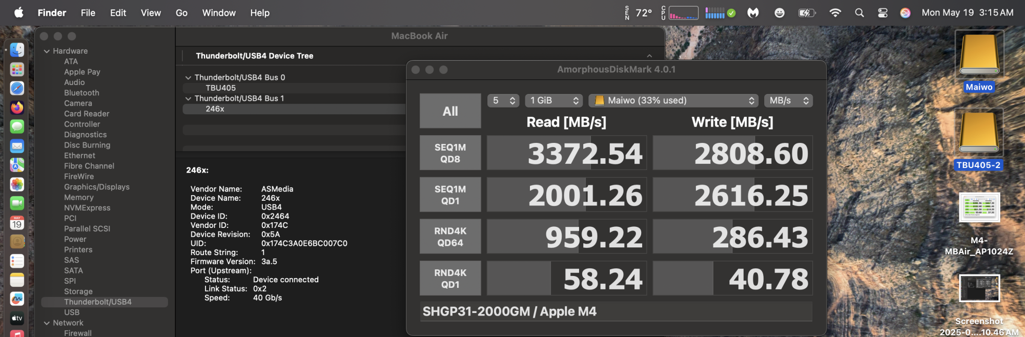

So, "USB4" on Apple Silicon.
A little backstory to the fore-posted screenies.
When I finally got-around to testing these dual externals (at the same time), one was listed as populated at 40Gb/s on the Thunderbolt/USB4 Bus(x), and one was listed as being populated at 10Gb/s on the USB 3.1 Bus.
I disconnected each, in succession, and randomly, yet the channel-partitioning status stayed the same (even with multiple access of About This Mac > More info...).
Only when I went to AmorphousDiskMark did the USB Bus external find-ground. The "10 Gb/s USB" Maiwo started pumping-out 2Tb/s readings via ADM! And, it had switched to populating the Thunderbolt/USB4 Bus(x)!
As with all ASM2464PD devices (that I have found (I've only used two variants, so what makes me an expert?)), the internal switching seems to initially (?) default to Lowest Common Denominator switching.
It usually takes a bit of tickling/nudging to get these multi-format devices to negotiate their Crown Speeds 😉
It may be that the USB4 devices are better-able to negotiate the ebb-flow of the power limitations/requirements in the AAPL Silicon USB4/TB busses (?)
