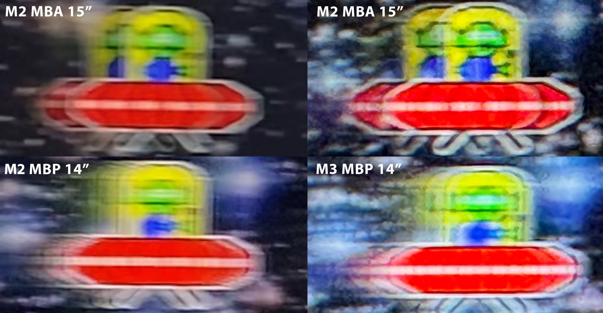

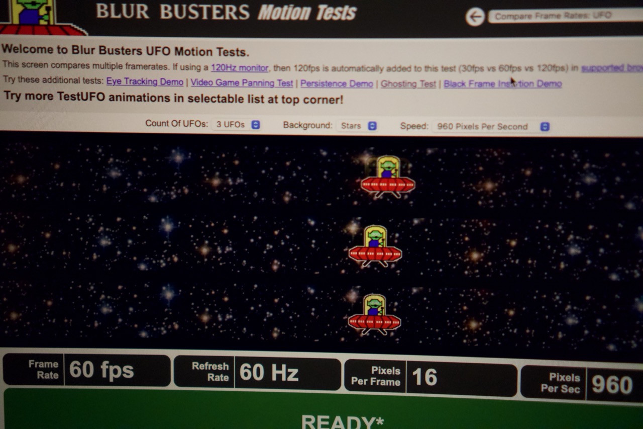

OK, I did some quick BlurBusters tests in the store today, and compared them against some images I took of the M2 models with the same technique(*) back in July 2023.
The left column shows the images from July, comparing the M2 MBA 15" (at 60Hz refresh) against the M2 MBP 14" (at 120Hz refresh). Note these images were on an iPhone 11 Pro, so the photo quality is different.
The right column shows the images from today, comparing the M2 MBA 15" (at 60Hz refresh) again for reference, against the M3 MBP 14" (again, at 120Hz refresh). These were taken with an iPhone 15 Pro.
As you can see, the M2 and M3 MBP 14" UFOs look very similar. I don't see any big degradation in response time. Arguably it's very slightly worse. To the naked eye, the M3 MBP 14" did not seem any more blurry than the last generation did, which is to say, absolutely nowhere near as clear as any gaming monitor or OLED - but still usable.
Scrolling white text on a black background shows the usual small trails, but not noticeably worse than the last generation.
So the NotebookCheck review may have been due to unit-to-unit variation or something else. Another possibility is a difference between the base M3 model (which NotebookCheck reviewed) and the M3 Pro model I saw in the store, but that seems unlikely.
(*) Technique: Open Safari, open Settings. Turn on 120Hz mode by turning on "Show features for web developers" under Advanced, then going to Feature Flags, searching for "60", and turning off "Prefer Page Rendering Updates near 60Hz". Navigate to https://blurbusters.com/category/testufo/ and click the button to open full screen. Set brightness to max. Take a photo or video with your iPhone while moving the phone from left to right to follow the UFOs so you get one in focus. If you have a camera app that gives you manual shutter speed control you could also keep the phone in one position, but you'd need to set the shutter speed pretty fast, e.g. 1/200s or faster.

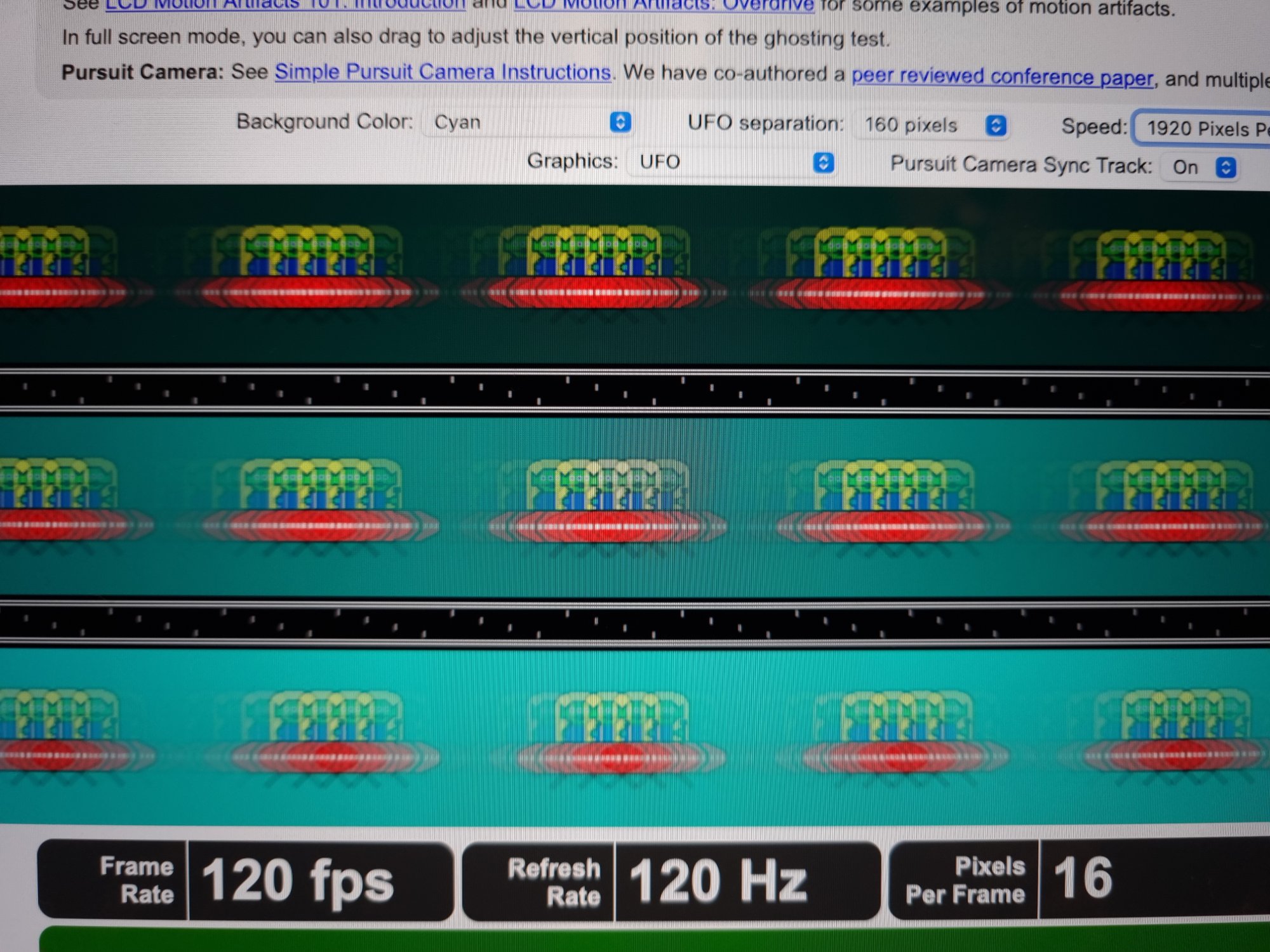

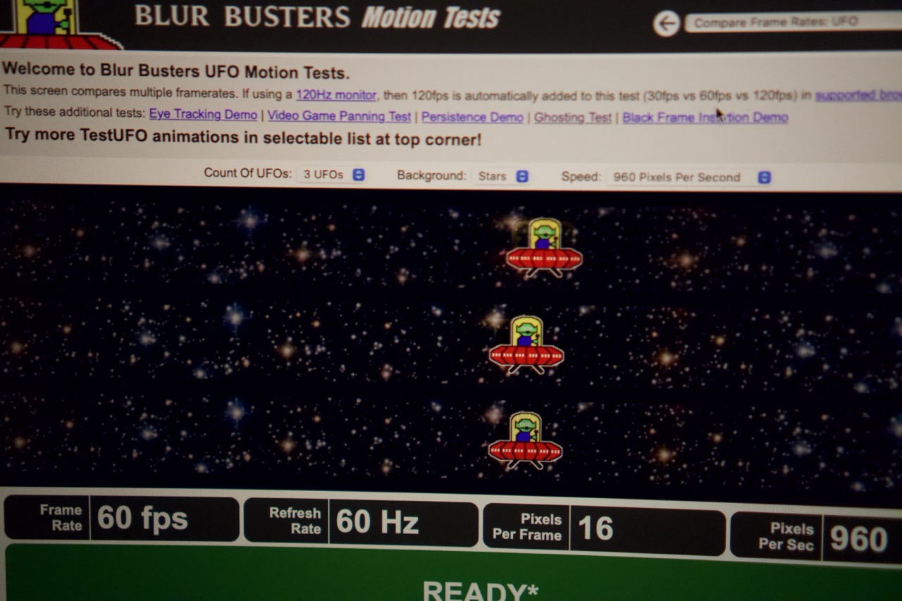

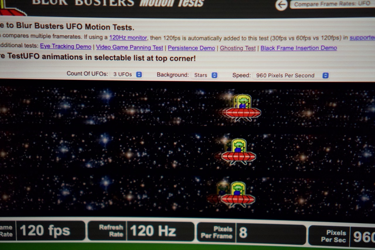

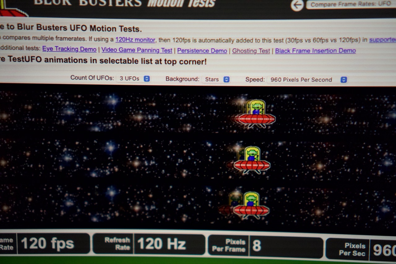

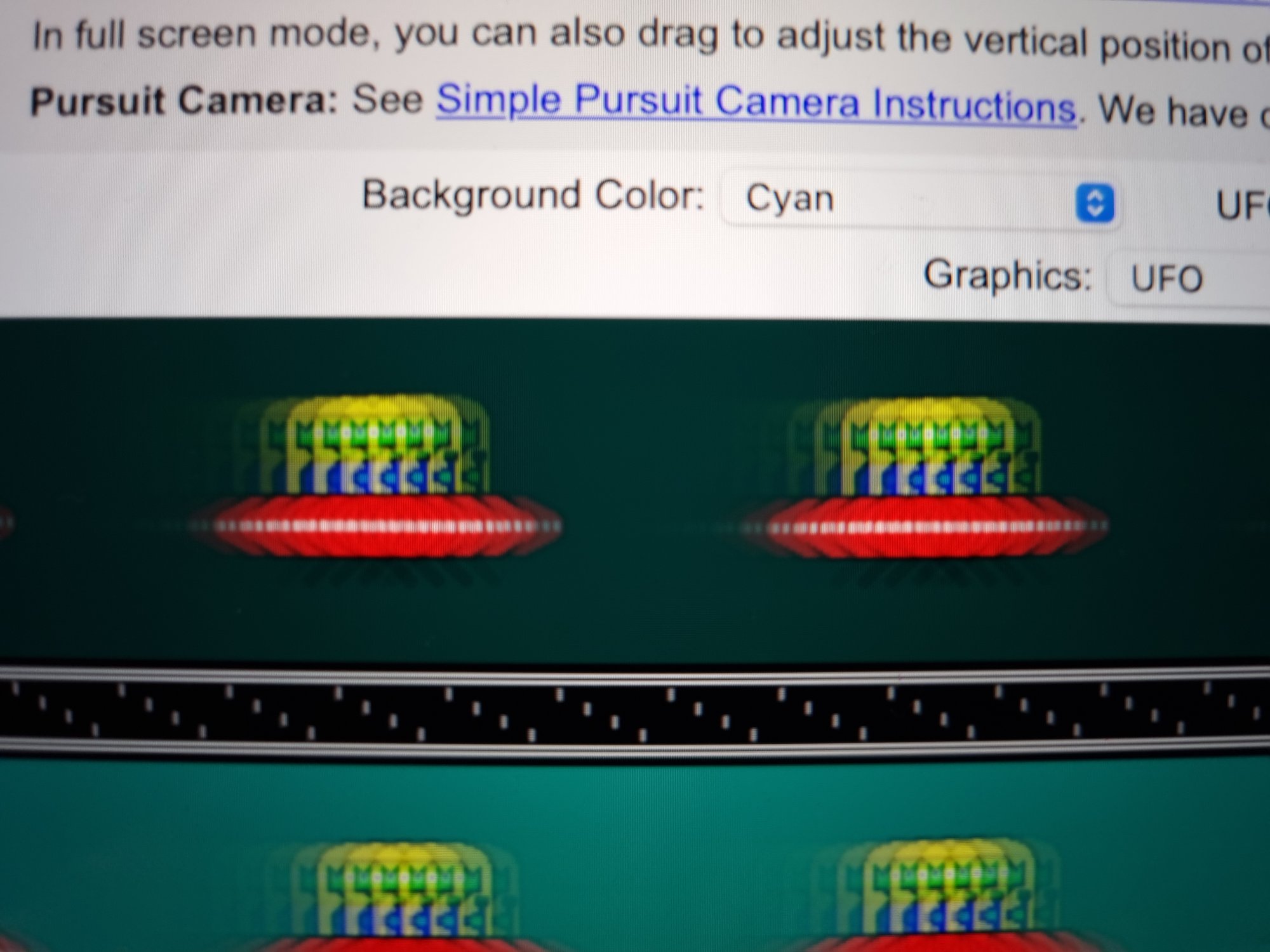

If you are interested, just took a photo with my DSLR, shutter speed set to 1/4000 (fastest my Sony a6400 can do)
Technique as above
MacBook Pro 16 with M3 Pro
Reactions: CloudsNeverDie
Technique as above
Great job, very informative. We can see at most two ghosts, which suggests the response time is around 2/120 = 17ms (just a rough estimate, could easily be anywhere from 15 to 25ms). More evidence that there's something up with NotebookCheck's review.
It would also be really interesting to see a comparison against an M2 MBP, or even a 2019 MBP (notorious for poor response times).

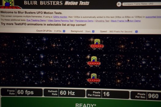

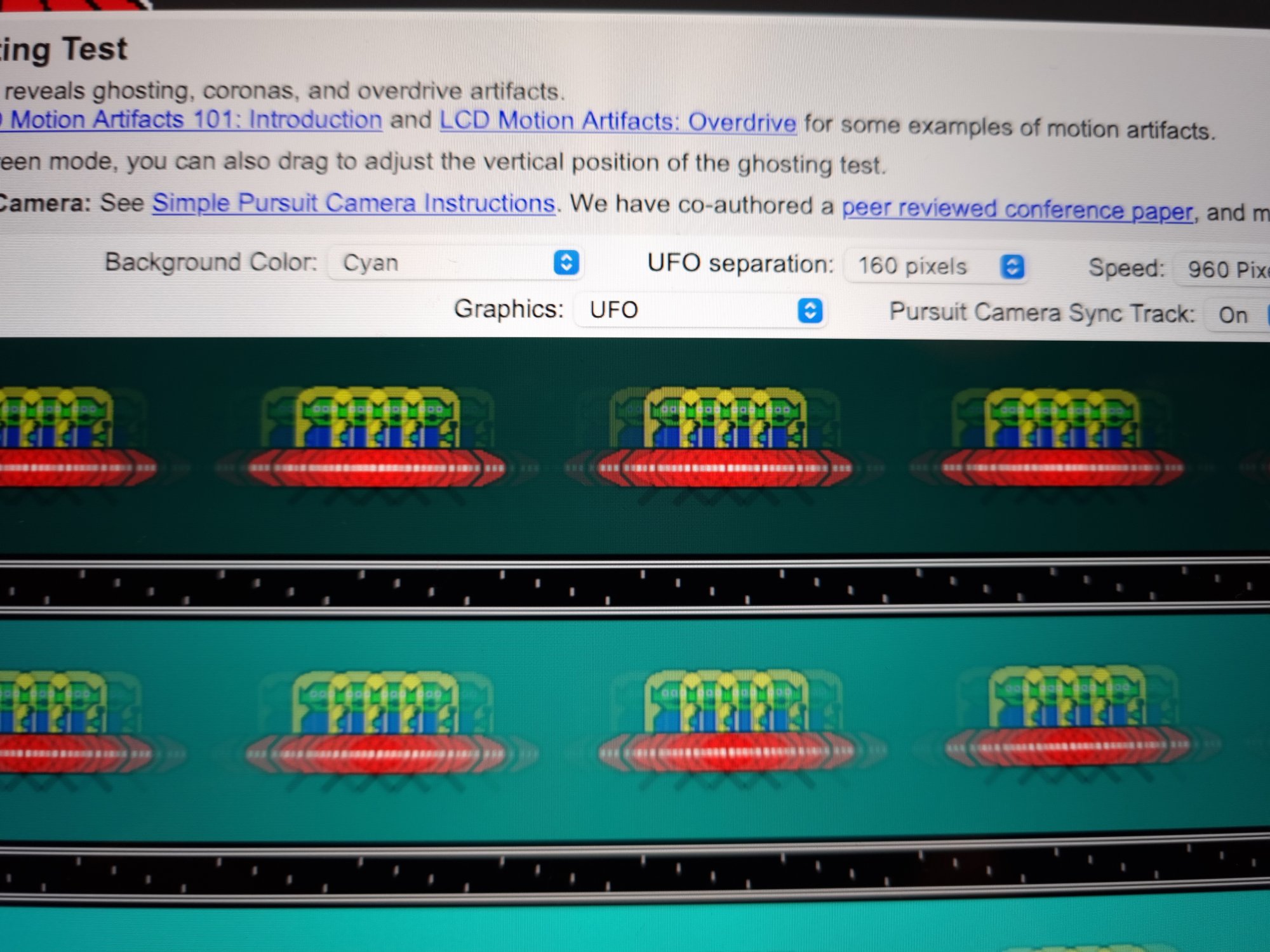

This is from my M1 Air, but keep in mind, the first row there is 60Hz
I think you can compare the first row here with the second row of the M3 Pro, right?
So i would say there is not a big difference.
Yes, and agreed. Looks about the same to me, maybe just slightly slower on the M3 but not by anywhere near as much as you'd think from the NotebookCheck review.

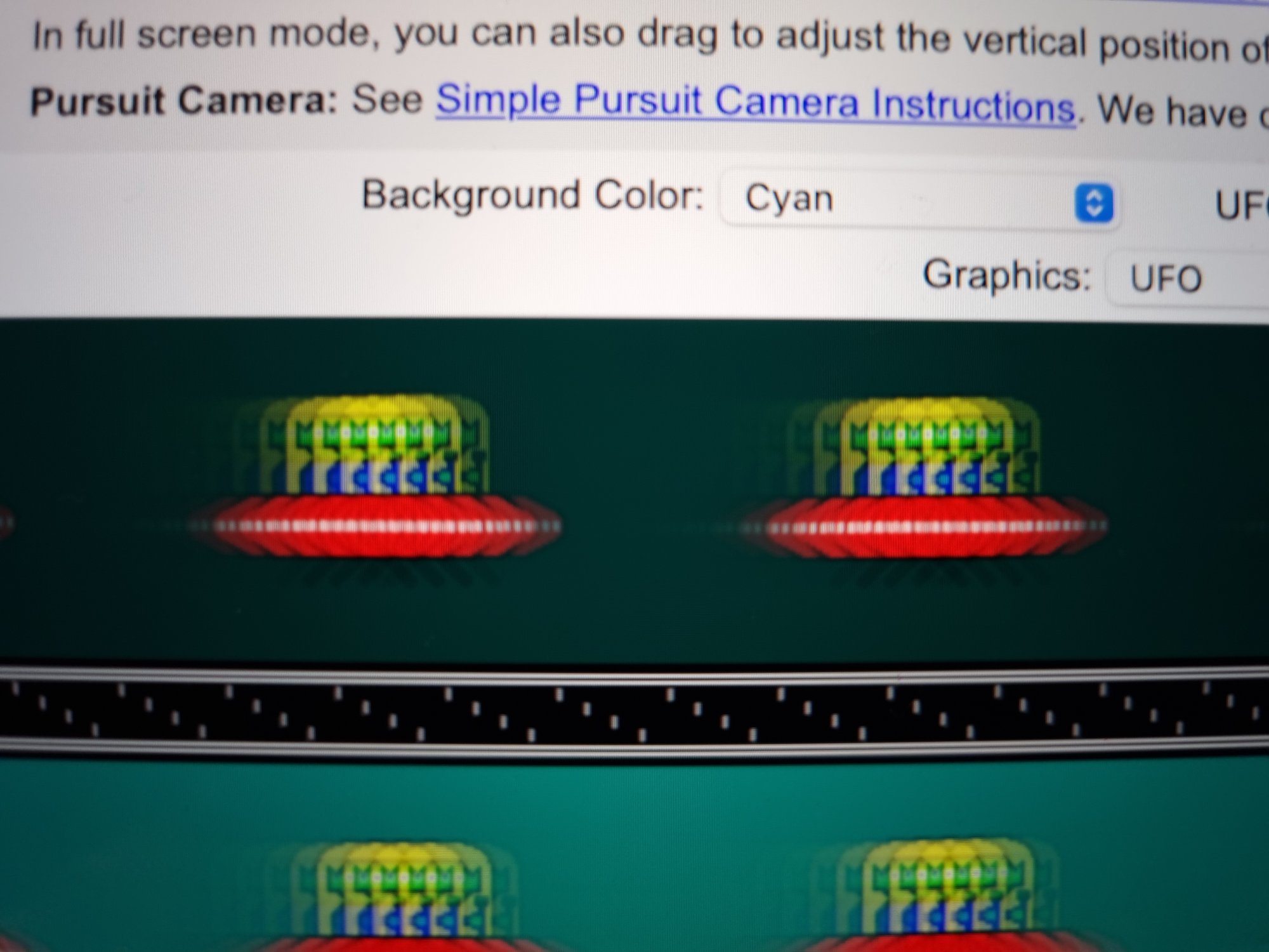

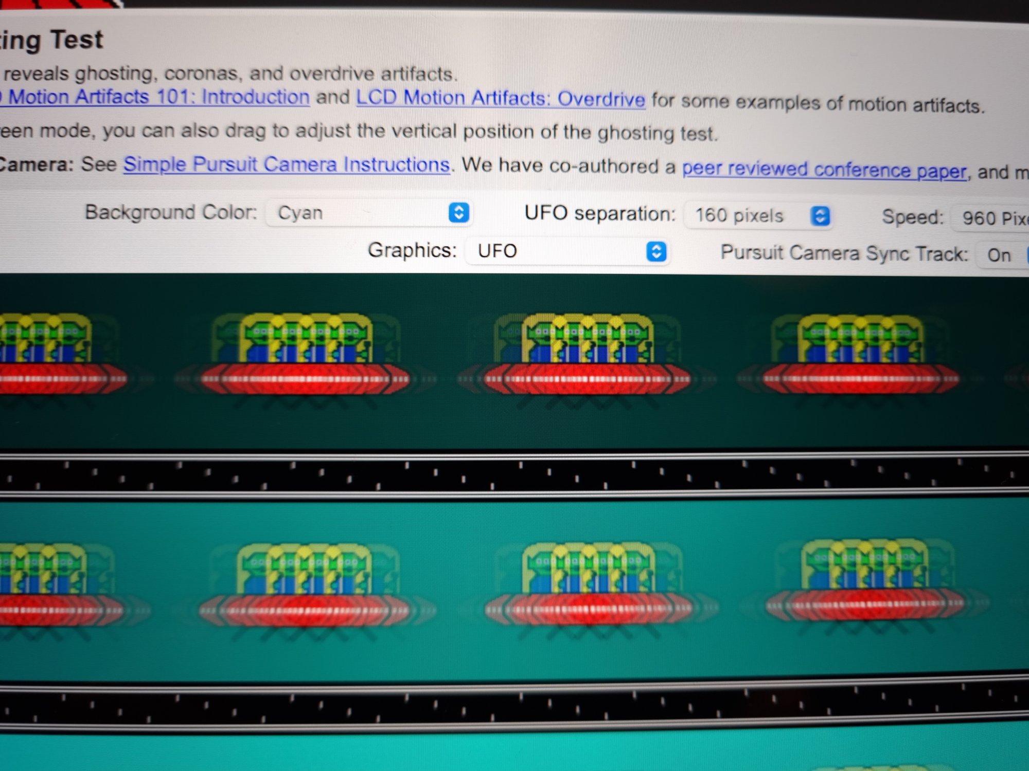

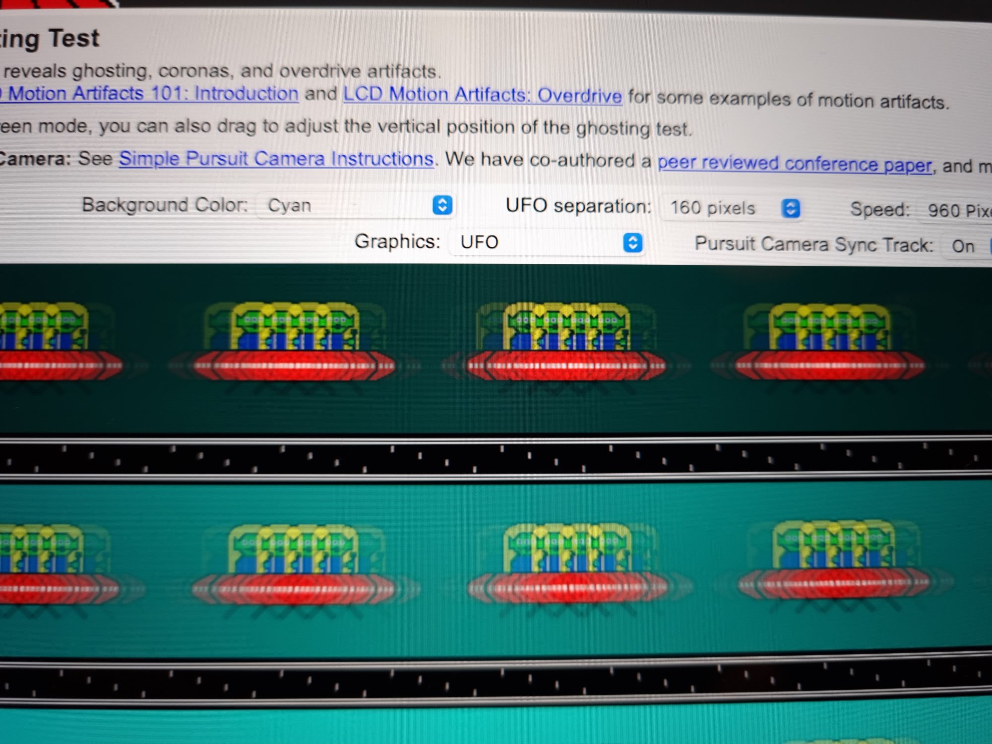

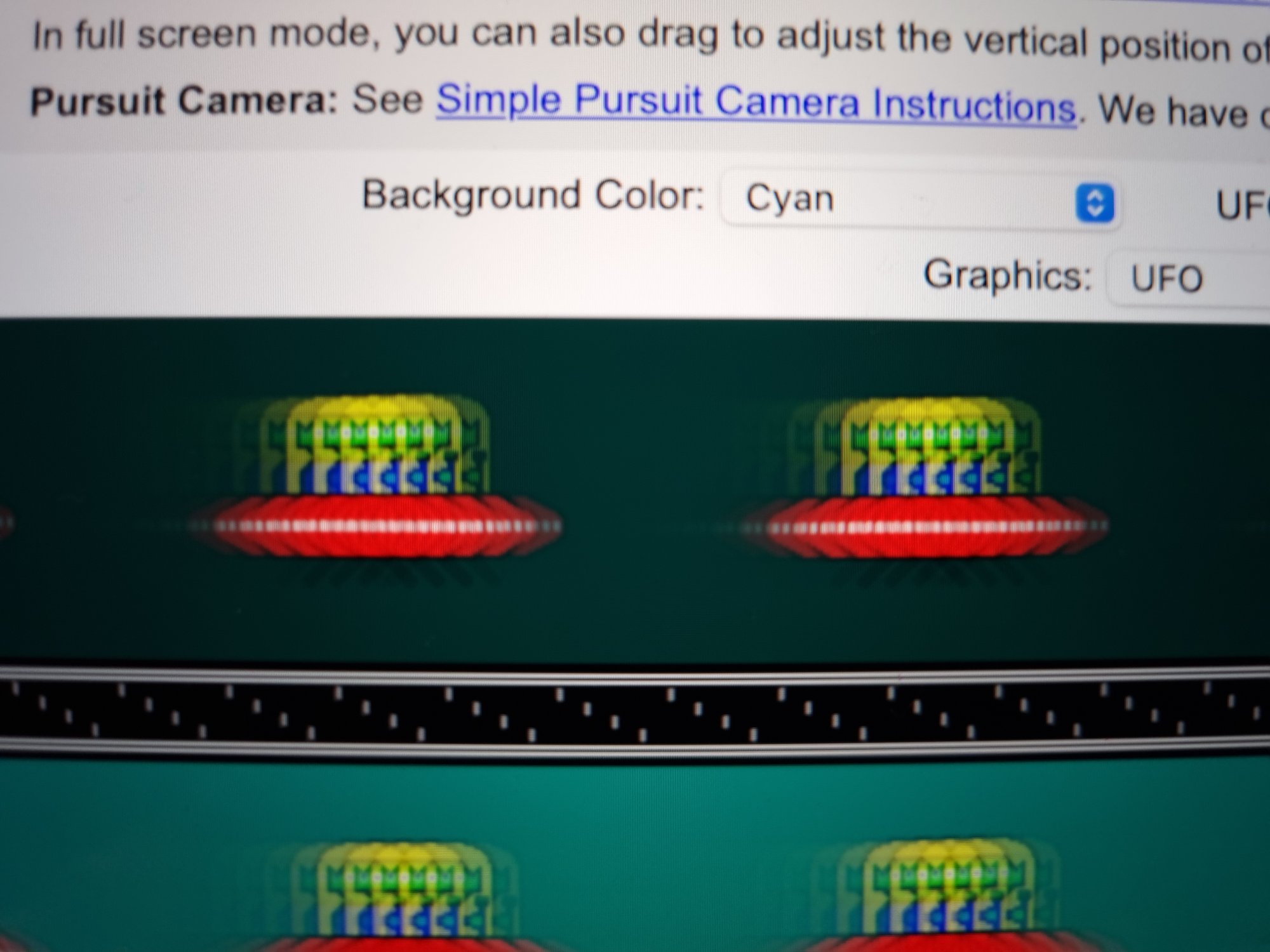

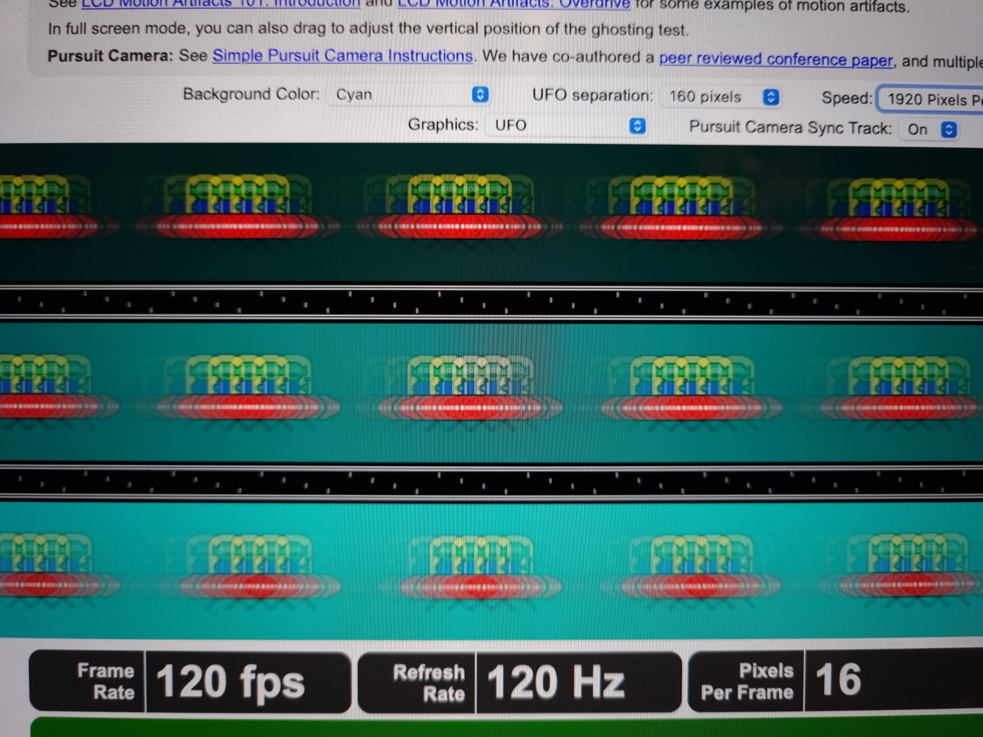

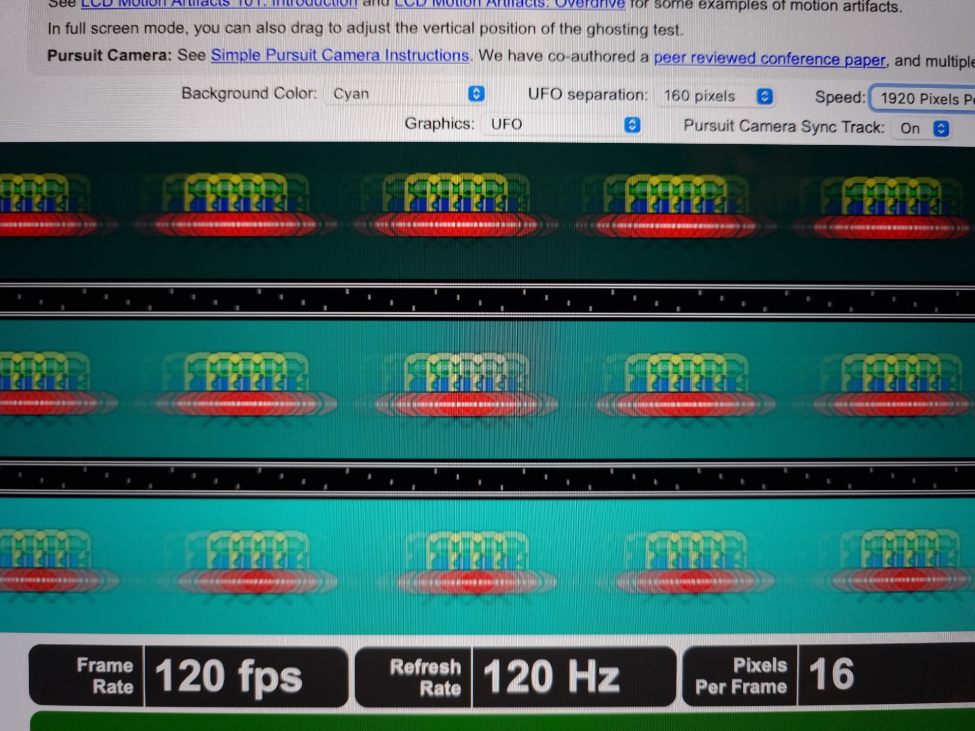

Late to the party but, writing here from a M3 14" MBP (16/512) that I bought last week.
This is my first Apple device, let alone a computer, and I'm currently very satisfied with it. Well of course, except the pixel response times.
Notice that it says, on the website:
"Set the camera exposure to 4 times the length of the monitor refresh. For 120Hz, use a 1/30sec camera exposure."
Which I did on my smartphone and oh dear God:
And another one with 1920 pixels per sec instead of 960 pixels per sec:
I could count around 8 UFOs here, which amounts to 8/120 = 67ms response time. Pretty much in line with what Notebookcheck has said, sadly.
It's a bummer because this machine gives me almost EVERYTHING I could've asked for in a laptop. Would I return it just because of this? No. But I also wonder who the hell at Apple thought this would be OK because it's clearly not for such an expensive device. I don't game on this machine and the smearing is noticeable even in daily use cases as basic as just scrolling text or moving windows around. Switching spaces is even worse because it's horizontal movement rather than vertical movement.
And guess what? It's completely fine when I set the display to 60 Hz instead of ProMotion:
7/60 = 12 ms response time. Pretty much in line with many other displays in the market and in fact it's even better than M2 MBA, which has 25 ms response time:
It REALLY is a bummer.
In the end, I REALLY hope that this is something they can fix with a software update but this is a display panel so... not going to get my hopes up too much.
7/60 is not 12ms, but 117ms.
That's great but this only applies when using a pursuit camera, i.e. when the camera is following the UFOs. Your exposures have a fixed camera position. So the numbers you got greatly exaggerate the response times.
